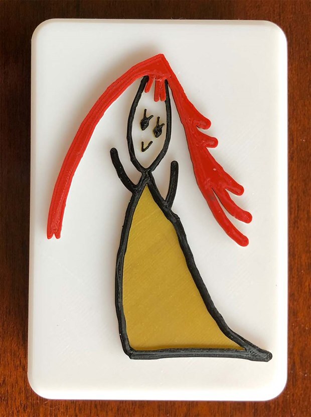

The Ballerina
This is the fun part image.   I knew my granddaughter would want a box like the robot box I gave her brother.  She said she wanted a ballerina and here is her drawing.
I like the free flowing lines and simplicity.
For this print, 4 colors will be used.  Since my printer only has one print head, each color will have its own layer, and subsequent colors laid down on top of it.  The printer can do layer heights of 0.1, 0.2, or 0.3 mm.  A minimum of 2 layers (and maybe more) is needed to get good color.  I elected to use 0.2 mm layer height while printing and 0.6 mm layer thickness for each color, so 3 layers.  The total thickness of the figure is 2.4 mm.
Her pencil sketch was scanned in and outlined in Photoshop and then converted to a SVG file at online-convert.com. I have been using Photoshop due to familiarity but I am familiar enough with Fusion 360 now that I will trying going straight to it next time.  The trick is to simplify the drawings and give adequate thickness to the lines such that the 3D printer can handle it.
The SVG file was pulled into Fusion 360 and the color layers extruded as described above.  The white layer covers the entire print, then the gold layer is on top of it followed by the black layer and the red layer.
When printing, I manually pause the print at each new color layer and change the filament before restarting.  And this is the result.
