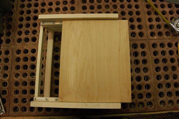

Base and Platform:
I decided that this machine could mostly be built out of wood. My father-in-law owns a cabinet shop, so I just used scrap pieces and built it there. For the base, I wanted to use a box, but the one I found was pretty heavy and bulky and didn't allow for easily adding things to the inside. I decided it would be best to just build my own. My husband actually did most of the construction from my instructions. As you can see from the pictures, the base was formed by mounting two 11"x 4 3/4" boards facing each other on top of boards 3/4" thick. These walls are separated by 11 inches. The whole thing was put together with pin nails and screws.
I found some old drawer rails that I thought I could attach to the platform and the base, but they turned out to be way too long. So I took them apart and discovered these little roller pieces.
I decided I could put them on a block of wood and attached that where I would have put the hinges. The top of that block was up 4 1/2" from the bottom of the base. The platform slid easily across the makeshift rails.
We drilled a 3/4" hole centered longways (5 1/2" from the edge), and 1 1/2" from the bottom on both boards for the rod that will control the platform movement. It turned out to be a little too small, so we sanded it to size.
Then a couple of boards were attached as shelves for the electronics.
I realized later that the platform I had cut was actually too small. It will need to be 11"x15" in order to allow the whole pan to move under both the roller and the cutting head.
