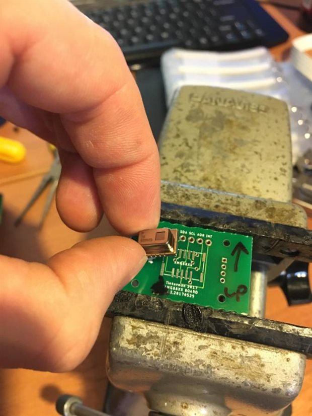

Stretch goal - Actual integration with the Grid Eye
I wasn't expecting to have time to do much more than just take nice pictures; but I was able to do some good integration.
I started with a base GridEye from Adafruit. Back in blog post #3 I mentioned that the base GridEye had a limited sensing range of 20-80 C. A comment noted that a different version of the sensor has a higher sensing range. I was able to get the stand-alone surface-mount sensor from Newark and I found a PCB layout available online to utilize it. I gave myself about a 20-30% chance of this all working. I've never done surface-mount soldering before (although I've been around people who do it quite a bit). I ordered up the PCBs piggy-backed to my other boards back in Blog Post #9.
I cut the boards apart when they arrived and went for it! Essentially what I had to do was prepare the solder pads for the sensor by melting solder on them without the sensor. Once all the pads had solder, I placed the sensor and heated all the pads on one side by running the iron back and forth across them. Once the solder turned molten, the sensor 'sank' down into place. Then I quickly repeated the process on the second side. I did have to slide the sensor around a bit to get correct alignment, and I took it off a few times to try over. I was worried that I may have sank too much heat into the sensor at one point since it got very hot. The datasheet notes exactly how much heat is 'safe' and I may have exceeded it in my rush to get this done.
Getting ready to solder the sensor on the board - wish me luck!
Back of the board with SMD resistors and caps. The address bit is the little solder pads bottom center. This board had .1" spacing header and JST 2mm spacing.
I threw a header on the PCB and the rest of the little 0805 resistors and caps and crossed my fingers. The first power up didn't work and I realized I had crimped one wire on the jacket missing the copper core. I eventually got it to respond and I could see it on the I2C bus; but the Adafruit library was failing to pull images from it. After some further investigation, I realized that the library must not have been able to talk properly since the new GridEye was addressed 0x68 instead of 0x69 which the Adafruit comes with. I switched the solder pads to the other address and viola! Images!
I then just updated my Air Baffle mount for the new hole pattern and went ahead with integration.
