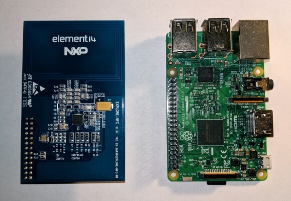

The Pi Chef challenger’s kit came with the Explore NFC Board, which is made for Raspberry Pi. The board plugs right into the GPIO header and uses SPI to communicate. The supporting documentation is good, and element14 links to the related downloads and instructions, so it seemed like I could easily incorporate this board into my project as a nice add-on feature. The board also came with a credit-card-sized NFC tag called NTag, which can store just under a kilobyte of data.
Figure 1. Explore NFC Board next to a Raspberry Pi.
The main chip on the Explore NFC board is the PN512 by NXP. This chip is apparently one of the most popular NFC devices used in transportation systems and other contactless, “tap your card here” technology. According to the schematic of the board, it is basically a breakout for the PN512 that includes an optimized antenna and some convenient configuration wiring.
Looking at the board and schematic, I noticed that it is hard-wired to support SPI instead of I2C. The board has some zero-ohm surface-mount resistors that function as semi-permanent switches. If you want to use I2C to communicate with the PN512, you have to de-solder these tiny resistors and re-solder them in other locations. This was a step I wasn’t willing to take, since it was potentially destructive, and I didn’t want to ruin the only board I had, so I would have to use SPI.

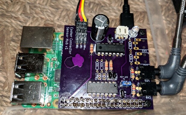

Conflicts with my Sensor Hub PCB
Unfortunately, the NFC board uses the same Raspberry Pi pin as my Sensor Hub PCB for its SPI “Chip Select” signal, so the two boards would interfere with each other if they were both connected at the same time. This was an oversight I made when designing my PCB. It turns out that I made another mistake in my PCB design that prevents me from attaching another board on top of it: even though I added header pins that would allow another board to stack on top of the GPIO pins, I forgot that the servo would also plug in to the top, so the servo wires would be in the way of the above board. I also stuck a giant capacitor on the top of my board, which would be in the way as well.
Figure 2. Photo of my Sensor Hub PCB with a giant capacitor and servo pins.
Ultimately, I decided that WiFi pairing was a one-time process, and having the two boards stacked together would not be necessary in the long run. Instead, I would mount only the NFC board, transfer the WiFi credentials, and then swap it out with my Sensor Hub PCB.

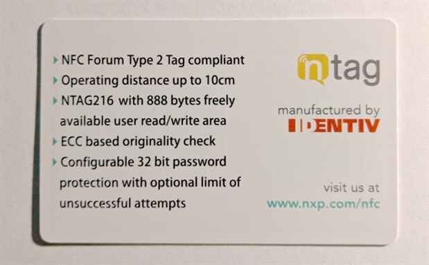

Figure 3. NTag card that came with the Explore NFC board.
I found the full user manuals for the PN512 and the NTag, which seemed to have all the information I needed to get me up and running. NFC has many protocols and modes, and each of them are designed to be very robust at scale. I learned that the NTag card uses the MiFare (also known as ISO 14443A) protocol to communicate. This is what I needed to implement.

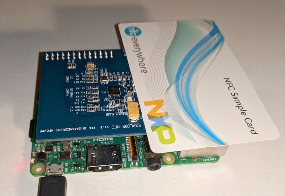

Feeling pretty confident at this point, I continued on to the next logical step, which was using the PN512 to get the text data from the NTag using this MiFare communication protocol. I used the helper methods I had written earlier to set up the PN512 in MiFare mode as a communication initiator. I then placed the NTag card on the antenna of the Explore NFC board, and ran my code, expecting it to send a Wakeup command to the NTag and receive a response.
Figure 4. Placing the NTag near the Explore NFC antenna.
Nothing happened. I read the related error registers from the PN512, and they seemed to indicate that the device was not transmitting or receiving any data. I looked back at the documentation, scouring it for any details I may have missed. I found one clue in the “Status2” register: the modem was stuck in a state called “TxWait”, which meant that it was it was waiting for the RF field to be present before actually transmitting. The way I am using NFC, the PN512 is supposed to produce a high-frequency RF field, which the tag picks up and uses to power itself. Information can be encoded in this high-frequency wave in both directions, which is how NFC devices communicate with each other.
Knowing that this RF field was not present meant that I needed to tell the PN512 to generate it. This led me to the “TxControl” register, which had a bunch of configuration options for the antenna. The documentation didn’t clearly explain when and how to use each of these options, so I didn’t feel confident that I was doing it right. I experimented with a few different ways to enable the RF field, and it seemed to solve the problem of being stuck in TxWait forever.
The modem was now progressing through the transmit state seemingly correctly, but it was now getting stuck in the “Wait for data” state. This indicated that the response from the NTag was missing. This could mean one of several things: A, the Wakeup command I was transmitting was wrong; B, the NTag was ignoring the command; C, the NTag received the command but didn’t send a response; D, the NTag sent a response but the PN512 didn’t receive it; or E, the PN512 received the response but didn’t understand it.
