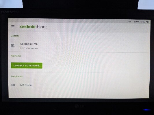

Once Android Things is running, you can’t really do anything with your Pi, unlike Raspbian. If you plug in a monitor, there isn’t a desktop or even a command-line interface, and there's no SSH or VNC service to access remotely. You will only have access to a status screen that displays some information about the device. If you plug in a keyboard, you can navigate around and connect to WiFi here too. Once you install an app, this screen will be replaced with your UI, if you choose to have one. What you do have is a fully-functional Android device in debug mode, so you can connect it to Android Studio. There’s also the traditional Android Debug Bridge (ADB) shell, but, like on all Android devices, it is not really a full shell, and it doesn’t give you much access to anything besides debugging tools. From within Android Studio, you can install apps, view the logs, and explore the filesystem.
Figure 2. The Android Things status page.

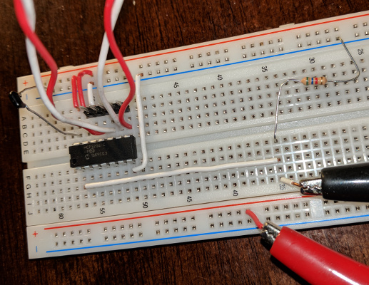

For my project, the Raspberry Pi will be getting temperature data from my thermistor probes via an ADC. The ADC I purchased supports the SPI serial protocol, so I connected it up to the Raspberry Pi’s SPI pins using a breadboard and some jumper wires according to the Android Things documentation.
The next step was to connect the thermistor probes to the input of the ADC. I plugged the Tip/Sleeve connector of my probe into the matching jack I purchased. Unfortunately, the pin layout of the jack isn’t on a 100-mil grid, so it doesn’t fit on my breadboard. Eventually I’ll have a custom PCB made that will have holes in the right places, but for now I’m just attaching alligator clips to the leads and clipping the other ends to wires sticking out of my breadboard. Now that the thermistor is connected to my breadboard, I need to build the voltage divider that I designed in my last post (Thermistor Calibration), and hook it all up.
Breadboard with ADC connected to voltage divider and Raspberry Pi
Figure 3. Breadboard with ADC connected to voltage divider and Raspberry Pi.

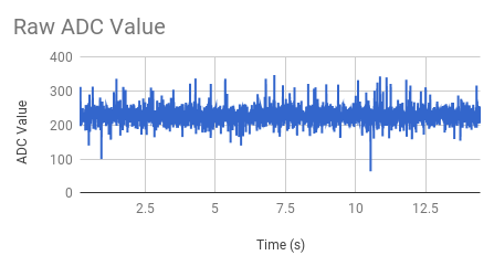

My test app prints the elapsed real time since the app was launched and the ADC value to the Android logs. I pasted this output into a spreadsheet and graphed the result. As you can see in Figure 4 below, the output is extremely noisy, swinging between about 220 and 260. This result is unacceptable, since the temperature is clearly not going up and down as indicated. I’m not exactly sure why there is so much noise in the reading. I expect it has to do with the fact that I’m not buffering my input like the ADC documentation suggests. Also, this prototype is built on a breadboard, and they are infamous for introducing noise due to crosstalk from the nearby, high-frequency digital SPI signals.
Figure 4. Graph of raw ADC value over time.

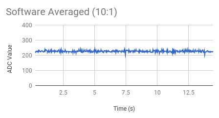

My first thought was to apply a low-pass filter in software, averaging many noisy points into a smoother result. Figure 5 shows the result of doing this, where each point is averaged with the last 9 points. It is clearly improved, but it still has some spikes where there shouldn’t be. I'm happy with this result for now, but later I’ll want to reduce this noise even further using more hardware.
Figure 5. Graph of ADC values averaged in software with the last 9 values

    DAB over 8 years ago +2
    Nice update. I think you will find that averaging four samples is your most efficient in that it reduces noise by 75%. In the old days we did an sum and then shift two bits and we were done. Doing a ten…
    Nice update.
    Doing a ten sample average takes you to 90% noise reduction, so you only get an additional 15%.
