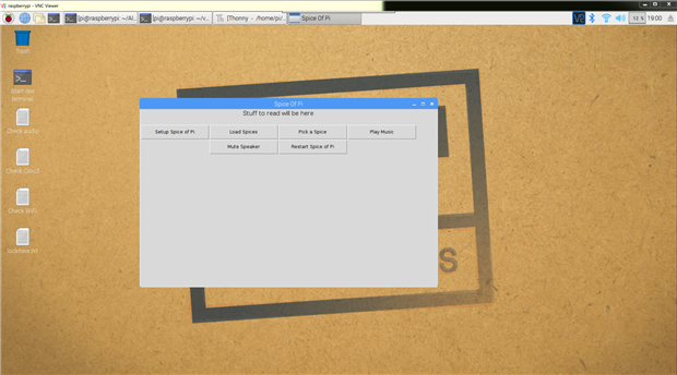

So in the 2ish weeks since my last update I have been on and off again playing with the Google assistant.  I have also started coding the Python code and gui.  I was hoping to find an IDE for Python that mimics the drag and drop creation of the GUI elements like the older versions of Visual Basic.  Unfortunately, the ones that I liked wouldn't compile properly on the PI ( https://github.com/dddomodossola/remi ).  I ended up through many clicks and searches finding the following Python library which seemed somewhat close to what I wanted to do: https://lawsie.github.io/guizero/ .  It also seemed fairly easy to use even if it wasn't drag and drop.  I also found a way to control the alsa mixer volume via this link: https://www.raspberrypi.org/forums/viewtopic.php?t=191916 .
So, off I went like a herd of turtles laying out the buttons and textboxes.  The following is what the GUI code looked like:
GUI Code
from guizero import App,Box,Text, PushButton

And this is what it actually looked like on my Pi:

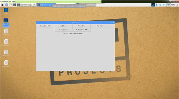

Nice, but not what I had envisioned.  For the life of me, I could not get the text box to be displayed at the bottom of the window.  You will notice, that the 'box' I had placed the text display  into was supposed to be the 8th row, with empty space between it and the rest of the buttons, because the grid= section is supposedly x and y coordinates.  So, I thought that I would move the text box to the top of the window and go from there:
More code

Ah, much better.  Or so I thought....

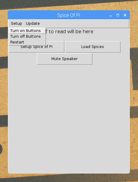

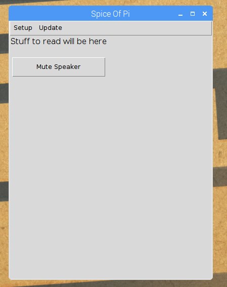

My next order of business was to be able to hide the buttons so that the user would talk to the Pi instead of using the screen buttons.  No problem, because the library had a way to hide and show the boxes and by hiding the boxes, the elements in those boxes would be hidden as well.  Perfect...
Sigh, apparently turning on and off the boxes changes the layout quite significantly and this is definitely not quite the layout I was hoping for...
Even more code

My first thought was that this was a stupid wonderful feature, and I should be rejoicing greatly because everyone loves hunting on the screen for the button that they want to press.  But I was not.  I was not indeed.  So back to the Google searching I went to see if I could really find a IDE with a GUI designer.  Again, I could not find anything that seemed to do what I wanted it to do, so I turned off the Pi, opened a bottle of red wine and stopped thinking about the whole project.
Now, don't think that I had given up on this, for I did find a completely different way to interact with the voice kit without using a handcrafted GUI which will be documented in my next post...
