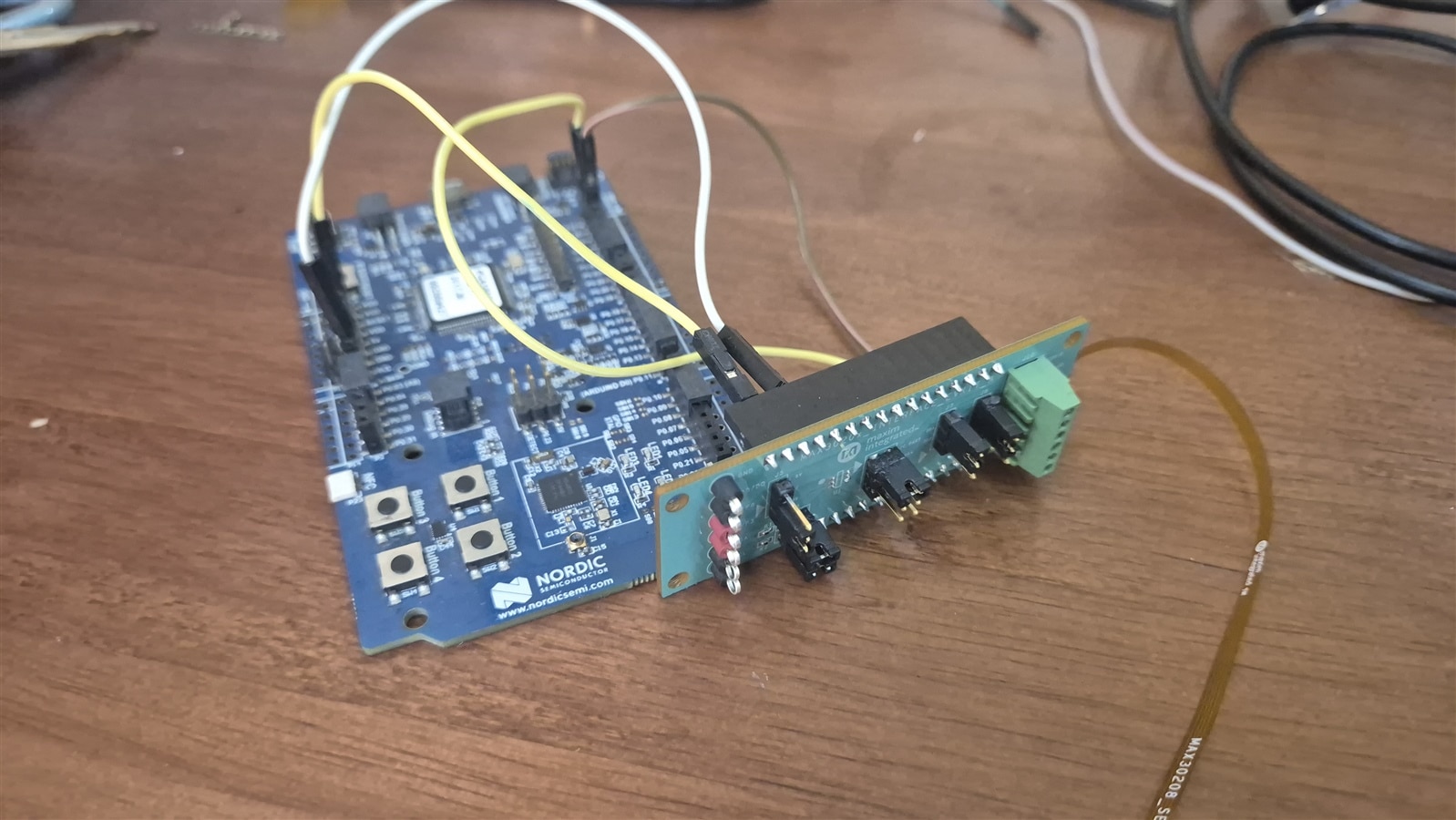

Past few Design challenges were leaning on Analog Devices parts, and was very much interested in getting to know another one. I did get my kit delivered on 18th Sept. Thank you e14Liz  and JoRatcliffe  for the logistical support and for adding the Cap, Stickers and the Badge. Here is an unboxing video instead of an unboxing post. Apologies for bad framing.
Music by MiroMaxMusic from Pixabay

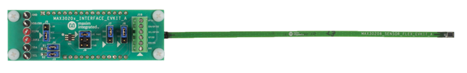

The MAX30208EVSYS dev board
MAX30208EVSYS# the kit contains the interface board along with the MAX32630 Feather board. THe Sensor itself  is on a small flex cable that plugs into a separate interface board rather than as a bare chip on a breakout.

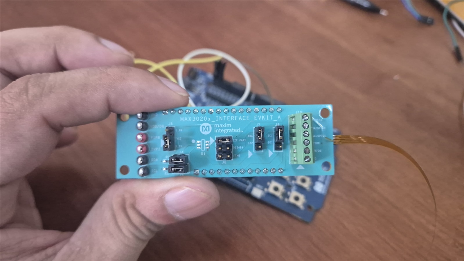

Analog Device's Evaluation boards gives a Developer lot of options but also are not easy to get started and I've seen their documentation being cryptic sometimes. This board has a DS2484, but I can't figure out what it's function is. The Jumpers documentation is not to standard levels for this particular board.
Relevant jumpers:
Jumper Function What I did
J3 / J4 Gate the onboard 4.7kΩ I2C pull-ups Keep Shunted.
J6 Something to do with DS2484 Kept it at I2C Part
J7 / J8 Connects the SDA SCL Pins to the Feather Compatible pins I Shunted I2C lines to IO Lines.
If you are connecting the MCU using the J10 connector then J7/J8 Connector is irrelevant.
The Sad part is that the flex cable itself only breaks out four of the sensor's ten pins to the interface board's header: VDD, GND, SDA, SCL. The MAX30208 is a 10-pin Thin LGA with two extra pins, GPIO0 and GPIO1, that can optionally act as an interrupt output and an external convert-trigger input — neither is wired on this flex, so Temperature can only be polled. Meaning, I can't keep the MCU sleeping until the sensor wakes it up when temperature crosses a limit. Bye Bye Low power programming.

SCL stuck low — chasing a real bus lockup
Once I had this wired up and started testing, I got on of two failures. Sometimes NRF_ERROR_DRV_TWI_ERR_ANACK which means No Acknowledgement and sometimes the whole thing just hung, the blocking TWI call spinning forever inside the SDK's own busy-wait, never returning at all.
Checked the usual Continuity Check, Pullups and the idle Voltage level on bus line. SCL Was stuck at 0.4V. I removed the power and I2C lines and rewired it to my MAX30102 Breakout board, the Sensor was seen in the I2C Scanner. Then using an Logic analyzer I saw that the SCL is clamped low the second, the board received it's power, even well before the I2C transaction starts. So I was sure that this has nothing to do with the I2C helper function which I wrote.
Even with a breakpoint at the start of the firmware with the NRF52 core stopped, the SCL went down. It remained low with only with the power pins attached to the MAX30208EVSYS interface board. I removed the MAX30208 Flex cable, the problem persisted. Now it's clear - The Culprit has to be the DS2484 or the J6 Jumper misconfiguration. I opted to simply removing the DS2484 IC. and et Voila - SDA and SCL lines are high on Idle
DS2482 Removed

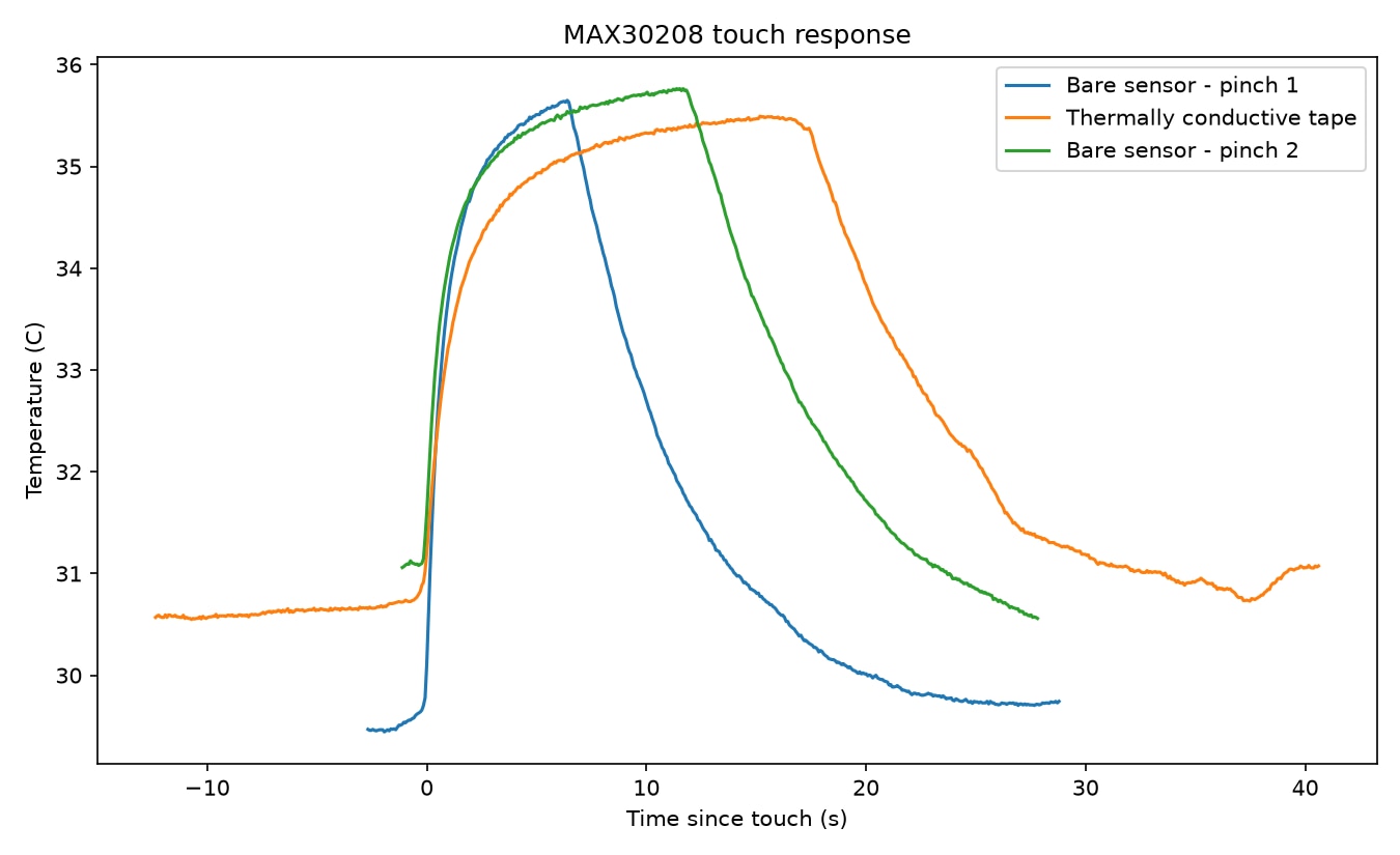

With this fix, I was seeing temperature readings, touching the top part of the sensor by pinching the sensor between two of my fingers, saw the temperature rising.

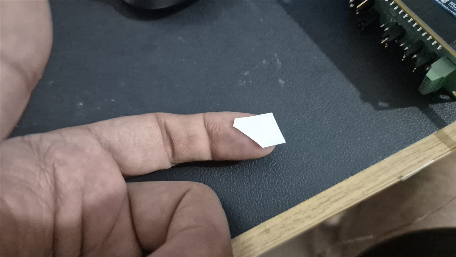

Testing - with and without the thermal tape
To see how the sensor responded with and without the tape, I did three scenarios -
  1. Pinch 1 - Pinch hard
  2. Pinch 2- gentle pinch,
  3. Gentle pinch with adhesive tape in between
In all three cases, I let the temperature climb, stabilize and then removed my fingers and watch it settle back to ambient temperature. I am not going to characterize at an instrumentational level so I took only one readings each.
With Ambient around 29.3°C, the values climbing to 35.5–35.8°C on a finger pinch across all three trials which is quite expected. The difference is response time: with the tape on, it took about 34% longer to reach 90% of the eventual rise, and roughly 2x longer to decay back toward baseline after release. Just as what I said above, the tape adds thermal mass and thus needs time to transfer extra heat to bring the sensor as well the the tape itself to same temperature. The Copper plate once I add will change the numbers further. It is not going to affect our final wearable device as since it is going to be a continuous monitoring device, once worn the sensor will reach equilibrium with skin and and since body temperature will change slower (even in case of fever) than the responsive time of the the wearable, there is no problem.
