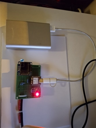

In this post I will present the following implementations:
A. Determination of body hydration using the dielectric profile (using GSR, Tau and Temp);
B. Cardiorespiratory efficiency and tissue perfusion (using HR and SpO2);
C. The body's thermoregulatory response (using Temp + GSR);

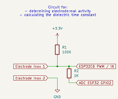

The circuit used to determine the dielectric profile for skin and to show the hydratation indes on the body can be one of the following solutions:
- a simple one with two resistors;
- with a specialized circuit, like AD5933 or MAX30009 (future implementation/upgrade).

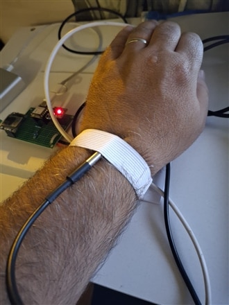

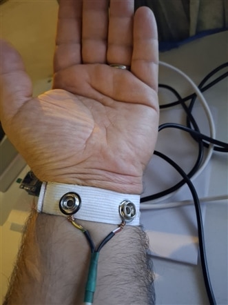

I used first option, with two resistors and two ports from ESP32C6, like in the schematic diagram:
OBS: the circuit used to read the braceled dry electrodes are powered borm an power bank to avoid interferenced induced by the switching power supply and to have a total separation between sensors and PC with Labview.
All the calculation are done in LabView.
Parameter used:
- GSR (Rskin in Kohm) - measure the DC resistance of the skin; It is particularly influenced by surface moisture, perspiration and electrolytes.
- Skin capacity (Cskin) - It reflects the dielectric properties of deep cellular tissue (dermis and living epidermis); It depends directly on the bound and free water within the cells and in the interstitial space.
- Tau (Rskin x Cskin in us) - It measures the response speed to a transient pulse; It measures the rate at which the skin's dielectric capacitance charges and discharges in response to a pulse applied by the ESP32-C6.
The parameters Temp (using DS10B20 one-wire temp sensor with metalic capsule), GSR and Tau (using the bracelet two electrodes) are read by the ESP32C6  (see the photos below) and sent to LabVIEW for processing and display:
image    image    image

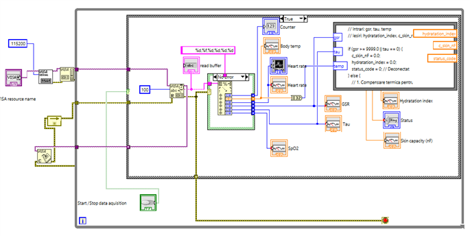

Algorithm: the processing is carried out in four main stages in LabVIEW (within the Formula Node):
Step 1: Thermal Compensation (DS18B20 Sensor)
Skin temperature alters electrical resistance through vasodilation/vasoconstriction. To eliminate temperature-induced errors:
Rcorr = GSR x (1 + alpha x (Tmasurat - 33.0))
(where alpha = 0.02, meaning a 2% correction per degree Celsius relative to the 33.0°C reference).
Step 2: Extraction of Dielectric Capacitance Cskin
By mathematically separating the time constant tau and the corrected resistance Rcorr:
Cskin (nF) = Tau (us) / Rcorr ()
OBS: The actual physical values ​​for the equivalent skin capacitance (Cskin) obtained using dry electrodes on the epidermis fall within the range of 0.2 nF – 5.0 nF (200 pF – 5000 pF),
depending on the hydration state, electrode surface area, and contact pressure.
Step 3: Normalization and Calculation of Hydration Index (0 - 100%)
The obtained value Cskin_nF is linearly scaled between the threshold for very dry skin (Cmin = 0.5 nF) and that for optimal hydration (Cmax = 3.0 nF):
Ih(%) = Clamp x [(Cskin - Cmin) / (Cmax - Cmin) X 100, 0, 100),
where Clamp is a limitation fucntion used to mantined an interval between 0 and 100
Step 4: Safety Mask and Status Classification (status_code)
- Status 0 --> (Disconnected): used for GSR >= 9999 or Tau = 0; braceled/sensors are not in contact with skin;
- Status 1 --> (Dehydrated / Dried): Ih < 30%;
- Status 2 --> (Moderate hydratation): 30% <= Ih < 60%;
- Status 3 --> (Hydrated / Optimal): Ih >= 60%;
- Status 4 --> (Surface perspiration): Detected when Rcorr < 40 kΩ (presence of surface electrolytes, independent of the deep layer).
Status GSR value (Rskin) Skin capacity Cskin Fisiologin interpretation
Dehydrated / Dried  Big (> 200 kΩ) Low (<0.8 nF) Dry stratum corneum, low cellular volume.
Moderate hydratation  Medium (80 - 180 kΩ) Medium (1.0 - 2.2 nF) Optimal dermal/epidermal water balance.
Hydrated / optimal Normal-low (50 - 100kΩ) Big (2.2 - 3.5 nF) Well-hydrated interstitial tissue.
Surface perspiration  Very low (< 40 kΩ) Rapidly Changing Excess electrolytes on the surface (surface perspiration, not cellular hydration).
The function used in Labview for all above calculatiuon is this (in formula node):

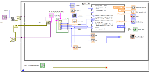

Apnea detection: the algorithm runs inside the Formula Node block in LabVIEW and evaluates the conditions for an episode of obstructive or central sleep apnea.
The algorithm and Labview implementation:
// Intrari: gsr, tau, temp, pi, spo2
// Iesiri: hydratation_index, c_skin_nF, status_code, low_perfusion, cardio_status, apnea_alert

// 4. ALGORITM ALERTA APNEE ÎN SOMN
// Scadere SpO2 <= 92% corelata cu micro-trezire (HR >= 85 BPM)
int apnea_alert;
if (spo2 > 0 && spo2 <= 92.0 && hr >= 85.0) {
    apnea_alert = 1; // Alerta apnee / desaturare
} else {
    apnea_alert = 0;
Working mechanism:
- Respiratory pause (Apnea): During the cessation of breathing, blood oxygen levels begin to drop progressively;
- Desaturation (SpO_2 <= 92\%): When the SpO_2 level falls below the critical threshold of 92\%, the body enters a state of mild hypoxia;
- Micro-arousal / Sympathetic stress response (HR >= 85 BPM): The brain detects the lack of oxygen and activates the sympathetic nervous system, triggering a sudden increase in heart rate (compensatory tachycardia) to circulate the remaining oxygenated blood more rapidly;
- Signal validation (SpO_2 > 0): Prevents false alarms from triggering when the sensor is removed from the finger (disconnected state).

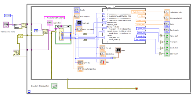

C. Detection of febrile conditions or heat shock.
The Temp + GSR (Body Thermoregulatory Response) module complements the EdgeCare biometric system by adding the component of metabolic and autonomic nervous system (ANS) assessment.
If oximetry (HR, SpO_2, PI) measures cardiorespiratory function, the combination Temperature + GSR monitors heat stress and electrodermal reactivity.
The role of parameters:
a. Peripheral/Skin Temperature (Temp):
- Febrile State / Hyperthermia (Temp > 37.5C): The body tries to eliminate excessive heat through peripheral vasodilatation and sweating.
- Heat Shock / Hypothermia / Vasoconstriction (Temp < 35.0C): The body redirects blood from the periphery to the vital organs (fingers become cold, correlated with a massive drop in PI).
b. Galvanic Skin Response (GSR / Electrodermal Conductance)
- The eccrine sweat glands are innervated exclusively by the sympathetic nervous system.
- In case of intense physical exertion, thermal shock, pain or emotional stress, sweat activity increases instantly.
- Water and minerals in sweat remove skin resistance and increase GSR conductance.
Code for this module (this code will be added in Formula node from Labview):
// Detectie Soc Termic sau Stare Febrila
if (temp > 38.0) {
    fever_alert = 1; // Indicator Febrăa/ Hipertermie
} else if (temp < 35.0 && pi < 0.5) {
    shock_alert = 1; // Indicator Posibil Soc Termic / Hipotermie
} else {
    fever_alert = 0;
    shock_alert = 0;
Demo:
OBS: to simulate fever in "The Body's termoregulatory Response" area I heated the temperature sensor a little above the trigger threshold of the alert.

The front panel in Labview (no video provided, see last note):
