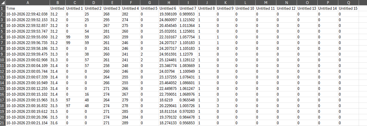

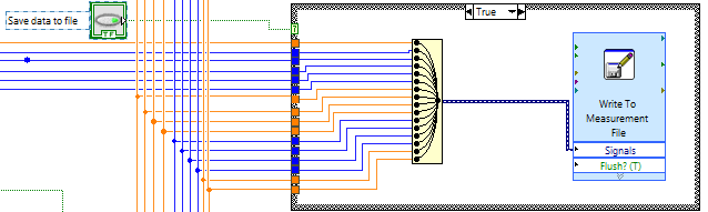

A. Save data from LabView to the PC in excel format
Saving the data is a good thing because they can be analyzed for bebuging, improvment of the system behavior and long time observations.
To achive this I chosen to save data in excel format directly from LabView.
For that I added the "Write to measurement file" block; inside I set the file path were the file will be saved (this is generic and can be modified);
Because i have 16 signals + timestamp, I used "merge signals" block to gather all the signals in one entrance, to be sabed in the excel file.
I added also an button to start/stop the saving data; this button/option is used especially in the development phase:

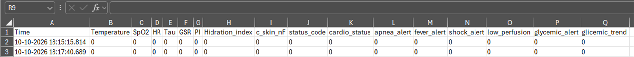

OBS: it is not easy to set the name of the signals saved in the top of each column in LabView; that why I modified the original file with the signal names and then, for analisys, the first from the log file will be replaced with the modified one:
First line modified with the signals name
Saved data in the current log file

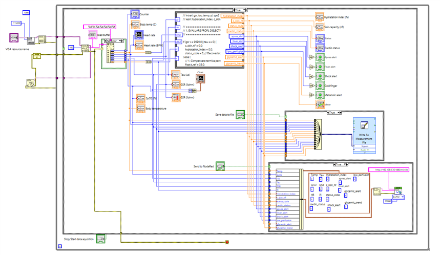

After configuring all the parameters, I thought it would be useful to integrate this system with an smart home environment, to have all these information available in one place.
This "Smart Home" project runs on a Mixtile Edge 2 PC kit—using Debian Linux and a Node-RED environment.

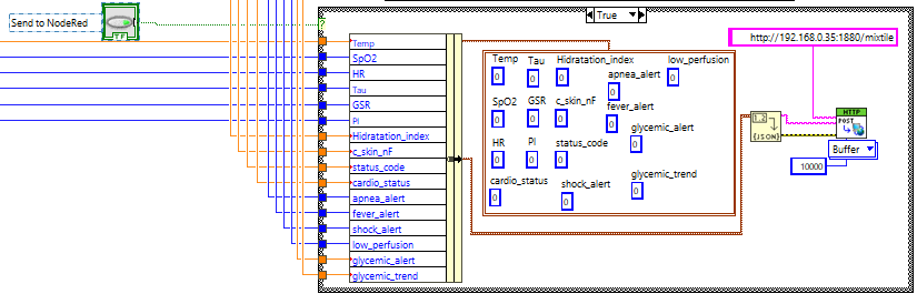

Communication with this PC—and by extension, the smart home/Node-RED system—takes place via the HTTP protocol, as it is much easier to configure in LabVIEW than MQTT.
I added a button in LabVIEW to toggle data transmission to Node-RED; this is useful for debugging and development, but especially for handling situations where Node-RED is shut down (otherwise, LabVIEW would generate a series of communication errors).
Link with my Smart house project: My Smart house project
Here is the communication implementation:

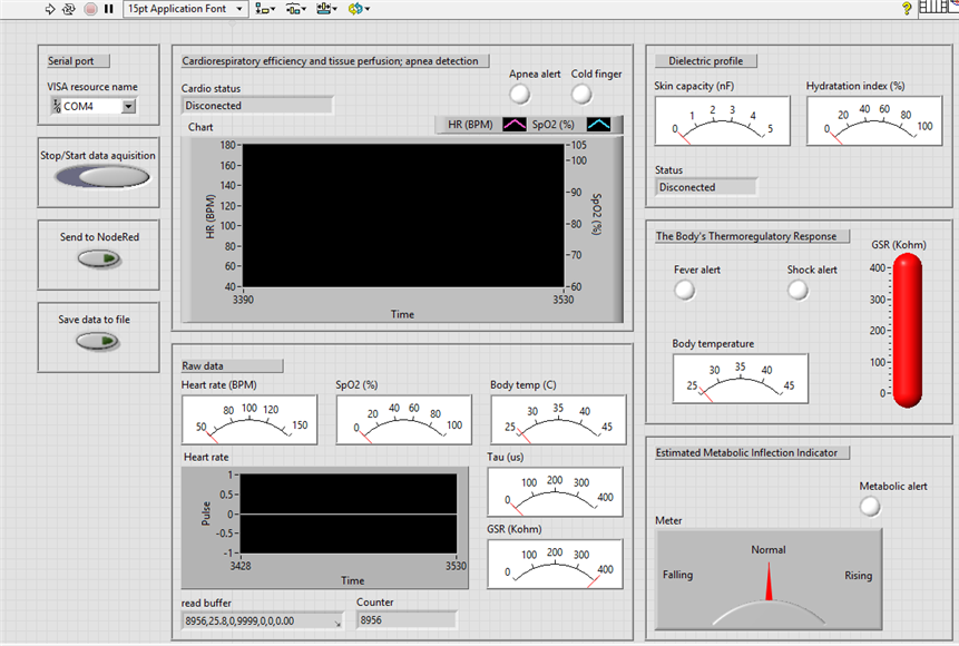

Now, this is the final LabView panel and implementation:
image  image

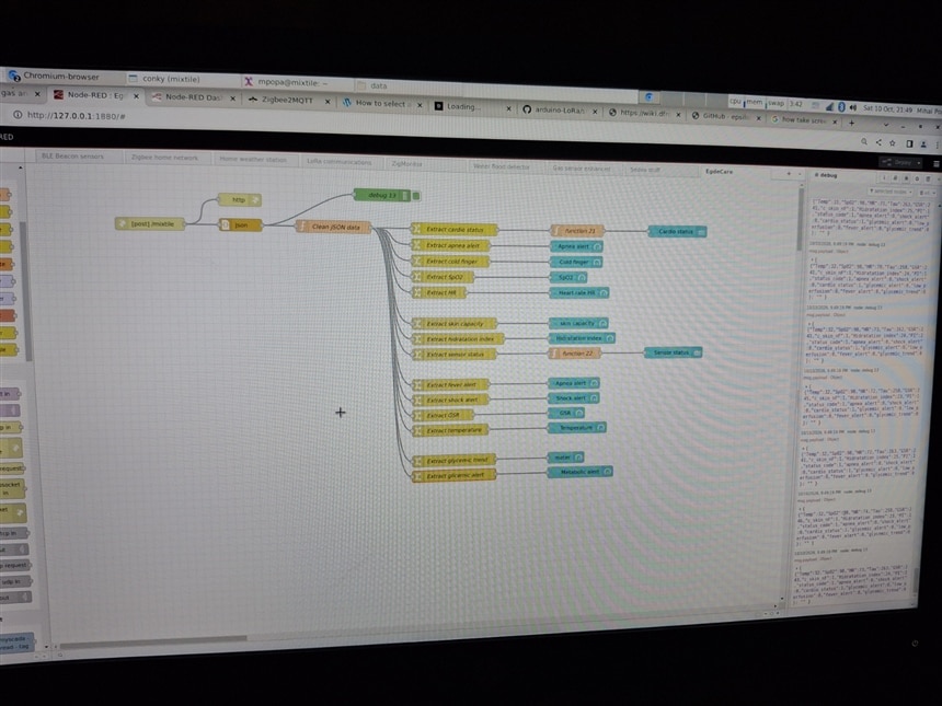

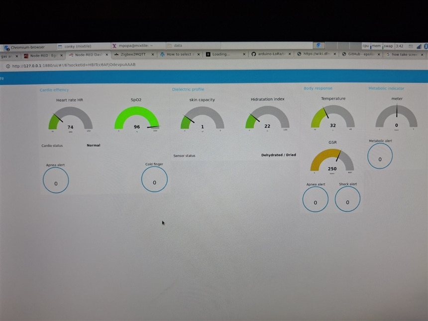

NodeRed implementation and panel:
image   image
The code used in NodeRed will be available in the final project post.
