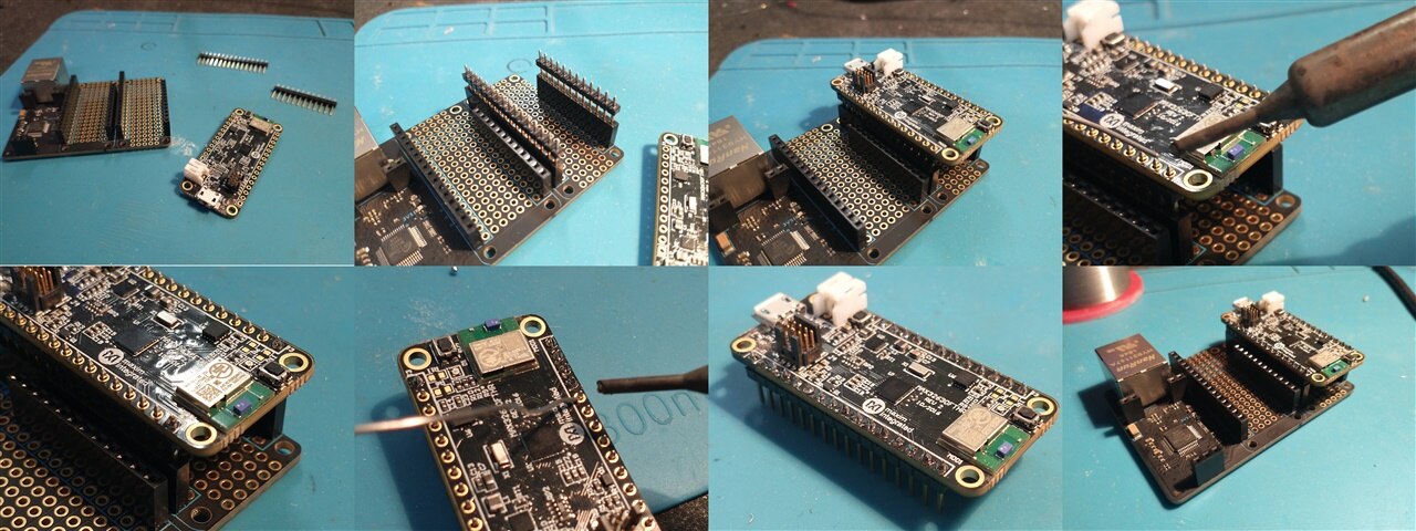

The Hardware
At the heart of the solution is the MAX32630FTHR that has been supplied for the challenge. This has the required BLE capability to scan for my common bluetooth tracker along with other types. It will not work with trackers that use a rotating MAC address, and that excludes the Apple AirTag and the Samsung Galaxy SmartTag, but most low cost Bluetooth key and pet finders should work.
For connectivity to the alarm system I have used the supplied Particle Ethernet Featherwing to talk to the Internet, and a donationware service to link to Amazon Alexa. At first this might seem an odd solution, but there is a good reason for it that I will explain later.

The Build - Accessing the PAN1326B Bluetooth module
Now things start getting interesting. I knew when taking on this project that I was likely going to have to get my hands dirty with some HCI commands, but I did not realise the technical challenges I would need to overcome before I could send these HCI commands to the module.
Most of the issues stemmed from using the Arduino core. There are a lot of things in the Arduino world that are done for you that make using the hardware easier and more accessible, but occasionally they are doing things you do not want to happen and have the opposite effect.
The first challenge is to initialise the UART for communication (including the correct RTS and CTS pin mappings) and enable the 32768Hz oscillator output on P1.7.
Another thing to note from the MAX 32640 errata sheet is that P1.6, that is used to reset the PAN1326B, has unexpected functionality when the oscillator output is used, so our order of operation becomes critical.
In summary this will get you up and running. Remember the order is important.

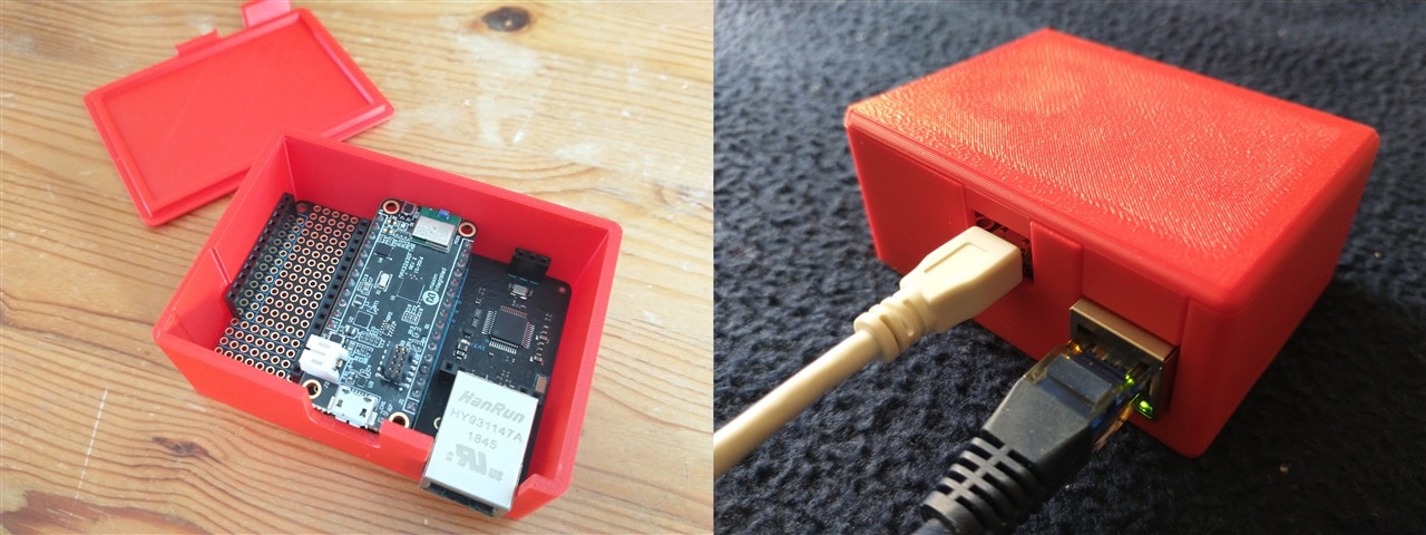

The Build - The Enclosure
While this is a nice little extra I did like designing and printing a special custom enclosure for the hub. For a project where the cleverness is mostly in the software, it feels good to have a nice looking physical element that you can point at.
Here is a video of the prototype design printing. The final design (photographed above) evolved slightly to make assembly easier, to allow a little more room for connectors should we add a second Featherwing for any reasons in the future, and to close some holes we did not need.
The final design can be downloaded from Thingyvirse and if you want to modify it you can access the full model on Onshape.
