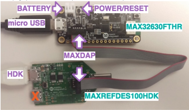

Required Hardware
For all environments, you must use a MAX32625PICO (DAPLink adapter) and a 10-pin ribbon cable to flash code to the MAX32630FTHR.
To prepare the boards for programming follow these steps:
  1. Connect the MAX32625PICO to the MAX32630FTHR board with the fine pitch 10 pin ribbon cable.
  2. Apply power to the MAX32630FTHR board through a micro USB connector.
  3. Connect the MAX32625PICO to a computer through a micro USB connector.

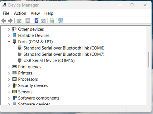

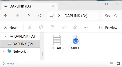

My host PC is running Windows 11. Once the hardware is connected and the MAX32625PICO is plugged into the computer, the system automatically creates a new COM port and mounts the device as a USB drive.
As shown in the Device Manager below, the board is recognized as COM15:
Additionally, the DAPLINK drive appears in the file system. Upon first connection, it contains two default files:

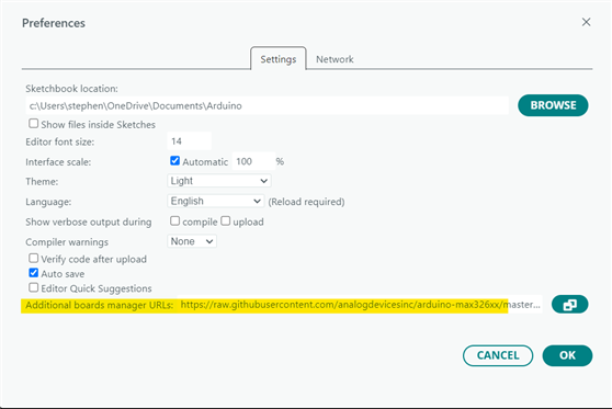

  • Configure:
    1. Open Arduino IDE and go to File > Preferences.
    2. Paste this URL into Additional Boards Manager URLs:
      1. Go to the  preferences screen (File, Preferences) add https://raw.githubusercontent.com/analogdevicesinc/arduino-max326xx/master/package_maxim_index.json to the list of “Additional Boards Manager URLs”.

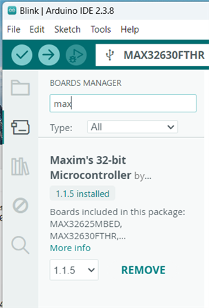

      2. image
    3. Go to Tools > Board > Boards Manager, search for "maxim", and install Maxim's 32-bit Microcontroller.
      1. image

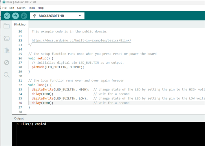

  • Compile & Run Blinky:
    1. Open the example: File > Examples > 01.Basics > Blink.
    2. Connect the board via the MAX32625PICO adapter.
    3. Click the Upload arrow icon.
  • Results:
    • Here is the IDE after the Upload. Success the LED is blinking using the example code.
    • image

    • Mbed serial driver is required.
      • If you are a Windows user and do not already have the mbed serial drivers installed, then you will need to download and install them from  https://os.mbed.com/handbook/Windows-serial-configuration
      • I need to get this since I'm running Windows 11.  But my Chrome browser did not work on the download link, so I needed to use another browser.
      • Now that Mbed serial driver is installed , the device manager shows a different COM port from the initial connection of COM15. The port is now COM16 as shown below.
      • image

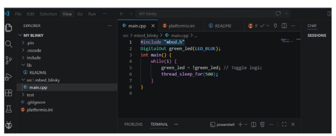

2. Mbed - PlatformIO Extensions (VS Code)
PlatformIO is a professional-grade VS Code Extension that provides a unified development environment capable of handling multiple frameworks—like Arduino and Mbed—seamlessly in one place.
Mbed OS (Legacy) is still supported via PlatformIO as a local framework, which is a lifesaver now that the online compiler is gone. While it's officially End of Life (EOL) and not recommended for new projects, you can still compile and run your code locally. Just select "mbed" as your framework when creating a project in PlatformIO to keep working without those discontinued online services.
    • Download & Install:
      1. Install Visual Studio Code.
      2. Open VS Code, click the Extensions icon, search for "PlatformIO IDE", and click Install.
    • Configure:
      1. Click the PlatformIO (Ant) icon and select + New Project.
      2. Name your project and search for a board: "Maxim MAX32630FTHR".
      3. Mbed as the framework.
      1. Replace the contents of src/main.cpp with the blinky code. Add this Mbed code from the above section "2. The Mbed Way (Object-Oriented)".
#include "mbed.h"
DigitalOut green_led(LED_BLUE);
int main() {
    while(1) {
        green_led = !green_led; // Toggle logic
        thread_sleep_for(500);
    1. Connect your board via the DAPLink adapter.
    2. Click the Checkmark (Build) and then the Right Arrow (Upload) on the bottom status bar.
  • Result
    • LED is blinking GREEN now.
