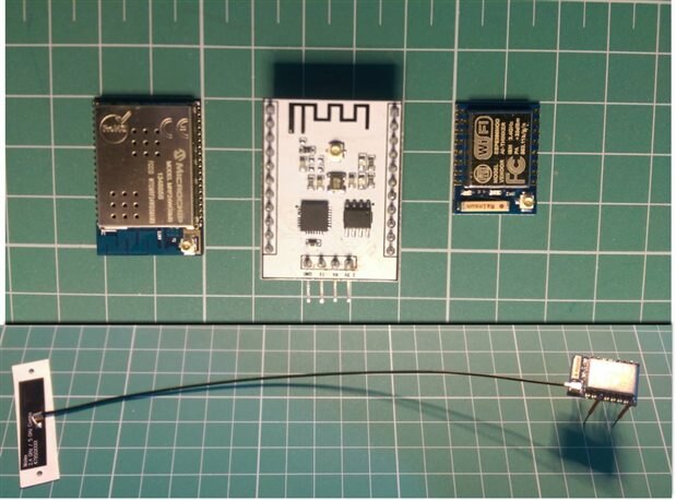

ESP-07 variant looks like this (right and bottom modules):
Figure 1. ESP8266 ESP-07 - The first module on the right side along with ESP-201 variant (middle) and Microchip's module (left)
At the bottom is ESP-07 with antenna attached and extension wires soldered.

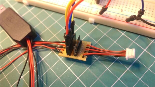

My USB<->Serial came with a small connector to fit the small OSD board size so I soldered 2.54mm male and female headers in the middle of the cable so I can use it for other projects, not only for OSD module.
Figure 2. Prolific USB <-> Serial with additional 2.54mm connectors

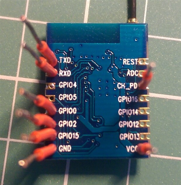

Figure 3. ESP8266 ESP-07 pinout (bottom view)

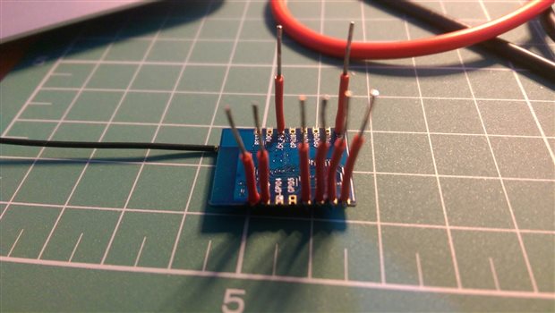

I soldered some expansion wires to be able to use the module on a breadboard (I think that original pads pitch is 2mm). I only extended the required pins, others are unpopulated:
Figure 4. Expansion wires soldered

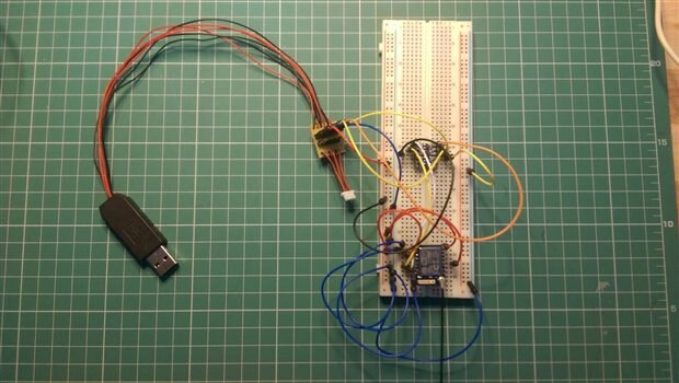

Some people say that ESP8266 can handle 5V on Tx/Rx but I wanted to play safe so I used a level converter (in the middle of my breadboard).
Figure 5. Breadboard setup

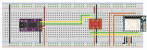

Figure 6. Fritzing drawing, manually modified to include ESP8266 (orange wire is 3.3V and red is 5V — disregard the CTS label on FTDI board, I used that board just as an illustration)

One important note is that GPIO0 must be grounded during firmware flashing. After the flashing completes, GPIO0 pin should be disconnected to allow normal boot (otherwise it would boot into bootloader again).
Additionally, GPIO15 must be connected to ground lead all the time. CH_PD and GPIO02 must be pulled up to 3.3V. Module RX connects to USB<->Serial TX and vice versa.
