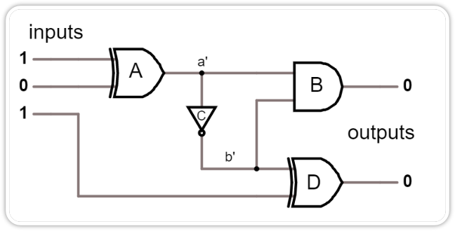

Structural HDL requires you to describe the logical circuit, this also includes defining interconnection between each stage in the logic circuit. In other words, you must define the structure of the circuit.
Example-for-structural
For example, If we want to create the circuit above, we must define the 3 inputs and 2 outputs, and then separately define each gate connected by wires. We can observe that a' connects gate A to gates C and B, similarly b' connects the output of C to B and D, these "lines" or "nodes" must be defined in HDL as wires.
From this example it is easy to understand why the structural model of HDL alone becomes quite complex, and therefore requires alot of planning in order to execute properly. Tracing issues may also be time consuming.
However, When it comes to describing a logic circuit directly from its structure then structural is chosen. Nonetheless scaling of a design is much more difficult and requires multiple levels of abstraction in order to tame its complexity.

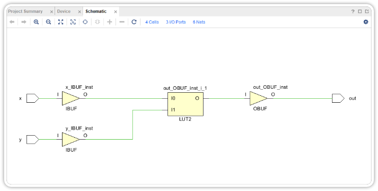

  12. now comes the time to synthesize and finalize the design, we do this by click on the Run synthesis option in the Flow Navigator (It may ask you to allocate number of threads which varies depending on your CPU).
  13. Once successful, you can open the schematic under the synthesis column to view the schematic in all its glory.Schematic-view
  14. next run implementation by clicking on the Run implementation option in the same Flow Navigator.
  15. you may now view the circuit in the device floorplan, or even check the BGA IO of the FPGA itself!Note: In the device floorplan you may notice the active part of the FPGA fabric being used highlighted in light blue
  16. If all goes well and there aren't any errors then we can move to the penultimate step, that is to generate a bitstream. As told earlier this is the file that will be written to the FPGA. Click on the Generate Bitstream option in the Flow Navigator
  17. Now you can connect the the CMOD S7 to the computer and under PROGRAM DEBUG inside the Open Hardware Manager dropdown click on Open Target > Autoconnect.
  18. Once connected, next click on Program Device and select the board.Program-device-option
  19. And there ya go! your FPGA AND gate is complete.AND-demo

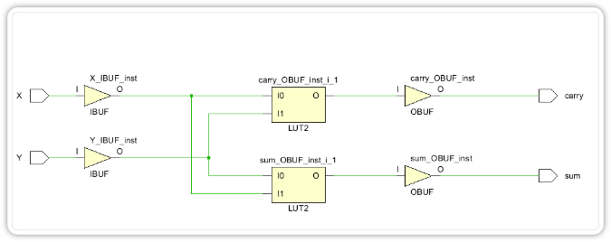

And that's it! now just map the required pins that is the 2 onboard LEDs and the 2 buttons - synthesize implement and generate the bitstream. Let's write the bitstream to the device.
Half-adder-demo
And the schematic for the same looks something like this:
Half-adder-schematic
Notice the use of two LUTs, one for the AND gate and the other for the XOR gate. You can check the truth table of these LUTs by simply selecting one of them and viewing the truth table section under the Cell Properties within the Main zone.

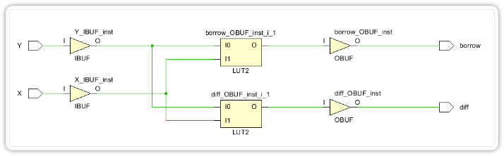

Finally to demonstrate the use of internal wires between the primitive gates, I made a half subtractor. The half subtractor has a similar circuit to the half adder accept one of the input gets negated before the AND gate. Here is the logic circuit and the accompanying truth table:
Half-subtractor-table
Half-subtractor-circuitAs mentioned earlier the circuit has a intermediate stage where the NOT gate comes in between one of the input and the AND gate, What to I do here? How do I map the pins? Well first of all ... Simmer down. We must create an internal wire connecting the NOT output to the input of the AND gate. Remember wires are a type in verilog that can be connected to unlimited inputs but have only one output, this is so that multiple signals don't converge on the same spot. Let's take a look at the verilog module shall we:
module half_subtractor (input X, Y, output diff, borrow);
    wire inter; // this is a wire
    xor(diff, X, Y);
    not (inter, X); // make the wire be the output of the NOT gate
    and(borrow, inter, Y); // make the wire be the input of the AND gate
endmodule
Let's update the constraints file to include diff and borrow and generate the bitstream. This is the resulting schematic and demo:
Half-subtractor-schematic
Half-subtractor-demo
Notice the indifference between the half adder and half subtractor schematic, they both still use the same number of LUTs and pretty route the same way. However, if you check the truth table for the borrow line, you will see that the truth table has changed to accomodate the NOT gate.
