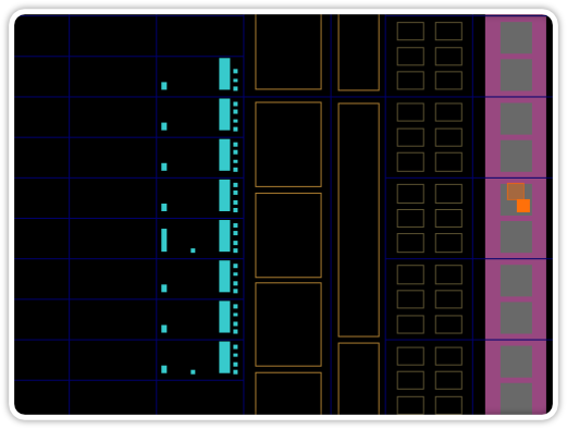

As you can see its working, so let's finalize the design by synthesizing the top module.
BUT before all of that, we must configure the XDC constraints file by routing the input clock to the external clock and the output clock to one of the onboard LEDs.
This shows the block diagram from the top module, we can reveal the wrapper block internals by double clicking on it or clicking on the '+' button.
Obviously, the 32 bit counter comes with a price, of propagation delays, complexity and space usage, but as an introduction to clock dividers it qualifies as gateway for beginners.
Finally after Synthesizing, Implementing, Generating Bitstream and programming the FPGA we obtain this boring show . Unamused
