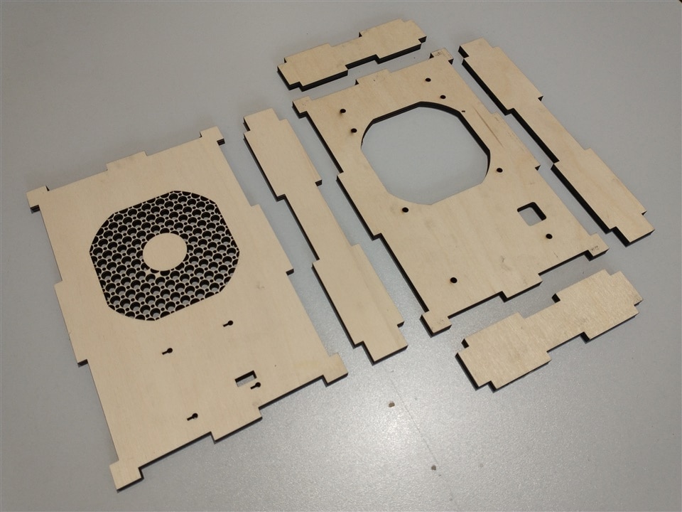

The Main Enclosure
For the main body of the Cool Wave unit I decided to use some plywood offcuts that I could laser cut and the glue into an appropriate enclosure. My intention is to paint the cover and use silicone sealant to remove any leaks, but I will do this after I have tested the design and have the code debugged.

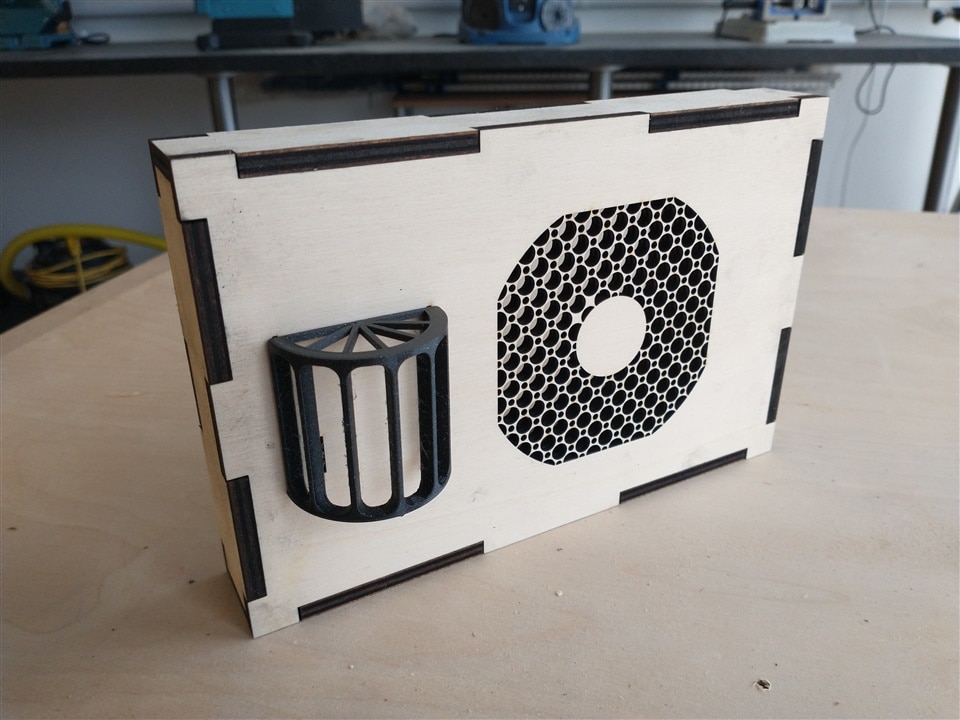

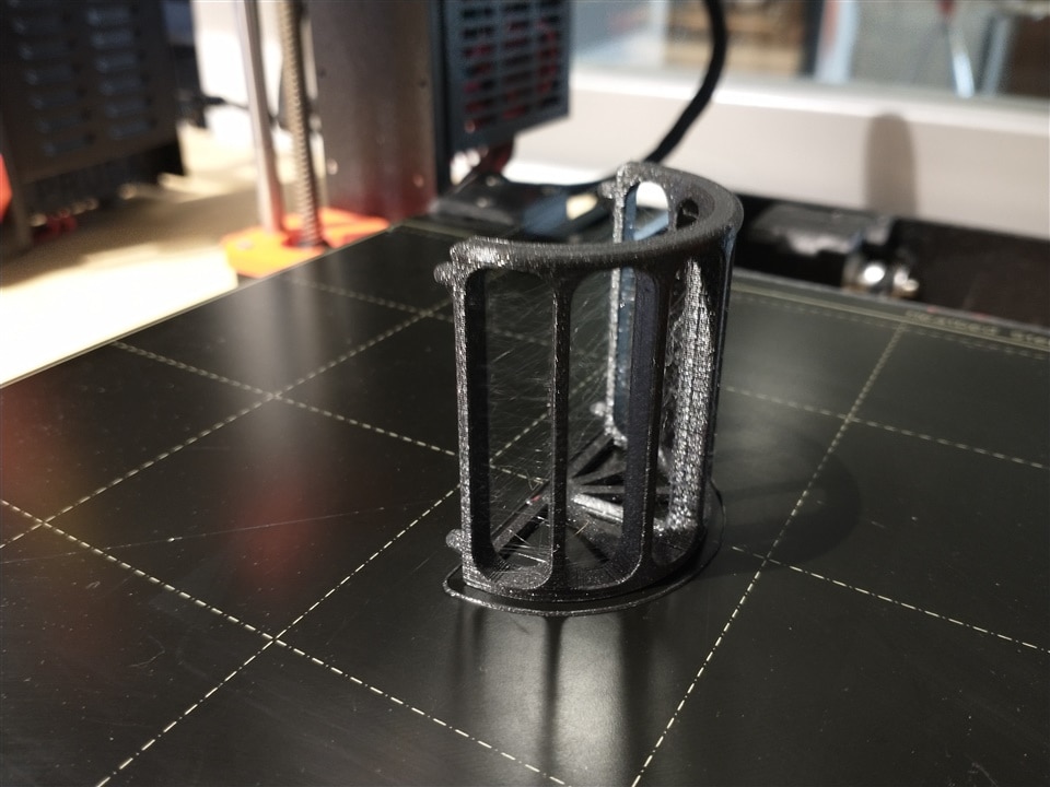

There is also a 3D printed guard to protect the internal sensor, but this is purely optional.

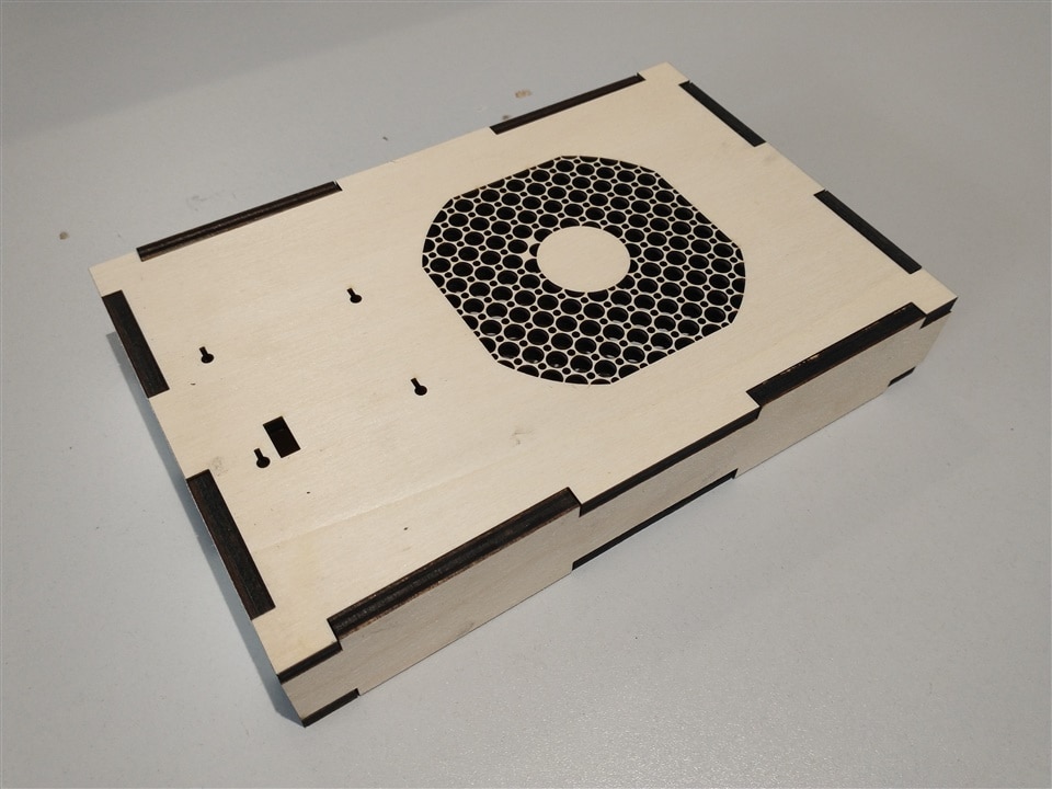

After cutting the parts they are glued as photographed with the front panel being a comfortable force fit.

I have included the files for the design here. I spotted a couple of missing holes in my design that you may spot in the photographs, but they have been fixed in the files. I hole for the power supply needed manually drilling where you need it.

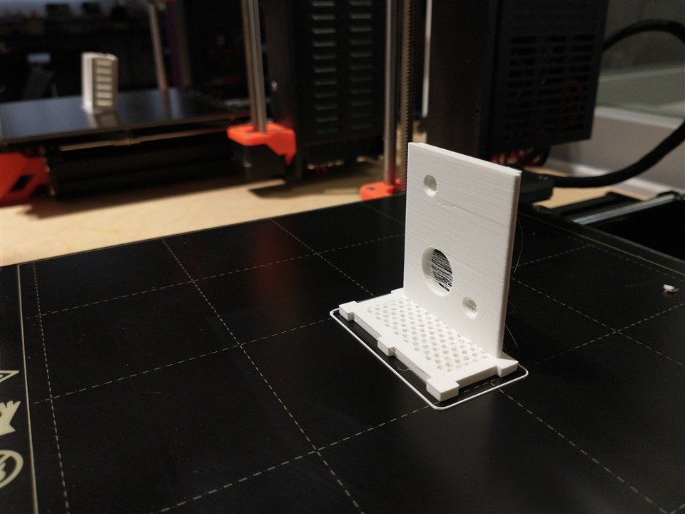

The External Enclosure
The outside sensor needs to be housed so air can get to it, but it is not susceptible to direct sunlight, wind or rain. I have taken a few design tips from weather station designs for this one. It is designed so it can be printed in just two parts and slide together once mounted on the wall.

The files to print your own are here. It may seem odd to print one have at that odd angle, but I have designed it that way so the roof will allow rain to drip off instead of evaporating, while not needing to waste materials by printing supports.

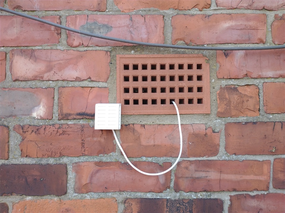

To mount it to the wall I inserted some custom plugs that I screwed in to and can drill out if no longer required. The layout of the enclosure has been measured to fit over the air brick’s holes as efficiently as possible so finding the location of the plugs when mounting to the wall was easy.
Inserting the plugs for mounting
One thing I did not realise until after I had started the installation is the holes get slightly smaller as they go into the wall. Only a little, but enough that I needed to change the connector going to the external sensor (most photos show the original). Also I was surprised that the air brick on the outside of the property was not exactly parallel with the inside, so the wire came out through a different hole than I thought it would.
Enclosure mounted on the wall
Sensor mounted on outside wall
