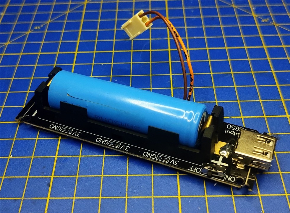

      • Powerbank Shield

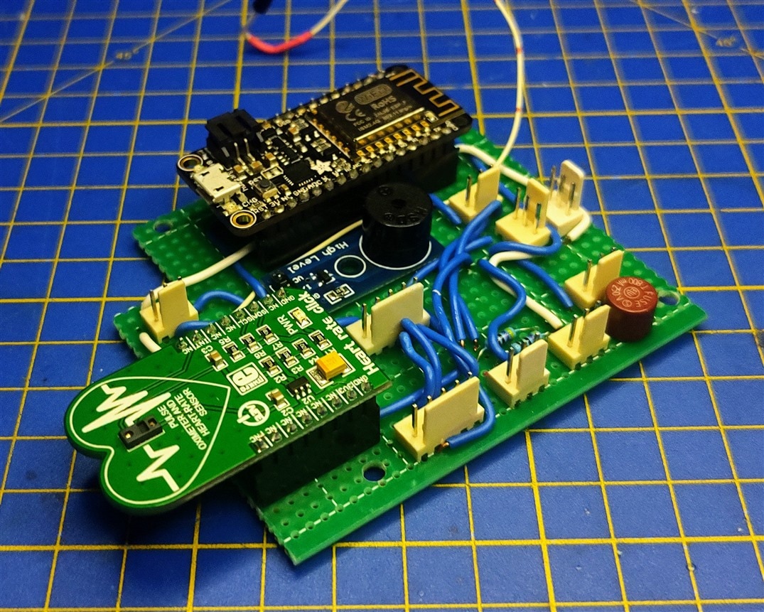

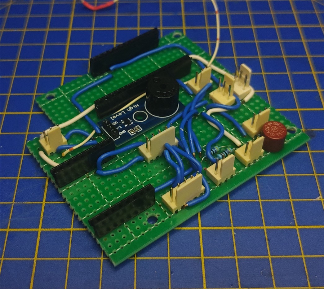

    • Soldering

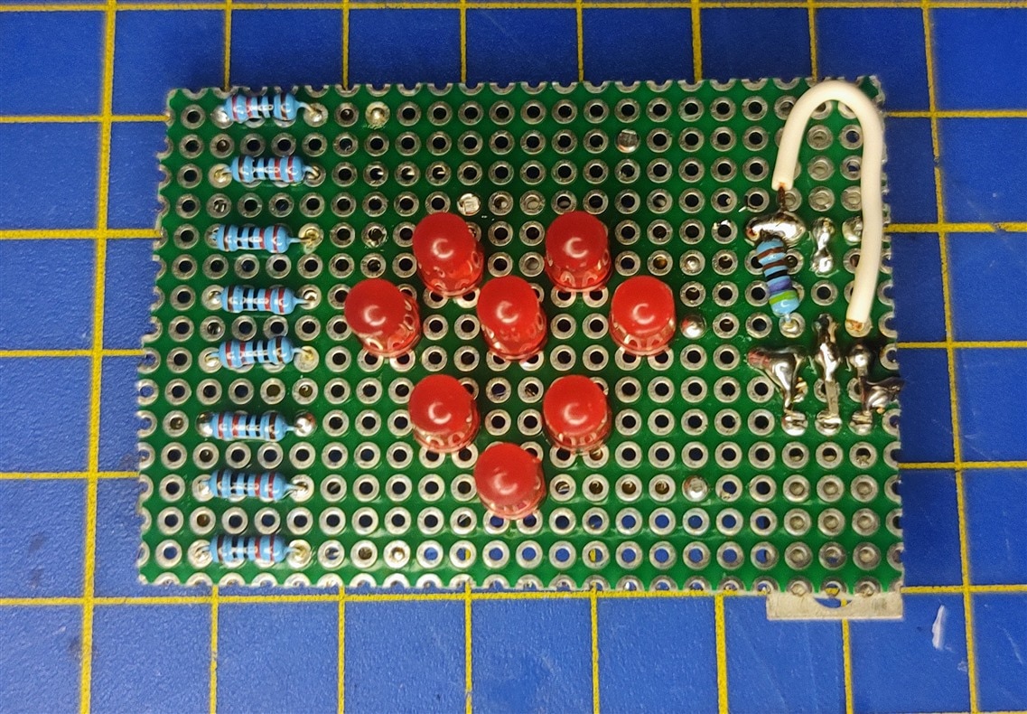

      • Main Board
      • Heart LED Board

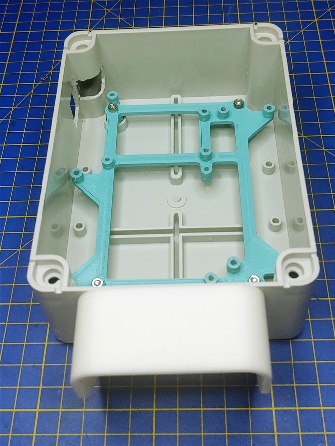

      • Enclosure and 3D Prints

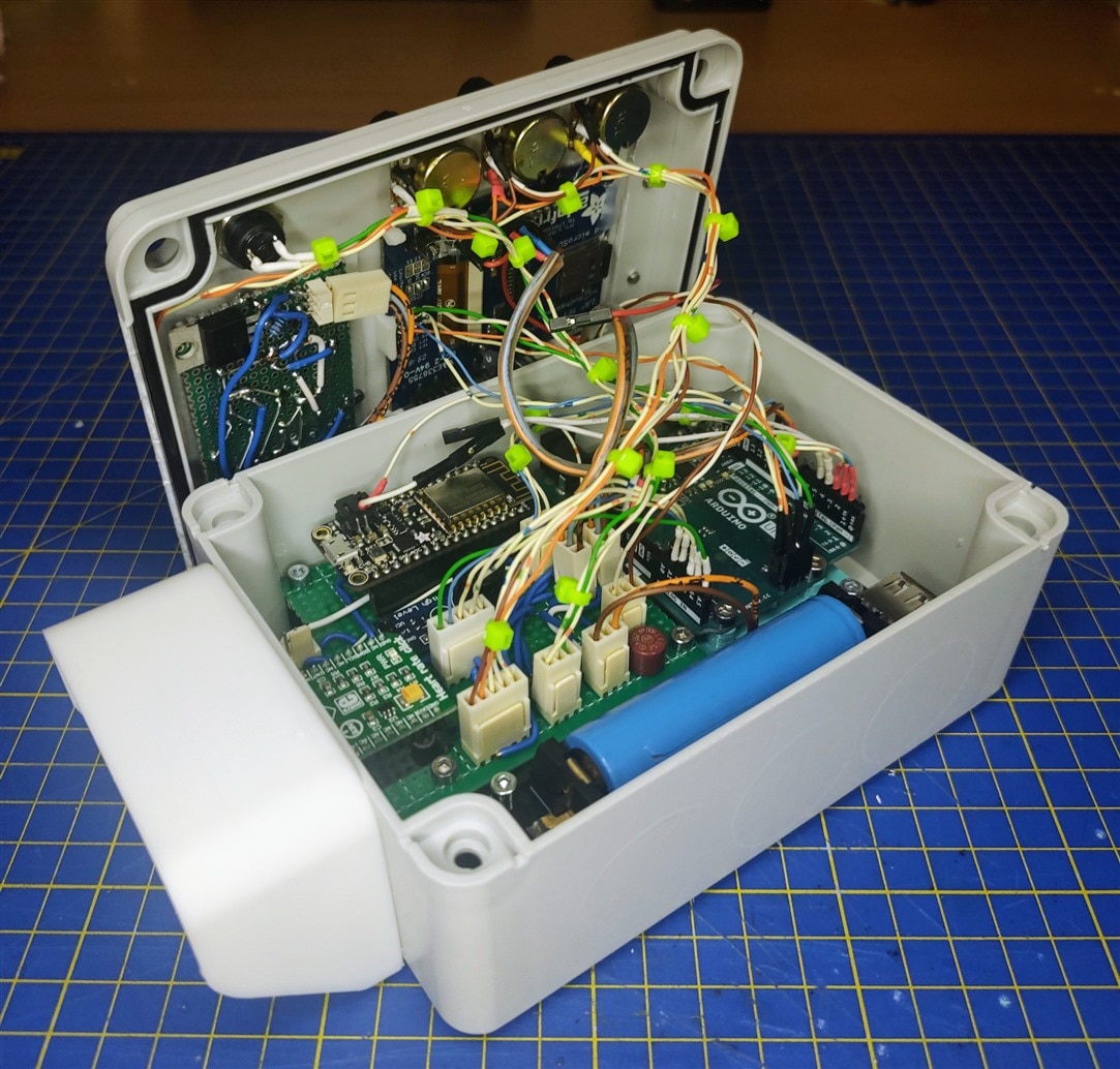

      • Final Assembly
    • Testing

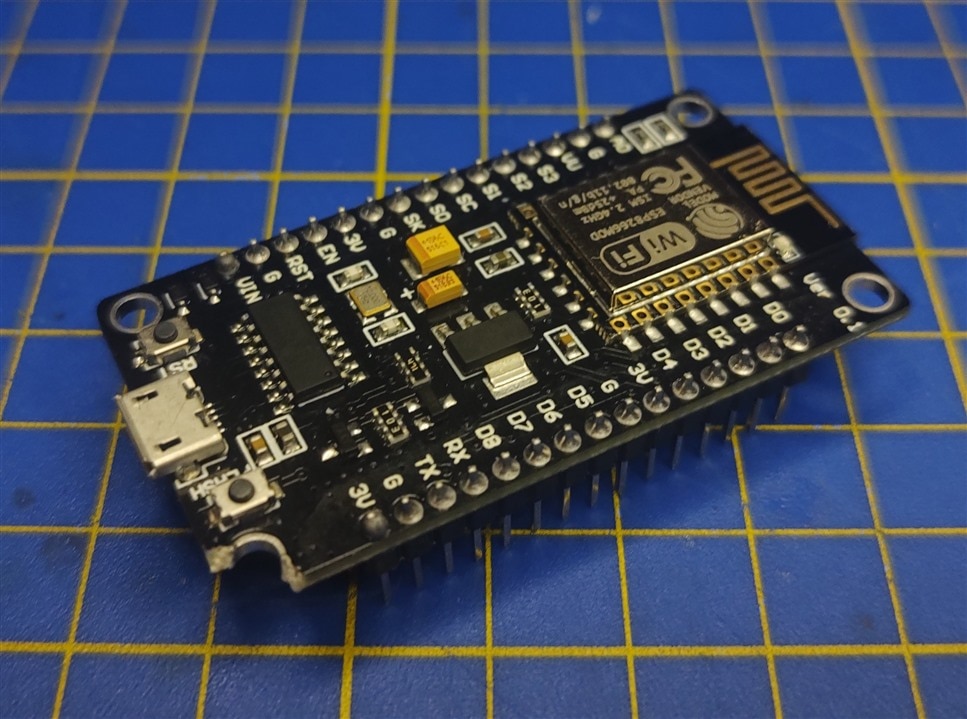

NodeMCU V3
This will be the main board in the HMS Mini, the Node MCU V3. Node MCU V3 houses an ESP8266 much like the Adafruit Feather Huzzah. It's a bit larger than the Adafruit Feather Huzzah, but they can essentially do the same things.

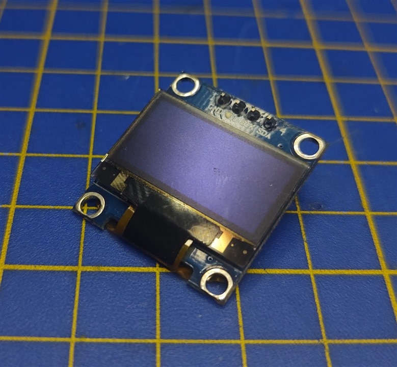

I2C OLED
To display the data to the user of the HMS Mini, I went with one of the small, generic, I2C OLED displays. They are rather easy to use with only 2 wires for I2C and 2 wires for the power. There is an Adafruit library for them, but I went with the OakLED library since it had all I needed for this project.

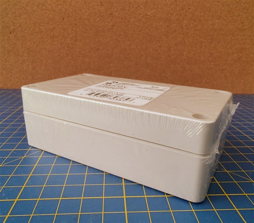

Enclosure and 3D prints
Let's begin by looking at the mechanical parts of the build first. One thing I want to point out is that I will be publishing all of the 3D models online for free to download, and you will be able to find them on the GitHub link in the comment section as soon as I post them online. For the enclosure, I went with a Hammond Manufacturing enclosure. It's extremely sturdy and high quality and also is (was) waterproof.
As for other mechanical parts, I only need to 3D print 2 of them. One of them is a mount for the small OLED display, while the other is a sensor guard so it can block out a bit of light that can hit the sensor so it can work better. It can also protect the sensor in case of a drop. Here are the models of these 2 parts.

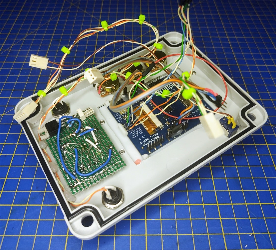

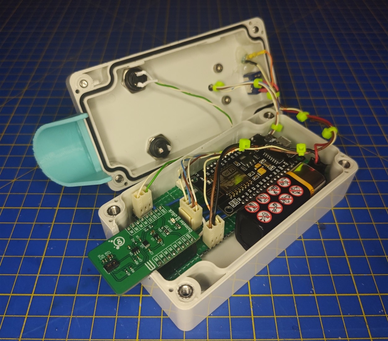

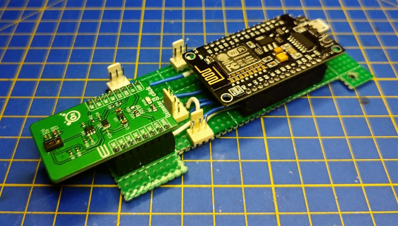

Soldering
Since this is a pretty small box and I needed to fit a 9v battery inside as well, I had to get pretty creative with how I was going to cut the perf board and how I wanted to organize all of the components since there wasn't too much space. I first thought I would have to use a linear regulator, but it turned out the Vin pin on the NodeMCU V3 can handle 9V easily. Here are some pictures of the perf board inside that I soldered.
And when we add the NodeMCU and the Oxi5 Click we get this.

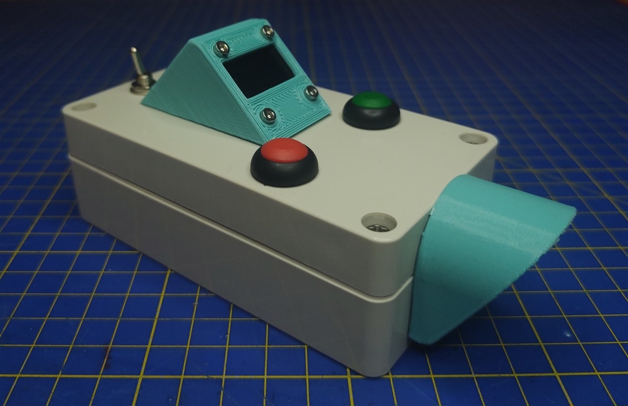

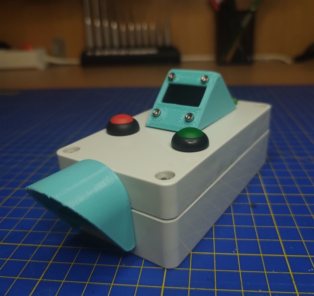

Final Assembly
Before we get to testing, we need to assemble everything. It's drop-in-place for the most part, the lid of the box needs some holes drilled and we need cut a hole in the body of the enclosure so that the sensor can go outside the enclosure to the user. The box is pretty small, so everything fits inside rather snuggly.
The connectors are a bit too big for the HMS Mini, and I would have rather used something like a JST connector, but these are the only ones I had on hand while working on it. Nevertheless, with a bit of cable pushing, it can be closed rather easily and secured with 4 screws, so we can get this.
I am really pleased with how it turned out in the end! While a 3D-printed enclosure could have maybe been a bit smaller, this enclosure is incredibly sturdy and does the job really well. The only thing I would change on it is the power switch in the back since it can be rather easily triggered if the device is thrown into a bag or something. But I love how they look and feel, so those were also the only ones I had on hand that worked for the HMS mini.

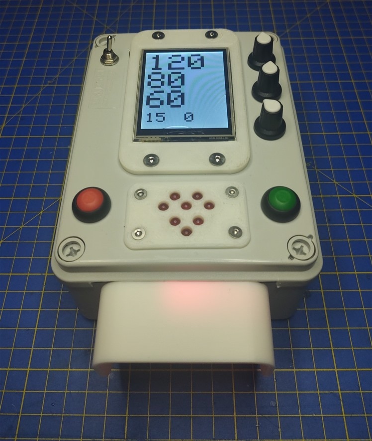

3. HMS
Now we get to the bigger of the 2 devices, the HMS. Electronics for the HMS is something I have already covered in detail in my third blog (Blog #3 - First Prototype), and they haven't changed since then, but I'll do a short refresher on the whole idea of the HMS here as well as go over the build, software, and testing as I did for the HMS mini.
Idea
My initial idea for this was to have a device with a pressure sensor that can parallelly get readings with a blood pressure monitor and can also be used to measure the heart rate and SpO2 levels using an onboard sensor. Unfortunately, I had to change some of the things in that idea, one of them being the pressure sensor for monitoring blood pressure. In my fourth blog (Blog #4 - Measuring Blood Pressure), I went through a few ups and downs, and managed to get some rather decent results, but couldn't get the actual reading in the end, so I had to ditch that idea for now and stick with the back-up option of using potentiometers to manually enter the blood pressure. Here is the initial drawing I drew for HMS.
Most of the things actually stayed as shown in the picture above, but when we look at the schematic for the system design of the whole thing, I again made some changes, with the biggest one being already explained in the section above, about the HMS Mini.
The change in question is that I didn't manage to get both of the heart sensors to work on the same Arduino, but that turned out great since now I have the HMS Mini as well! One thing that changed for the better is power electronics, where I found a great little board that combined everything needed for a 18650 cell with an included battery holder as I will show in the next section.

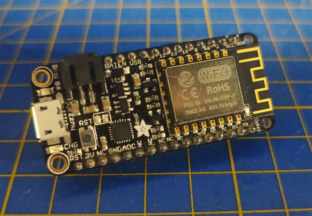

As mentioned on the Arduino Uno tab, the next important component is the Adafruit Feather Huzzah. The Adafruit Feather Huzzah is an all-in-one ESP8266 WiFi development board with built-in USB and battery charging. It works on a 3.3V logic level so we need to be careful when using it with the Arduino Uno since the Arduino Uno is on a 5V logic level.

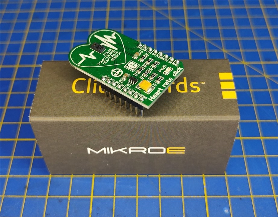

Heart Rate Click
The pulse and oxygen saturation sensor that I will be using for this part of the project is the Heart Rate click, this is the board that has the MAX30100 sensor on board. Heart Rate click is a heart rate monitoring and pulse oximetry measuring Click board. It features an advanced oximeter and heart rate monitoring sensor, which relies on two integrated LEDs, a photosensitive element, and a very accurate and advanced low-noise analog front end, to provide clean and accurate readings.

Powerbank Shield
This is the new component I found for this build, and I love it. It's a power bank shield for a 18650 cell. It comes with a micro USB port for charging, and a USB A for charging your devices, but most importantly, it has pads on the sides that are either 5V or 3V to which we can solder. It really makes it a great all-in-one solution for portable projects and it can be used like a completely normal power bank if someone wants to.
Besides these components, I used a couple of buttons, potentiometers, resistors, and a lot of crimp nylon connectors. I love using them since they are incredibly cheap and really easy to use and crimp, though, I have a headache from time to time when a pin just pops out of the connector.

Next on the list is soldering. This time, instead of 1 board that we need to solder, we need to solder 2 boards. One will be the main board, and the second one will be the LED board. I'll begin with the bigger and more complicated one.

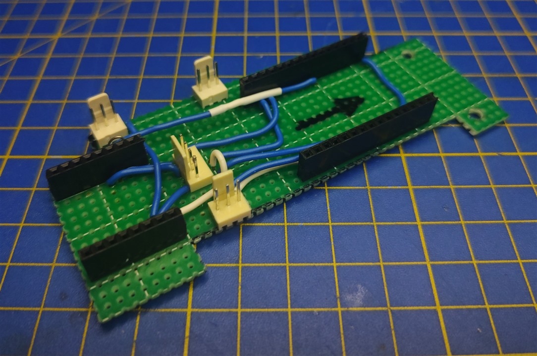

Main Board
The main board in the HMS is like a motherboard in the computer, the main function of it is to connect everything together. Things like the buttons, potentiometers, and Arduino are all connected using connectors, while the things like the Adafruit Feather Huzzah and the MikroElektronika Heart rate Click have their own sockets on the main board. Here are a couple of pictures of the finished board.
And here is a picture with the boards in their sockets.

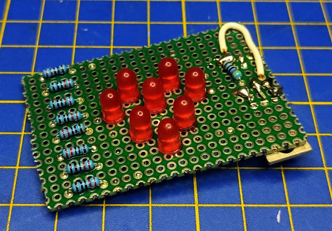

Heart LED Board
The other board is actually a heart LED board. My initial idea was to have a heartbeat indicator either on the LCD or as a single LED as I've shown during testing the first prototype. But it got me thinking that it just looks plain and boring, so I decided to switch it up a bit and make a small heart shape out of 8 LED-s. The circuit to drive them is shown below, and only uses one MOSFET to do so.
Because the LED-s needed to go up and through the LID, I had to keep all of the components as flush as possible with the perf board, hence why you only see resistors on top. It's a double-sided perf board, so I soldered on the connector and the MOSFET on the other side of the board.
I am extremely happy with how it turned out, but as with the HMS Mini, the LED-s are incredibly bright. I got a small organized set of LED-s and just put 220Ohm resistors as I usually do with LED-s, but these are just incredibly bright. Still am thrilled with how it looks and the effect it gives.

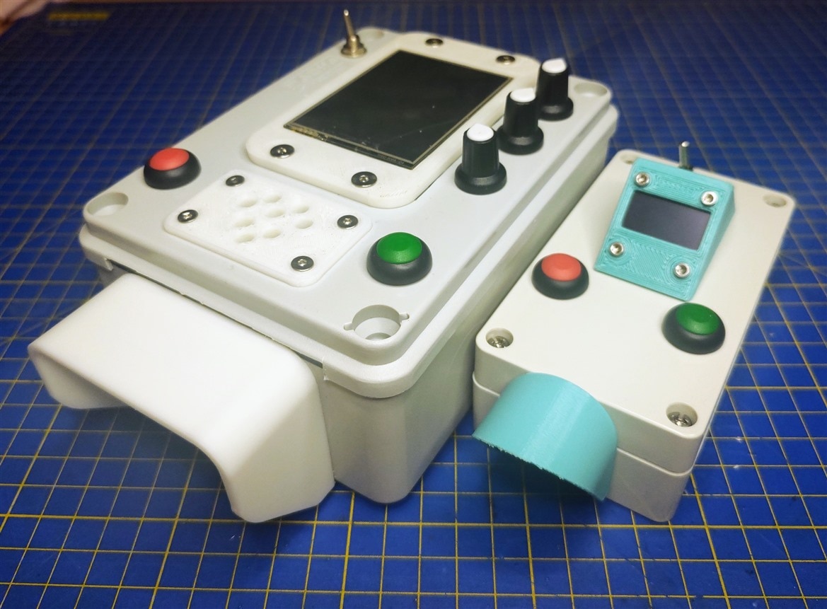

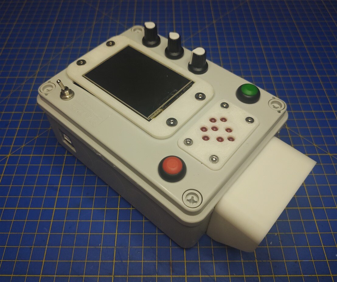

I used an off-the-shelf enclosure for this build, but not a Hammond one as I did for the HMS Mini. As for the 3D printing, I had to print out 3 different things for everything to come together. The first thing is the electronics mount. This is something that I got used to doing anytime I need to pack a lot of electronics in a small area. It can be done rather quickly if you the board sizes and it prints really fast.
On the front, in the picture above, you can also see the shroud around the sensor. Its purpose is to block out a bit of the light coming from the surroundings as well as protect the sensor in case of a fall. Another thing I had to print also was the mount of the LED heart. It was pretty easy to model, since the LED-s are 5mm in diameter, and the spacing between them is easy to figure out since they are on a perf board with 2.54m spacing between adjacent holes.
Final Assembly
And again, all we need to do before testing is to assemble everything. I had to modify the enclosure a bit so the Arduino USB port can go through as well as the Heart Rate Click board with the sensor part. You can see all of the modules fitting snuggly next to each other.
Another thing that required a fair amount of assembly and soldering was the lid of the box as well. We need to wire up the 2 buttons, the power switch, 3 potentiometers, an LED heart board, and a TFT LCD.
I made a few cables using the nylon connectors and slowly crimped them making sure that there is enough length to the cables.
All that's left now is to close the lid and secure it with 4 screws, and we have the finished HMS! One thing I would just like to mention, you can see the 3D printed white mount around the LCD, but I didn't mention it in the 3D printing section, and the reason for that is because the model is just bad simply said and I don't have a better one. It's the reason I cracked this display in the first case.
With that, the assembly is finished!
Testing
This part is always so rewarding after all of the necessary stages that came before it. Before I show the video, I want to explain how this device is intended to be used. First, we power it on using the power switch next to the LCD. After powering on, we can put our finger on the sensor in the front and look at the readings from the sensor at the bottom of the LCD screen. Every time the sensor detects a heartbeat, we will get a buzzer sound, as well as a flash from the Heart, shaped LED pulse indicator in the front. If now you want to enter the blood pressure you measured on a commercial device, you hold down the Red button, and while holding it, you turn the potentiometers to adjust the numbers on the screen to match the values from the commercial unit. Once you're done with that, you can press the green button, and the HMS will upload that data to the server which will then push notifications to a laptop or mobile phone.
And it works! There was some troubleshooting needed with a broken connector, but I got it working rather quickly. I'm sad that the pressure sensor approach didn't give any useful results for now, but this alternative is rather simple to use as well. To end with the HMS, here is a picture of it working!
