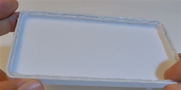

This blog shows some quick tests I did to see if shielding makes a difference to cell phone radiation. These tests are a follow up to an earlier blog on microwave radiation.
To set up for the test, I made a shield from two 3D printed shells sandwiching a layer of aluminum foil between them.
The shell and foil covered 5 of the 6 sides of the phone - about 1mm from the back of the phone and about 2mm from the sides.
I ran some tests with and without the shield to see if it made a difference - and it definitely did. I was a bit surprised by the results.
The main scenario that I am interested in is the case where the phone is in a pants pocket as studies show this results in lower testosterone and lower sperm count. So I placed the phone and meter in appropriate locations on a Hybrid III crash test dummy and took some readings. These particular dummies have seen some major trauma (explosions) and you can see they look a bit charred, but the geometry is still good - this is a 50th percentile male.
These readings are the maximums I saw in this geometry. The shielded maximum was a rare spike, it spent most of its communication time at about 1 mW/m2.
The unshielded maximum is closer to its normal value ~ 150 mW/m2.
In this experiment the shielded case yielded 10 to 100 times less radiation density at the location of interest.
This is not a particularly scientific experiment, but the results do suggest it might be worth investigating shielding in a more scientific way.
I did not check to see how cell phone performance was impacted by the shield - I imagine the shield didn't help communications ...

    jw0752 over 9 years ago +4
    Another great blog and good demo. I do question if you don't have conflicting interests with protection vs functionality of the phone though. Perhaps you might do better to shield the sensitive area as…
    dougw over 9 years ago in reply to jw0752 +4
    Yes, the phone transmitter might even see extra stress by putting shielding nearby, in addition to the possibility of having communication difficulties. These experiments aren't recommendations, they are…
