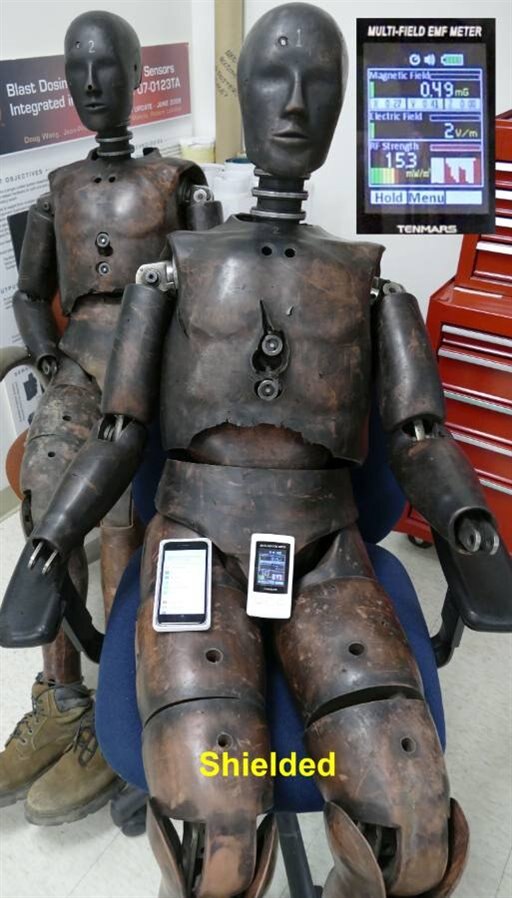

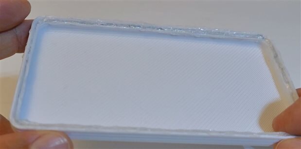

To set up for the test, I made a shield from two 3D printed shells sandwiching a layer of aluminum foil between them.
The shell and foil covered 5 of the 6 sides of the phone - about 1mm from the back of the phone and about 2mm from the sides.
I ran some tests with and without the shield to see if it made a difference - and it definitely did. I was a bit surprised by the results.

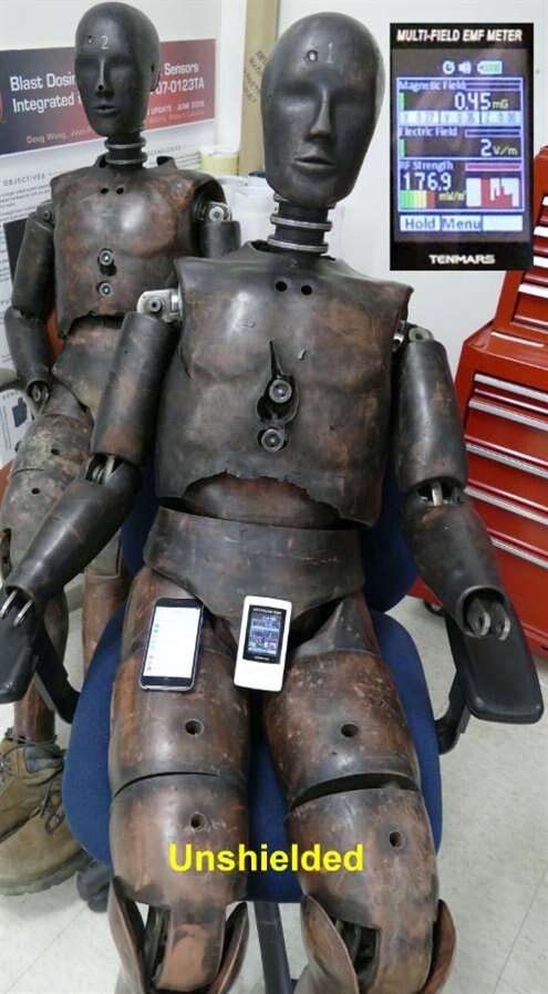

The main scenario that I am interested in is the case where the phone is in a pants pocket as studies show this results in lower testosterone and lower sperm count. So I placed the phone and meter in appropriate locations on a Hybrid III crash test dummy and took some readings. These particular dummies have seen some major trauma (explosions) and you can see they look a bit charred, but the geometry is still good - this is a 50th percentile male.
These readings are the maximums I saw in this geometry. The shielded maximum was a rare spike, it spent most of its communication time at about 1 mW/m2.
The unshielded maximum is closer to its normal value ~ 150 mW/m2.
In this experiment the shielded case yielded 10 to 100 times less radiation density at the location of interest.

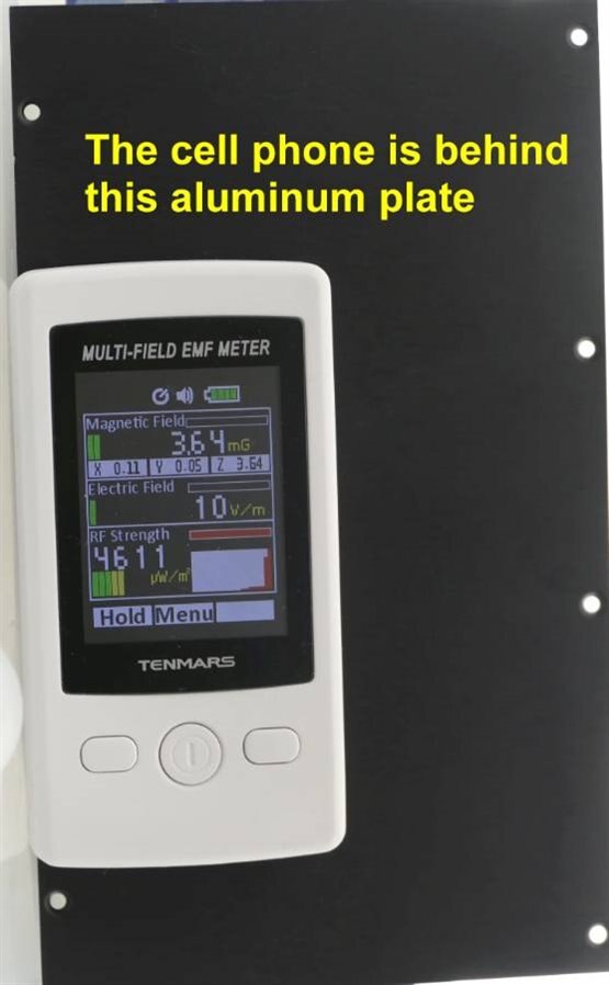

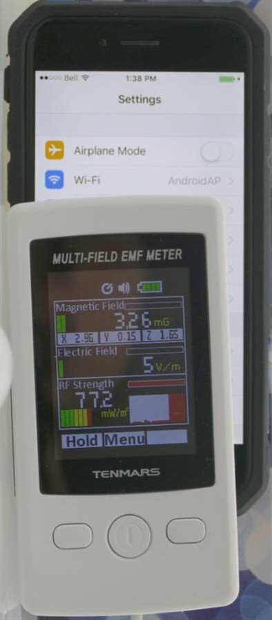

The other geometry of interest is holding the phone at your ear.
Here are some images showing a reading with the meter where an ear might be and what happens if a metal plate is inserted between the phone and the meter.
Note the units change in these images - one is mW the other is uW, so the last image is 4.6 mW/m2
One observation is that the field strength seems to be lower at the face of the phone compared to the sides - by about 50%.
The other observation is that the metal plate cuts the field strength by more than a factor of 100. Again, I did not determine how this plate impacts cell phone communications performance.
