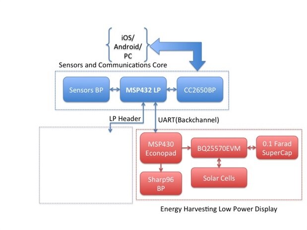

In order for the wearable to have a user interface, the Sharp96 Booster Pack was selected. The 96px x 96px real-estate is enough to present relevant information in a compact and efficient manner. Since mounting the entire MSP432 launchpad together seemed to defeat ergonomics, I elected to use my DIY MSP430 econopad. To add to the uniqueness of the design, the BS25570EVM was employed with a solar panel and a 0.1F super capacitor to power the display part of the design. The diagram below shows the second module as it plays out in the final design.
Let us take a look at each of the above modules one by one.

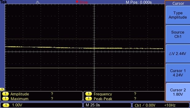

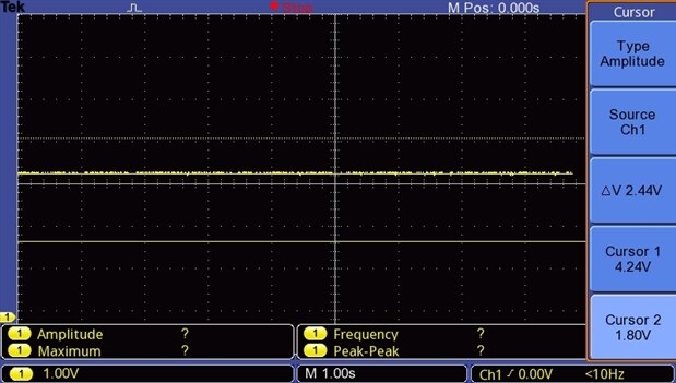

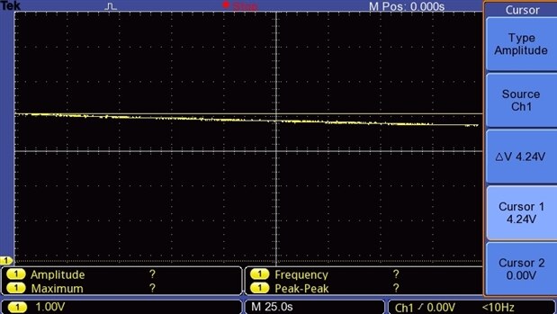

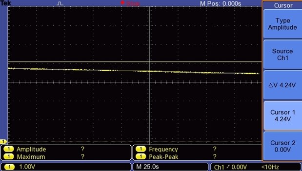

Further analysis confirmed that the MSP430 and the Sharp96 Booster pack only draw 330uAmps of current at 1.8V which means that the system can operate on the harvested energy. The internal buck converter comes preconfigured to provide 1.8V and the jumpers were set so that the internal high efficiency buck converter would keep operating until the supercap was discharged to 1.8V. This adds a longer lifetime to the display which is only usable in well lit areas.
The graph above shows the discharge of the superCap over time with a 25 Second per division.
When the solar panel is exposed to ambient light inside a room, the charge rate is greater than or equal to the discharge rate.
This brings us to the conclusion that the small sized solar panel is sufficinent considering the high efficiency BQ25570.

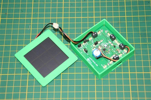

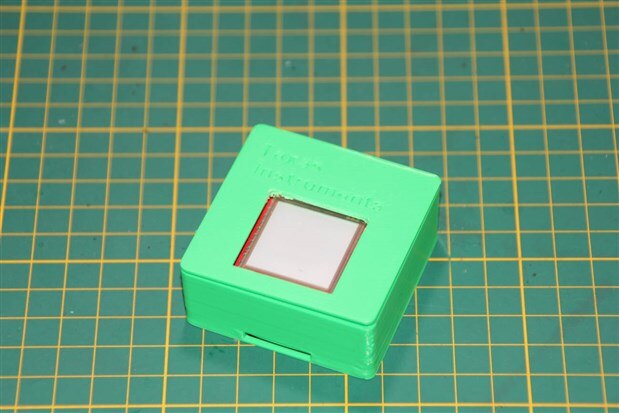

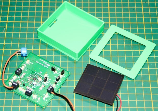

d. The Enclosure

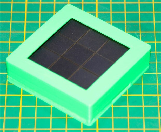

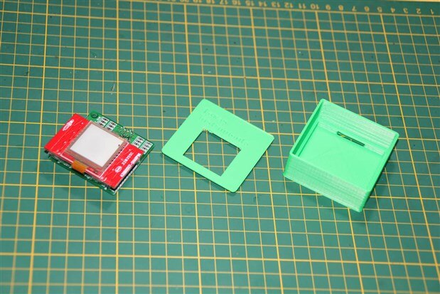

Making this part wearable was a bit of a challenge since hanging a solar panel on a jacket would be non-ergonomic. A thin box was created with exact dimensions to fit the EVM as well as the SuperCap. The result is shown below. The box has space to attach straps and be mounted onthe jacket.
