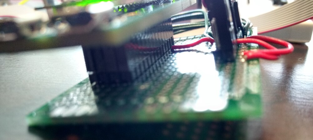

Edison interface to protoboard
Ribbon header goes to Relay board

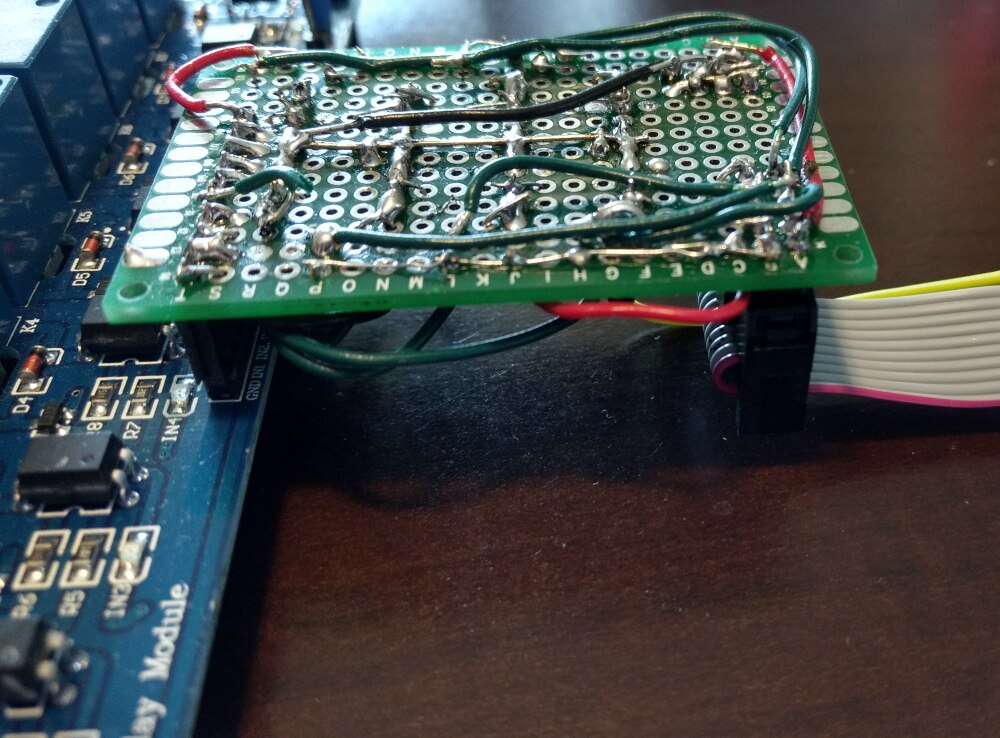

Relay board hooked up and running.

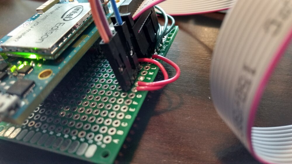

Edison Interface
I used my protoboard to create 4 rows of male header pins to interface with the 4 rows of female header pins I had put on the Edison Mini board earlier.  Then I wired up pin J17-4 to 12V and pin J19-3 to ground.  I wired up GPIO lines from J20-4 through J20-11 to the header going to the relay board. The 12V is also taken to this header so that it can be converted to 5V and returned for future use.
This week gpolder posted the following image on Workshopshed's post and it gets my vote for the most useful.  Some pins cannot be used, so I tested them before hand to make sure that J20-4 ... J20-11 could all be used for GPIO.  For example GP134 on pin J20-3 does not work in Node-Red with the Johnny-Five controls.

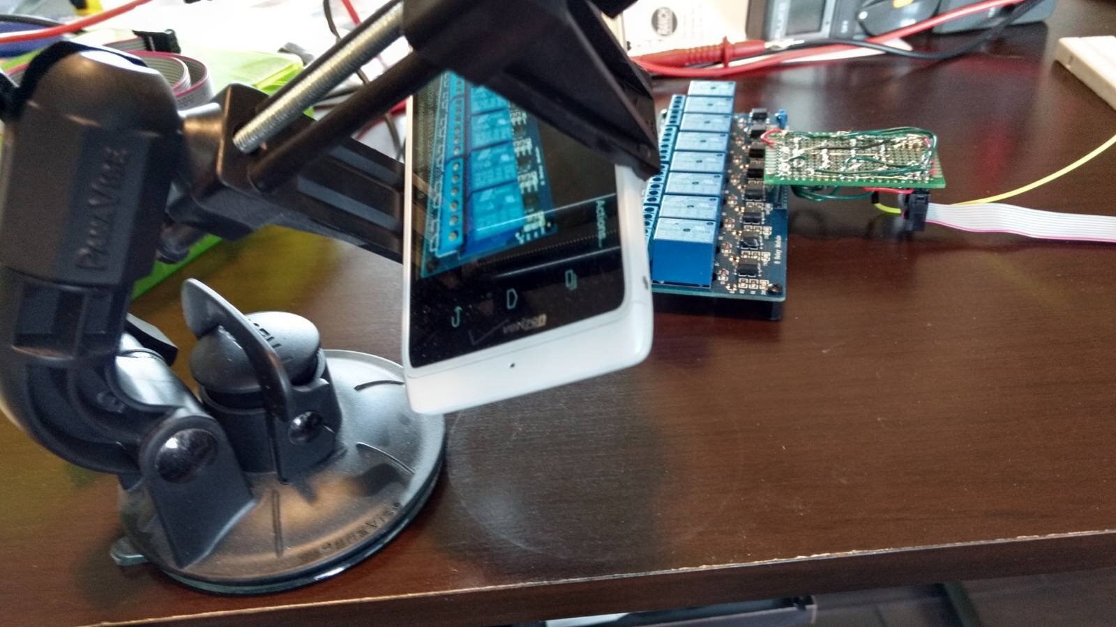

About The Video
Video was a screen capture with a webcam feed and putty shell.  Here is my webcam setup.  Yes, it is an old Android phone running as a web cam.
