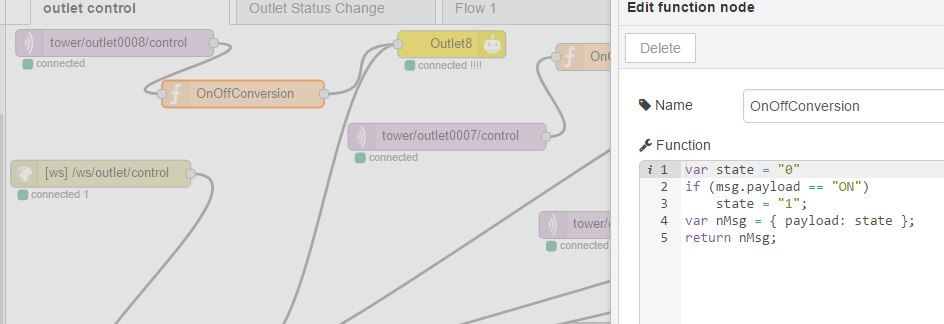

One of my goals was to integrate this from Home Assistant. Home Assistant (HASS) is open-source home automation package written in Python. Check it out. It can talk to several devices using multiple protocols. I use mine to automate my lights to turn on and off in the kitchen (under counter that are on all night) and to turn on my wife's coffee machine (not working now, because the Belkin WeMo Switch is broke).  Since HASS currently has access to many things in my house, it would be nice that my PDU project would play with it. I have modified my Node-Red setup on my Edison to send out and receive proper MQTT to integrate right into HASS.  Also in this update, I will show you the starts of the new web interface I am designing.

Node-Red MQTT Message
Next modification was to have Node-Red MQTT jive with HASS.  HASS expects to turn on and off outlets with the ON and OFF commands in the MQTT message.  Now you can customized this, but why not play nice.  I could modify HASS to send a 1 for ON and a 0 for OFF with the payload commands for ON and OFF.  I chose to have Node-Red flows that talk HASS' lingo.  Here is a sample of each sending a status and receiving a command.
Here is receiving the command. This one if for MQTT topic "tower/outlet0008/control", then the OnOffConversion takes the payload and converts it to a 0 or 1 as needed.  Simple, but repetitive in Node-Red.
And on the status update side:
With the OnOffConversion code looking like this.
var state = "OFF"
if (msg.payload == "1")
    state = "ON";
var nMsg = { payload: state };
return nMsg;

    jasonwier92 over 9 years ago +4
    Workshopshed and DAB , you two rock. I have done another BLOG with your suggestion and encouragement. I assumed it could not be done and I have done it in the past, just thought this time it could not…
  • Workshopshed
    Workshopshed over 9 years ago +2
    If you find yourself using the same function repeatedly you should be able to put that into a separate flow then included that several times in your main flow. I did something similar to abstract a motor…
    DAB over 9 years ago +1
    Nice update. I agree with Andy. Any good program will group like functions into a single package. Much easier to maintain and change. DAB
  • jasonwier92
    Workshopshed and DAB, you two rock.  I have done another BLOG with your suggestion and encouragement.  I assumed it could not be done and I have done it in the past, just thought this time it could not be done.  I love you guys! image
    Nice update.
  • Workshopshed
    I did something similar to abstract a motor controller Controlling motors and lights with Node-Red
