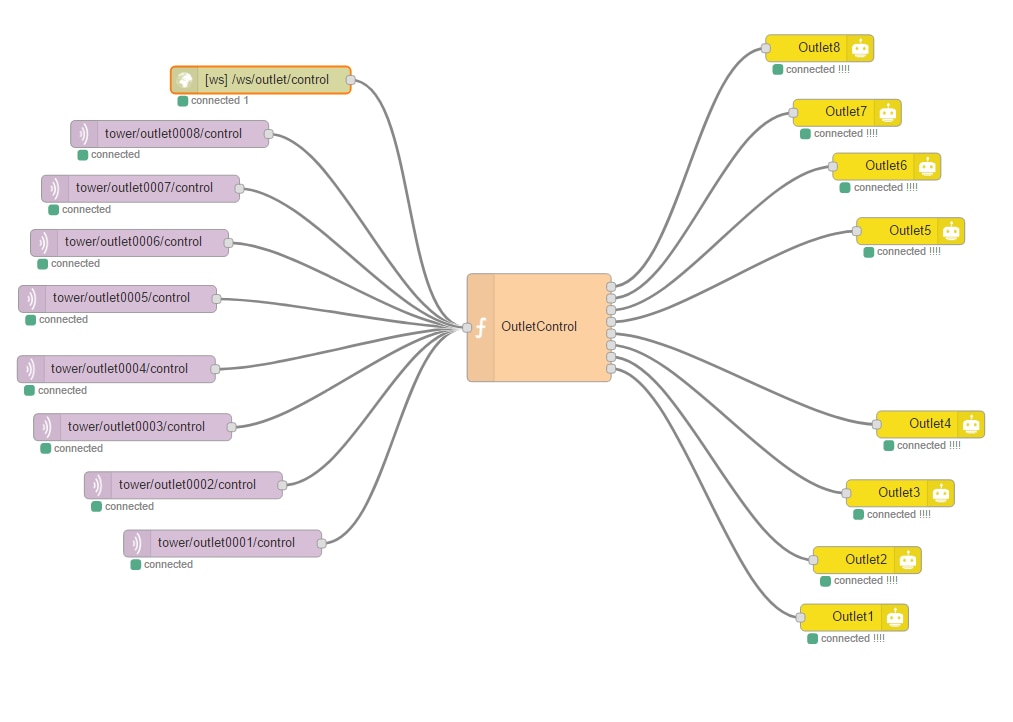

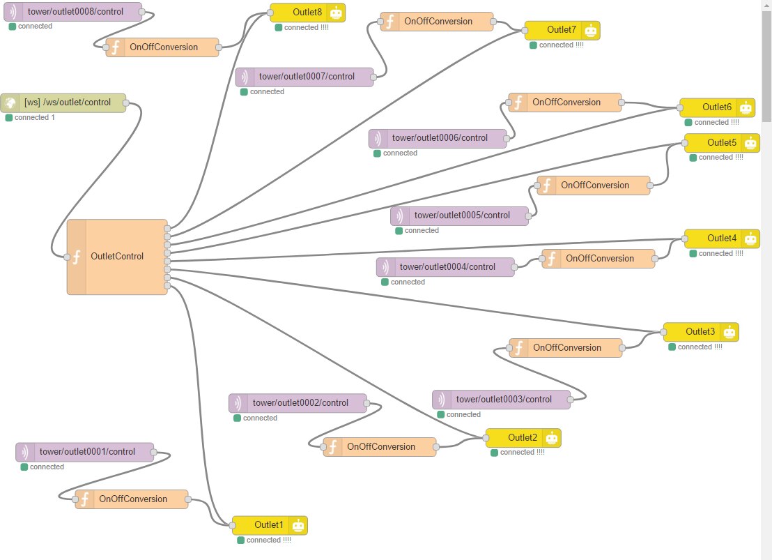

My outlet control is next on the list to fix up.
What it was: (can you say nasty)

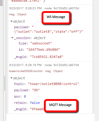

What I need is a way to tell which kind of message came in.  Lets see what they look like.
So if I can test for the existence of msg._session and msg.topic, I should be able to know which message came in and where to send out out.  So I took my existing function and added a new section, based off the fact if it is a MQTT or WS message.  Here is my function code now.

And now it looks like this.
So much better. In 12-2 I wondered if HASS would do MQTT JSON switches and the answer is no. Also Home Assistant can use Web Sockets, so you could use Node-Red for your Home Assistant automation.  This is nice, because HASS's automation is clunky, limited, and you have to reload the config after each change.
