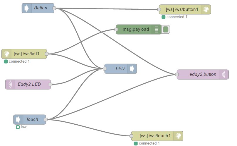

Here are the node-red flows.
I highlighted some nodes that do not work and are just dreams. These are to handle tracking what state the devices are in.  So that is where the next section comes in to play as we need to track what state stuff is in so that we can draw the user interface correctly.
Node-Red Shortcoming
One thing that is hard to do in Node-Red is to know the state of an output. In Python or Node, you can query the the state of an output. This is nice when a new client connects or knowing when a output has been changes via a external source. I have been processing different ways of overcoming information that I need to have and here is a list of how I think I will do it.
  1. Store the states in a database, MongoDB
  2. Refresh MongoDB on changes from external sources
  3. Write a watcher that updates MongoDB and if a state was found incorrect, push out a notification.
