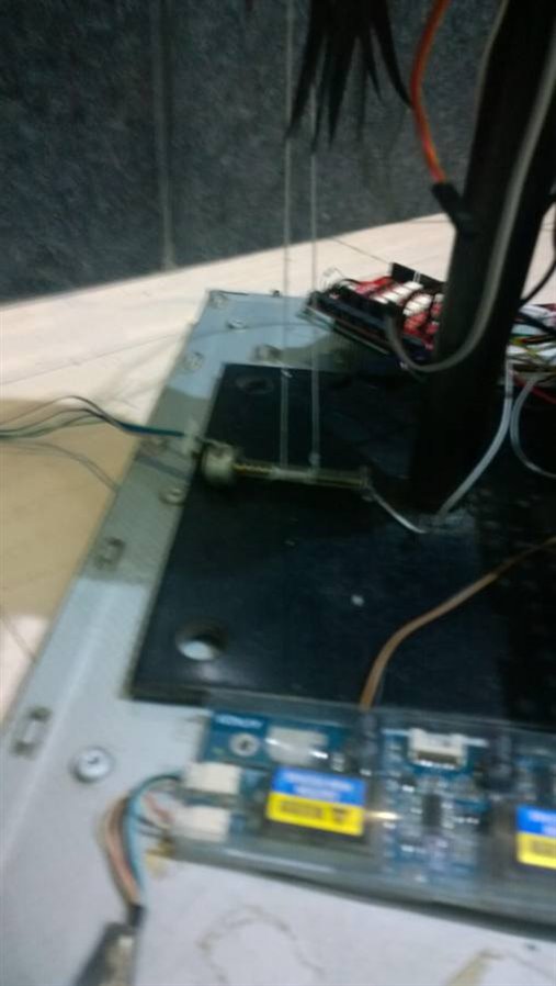

Old Monitor     -   LCD is used as Base, and becomes a cool under glow night lamp, Used a part of the chassis as a wall hiding the circuitry.

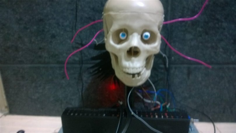

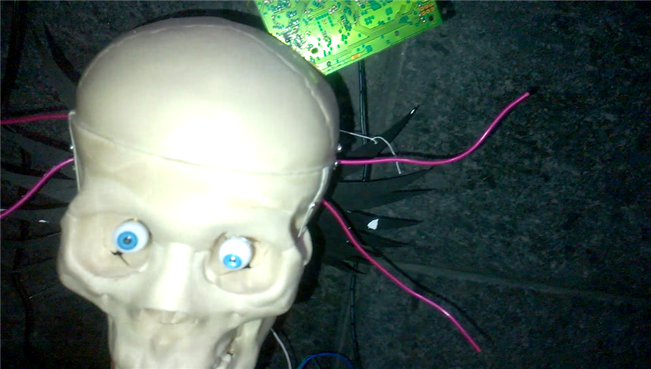

The eyes got some attention from my friends image(but the problem is if there are many people or its a hot day, it doesnt work as expected but with a single moving target it scares them. need to do some sort of calibration to fix this), but the coolest part was audio Reactive EL which actualy gave the feel of electric arc.I need to personally thank mcb1 and Workshopshed for suggesting out the EL wire.

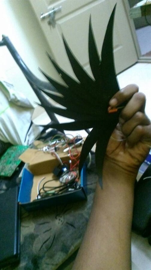

I actually made some wings out of old invitations. used the stepper to open them after the intro music.
Well I used EasyDriver for running the stepper.
The setup

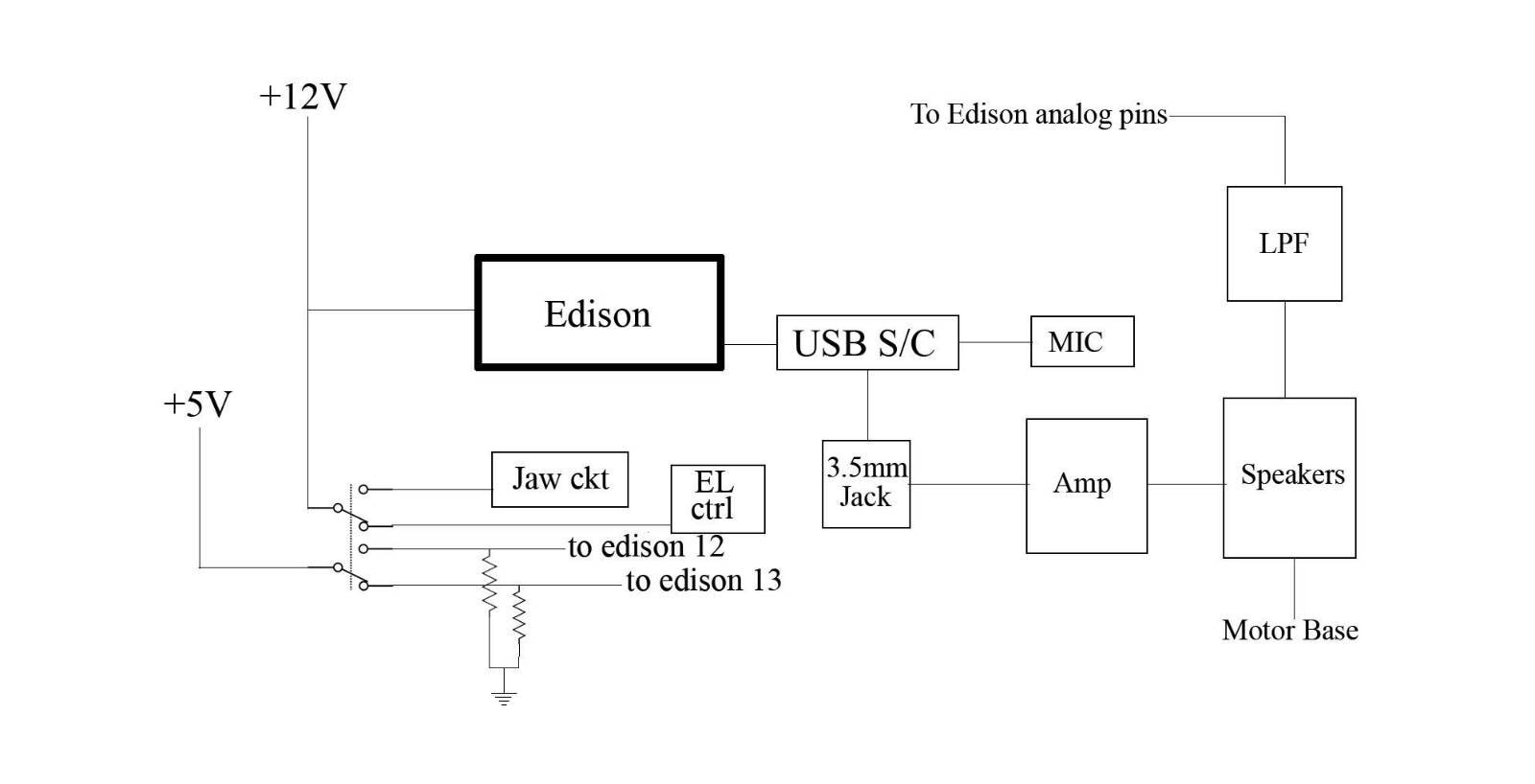

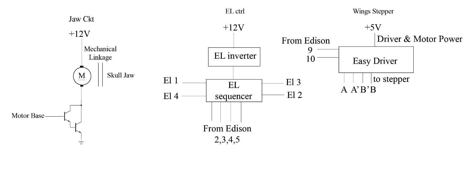

The Schematic:
I soldered all the connections to the ProtoShield, I used a 3.5mm stereo jack to make AUX and Edison use the same Speaker.
A simple 3position DPDT was helpful for switching between AUX and Speech Recognition mode. My PCB app got crashed so drew this block diagram in paint.
{gallery} Block Diagram
Soldered everything into the Protoshield
