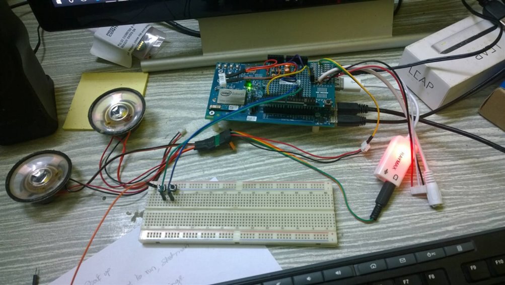

Carmelito Andrade has written a nice blog on setting up USB sound card and using eSpeak to get weather update using the Open Weather map API.

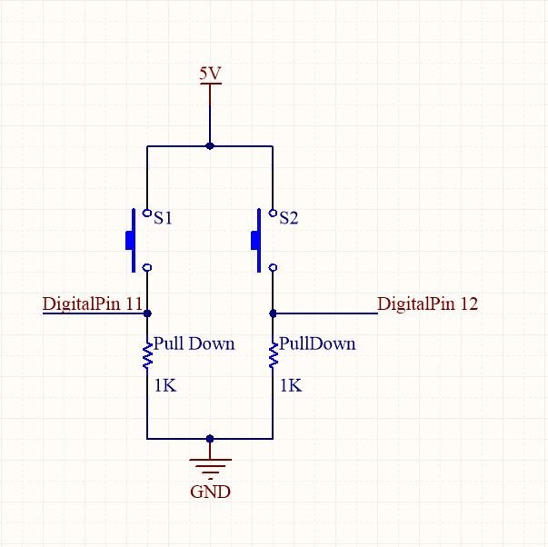

The setup
Circuit
If you need something Regarding the Amplifier connections Just check my previous blog.For now its plugged into the USB sound card.
The Code: Its actually 4 scripts, 1- Arduino and 3-Python. The Arduino program checks for Button Presses and calls the python scripts.

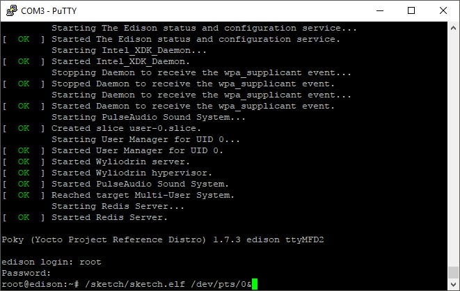

So after uploading the Arduino program don't expect it to call the python scripts, no its not gonna happen, seems to be a unsolved problem .
But if I run the script from the Linux side it works, the arduino sketch gets saved as sketch.elf,in /sketch directory.
just run it using the
/sketch/sketch.elf /dev/pts/0&

    Your run on boot issue could be a path issue as you are using relative paths. It could also be permissions or timing.
    Perhaps use MRAA to check the inputs and run all your code in Python?
