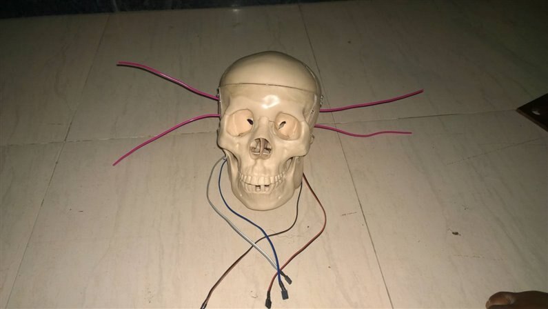

The EL sequencer came in....thanks to Workshopshed for suggesting them..
tried playing with them for some time(Sorry couldn't capture a video) , also fitted the EL wire to the skull.
Got some old Mild Steel pieces from scraps, some welding and tada we got a support for the Skull image

  • Workshopshed
    Workshopshed over 9 years ago +3
    Looking good, I do like EL wires but have yet to find an excuse to use them. Perhaps can inspire the family to let me do a Halloween project
    dougw over 9 years ago +3
    Nice job so far. I'm envious of your capability to weld up a nice stand.
  • sakthi.1260
    sakthi.1260 over 9 years ago in reply to Workshopshed +2
    And with the sequencer you could do really amazing stuffs, I actually started to design a sequencer board for Arduino mega with 16 Inputs , will share gerber files once done.
