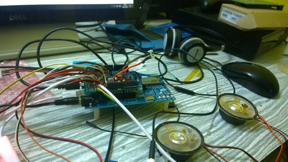

The Setup.

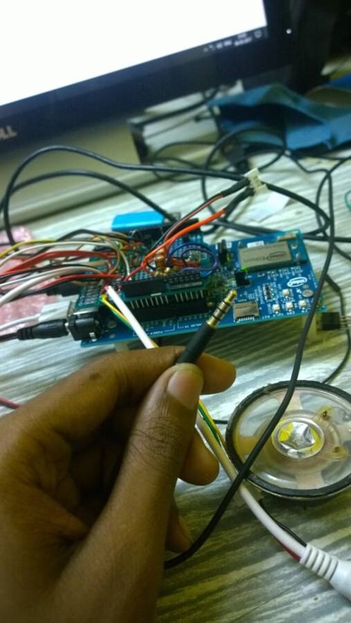

Its simple,just plugged in the Microphone into the USB sound card. Looks lil clumsy, have soldered plenty of wires over there.
But I've used a separator cable, since the Headset I'm using is  4-pole jacked (Mic and Speaker comes in same pin)
I found this guy around , checked it...was broken but the leds were working thought of using it as a notification light when recording happens in speech recognition mode

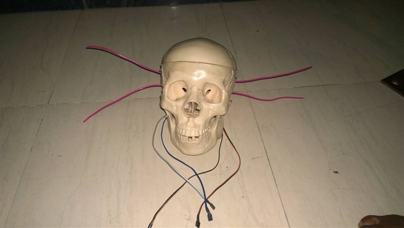

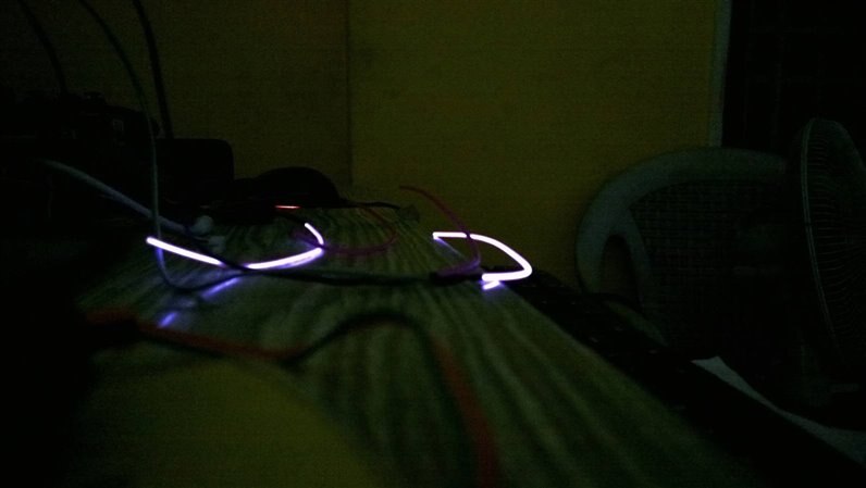

The EL sequencer came in....thanks to Workshopshed for suggesting them..
tried playing with them for some time(Sorry couldn't capture a video) , also fitted the EL wire to the skull.

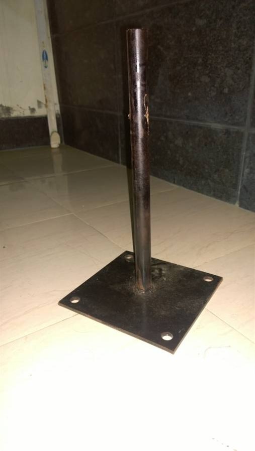

Got some old Mild Steel pieces from scraps, some welding and tada we got a support for the Skull image

    Looking good, I do like EL wires but have yet to find an excuse to use them. Perhaps can inspire the family to let me do a Halloween project

    Nice job so far. I'm envious of your capability to weld up a nice stand.

    And with the sequencer you could do really amazing stuffs, I actually started to design a sequencer board for Arduino mega with 16 Inputs , will share gerber files once done.

    Welding
    All I can suggest is go out and buy a welder.
    The inverter type Arc welders are super easy to use, and the newer rods make it a breeze to do a presentable weld that will work safely.
    balearicdynamics over 9 years ago in reply to dougw
    I though the same thing seeing the images Doug, welding iron is something I miss.
