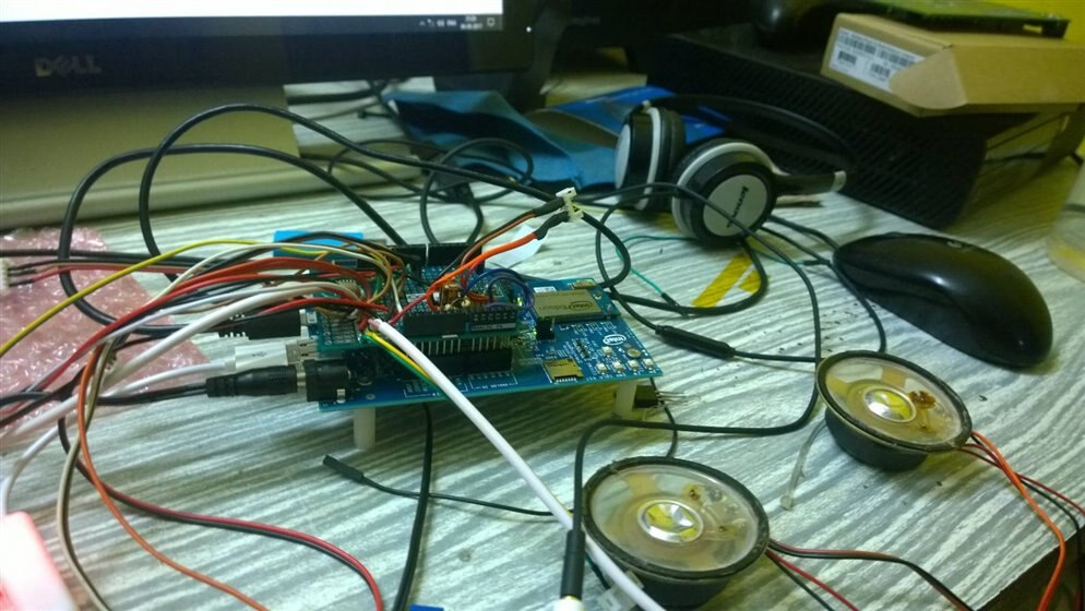

The Setup.
Its simple,just plugged in the Microphone into the USB sound card. Looks lil clumsy, have soldered plenty of wires over there.
But I've used a separator cable, since the Headset I'm using is  4-pole jacked (Mic and Speaker comes in same pin)

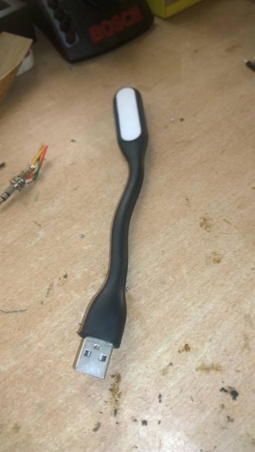

I found this guy around , checked it...was broken but the leds were working thought of using it as a notification light when recording happens in speech recognition mode

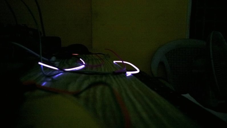

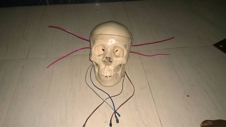

The EL sequencer came in....thanks to Workshopshed for suggesting them..
tried playing with them for some time(Sorry couldn't capture a video) , also fitted the EL wire to the skull.

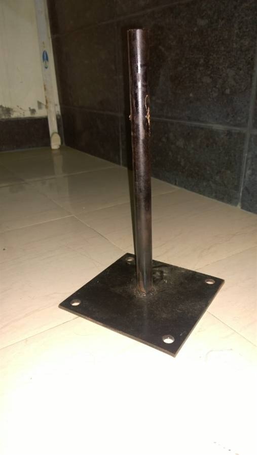

Got some old Mild Steel pieces from scraps, some welding and tada we got a support for the Skull image
