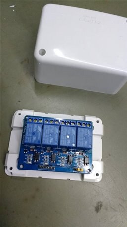

Details of electrical connections for the grow light and water pump
The relays that switch the light and the water pump were enclosed inside a junction box so there are no exposed wires and terminals for this part of the circuit.
The control cables came through the bottom of the box, just next to the Edison Board. The relay block has 4 relays but at this stage, I am using only 2.
The other 2 I will have as spare as I have plans to install an air blower to force air into the drum if it gets too hot or too humid and an air pump to aerate the nutrient.
