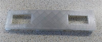

A curved section was printed to support the lighting components. Although curved this was printed curved side down with supports so that I did not need to create a complex scaffold to do the cutouts for the lights. This printed without issue and I cleaned off the supports.

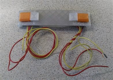

A lamp housing was created for the headlights. Which was a simple box with a concentric rings on the front. This was put together with the previously printed indicators and the above plate.
These were tested by simply hooking up the supply.
A block was added to the bottom so that this section could be bolted to the bumpers.

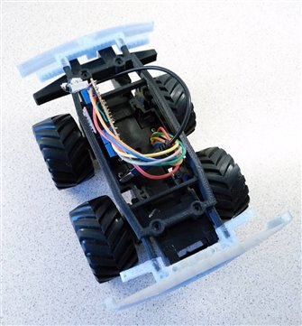

The bumpers went through a few changes since last week. To produce the best flex in the bumper the pivot point was moved right to the middle and the design was adjusted accordingly. Some mounting holes were added so that this could be bolted to the bumpers.
Chassis
The chassis has been slimmed down as previously mentioned and the mounting points for the bumpers were spread apart so that they cleared the existing frame. The chassis was printed with the black ABS from Refil (ex car dashboards) and it printed without problem. I did drill out the mounting holes to 3.5mm as I suspected that my printed sizes were a little small.

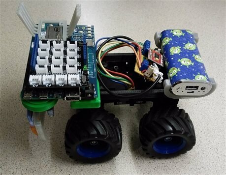

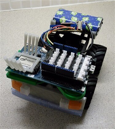

When I came to assemble the printed parts there were a few issues. The first was that the new lights and bumper clashed with the existing frame. A hacksaw quickly solved that problem and the frame was shortened. I also dug into my bag of reclaimed screws and bolts and found 4 that would fit the chassis nicely. I also found that the lights and bumpers were higher than I wanted so I chopped up the back bumper and glued it to the top of the front lights to allow those to hang below. This meant that the front assembly hangs a long way from it's supports. So I'll need to add an additional brace at the bottom, there's a handy screw point that I'll likely attach that to. With a three point mounting the lights and bumper are solid. I'll likely incorporate these changes into the models so that the back bumper/lights are simpler to assemble.
As you can see the battery pack and Edison balance each other out and since I've taken these photos I've moved the batteries further back to give my driver more space.

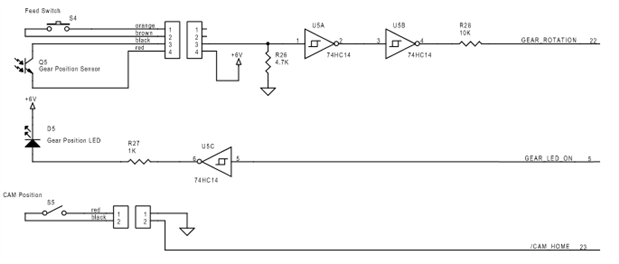

I've been preparing the driver which my daughter has nicknamed Freddie. The second Edison has been flashed, connected up to the network and configured for SSH.
As mentioned in the previous discussion the Edison breakout board runs at 1.8v volts. The 74HC14 Schmitt triggers that are used on the driving the LED and monitoring of the position sensor can run down to 2v so to interface these to the Furby something is needed. Referring to Harry Fairhead's book on the Edison Exploring Edison - Life At 1.8V the approach of using a simple transistor to boost or lower the voltage seems the best option.
