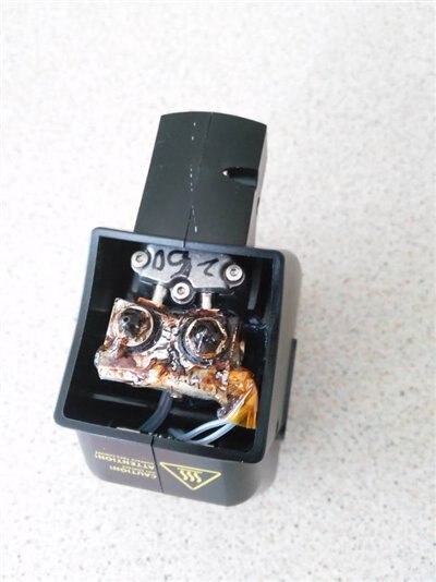

So this was supposed to be a joyful post about how I'd printed the redesigned backlight bracket and a base for the Furby to hold the Edison and other parts.

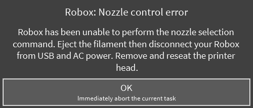

However, before printing, I got a warning message on the printer and the printer refused to print. When I took the head off I realised why as there was a load of blue PET behind the print head.
Despite various attempts to remove the plastic from using the purge cycle to heat the head and tweezers to using a soldering iron to carve through the plastic, I could not remove it. I fact I think I've made the problem worse and narrowly avoided setting the smoke alarm off.
I don't think there will be any more prints this week and I'll likely need to save up for a new head.

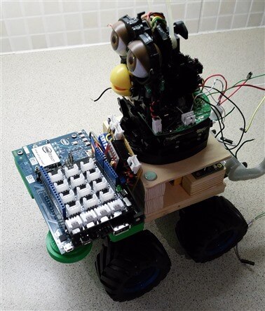

Updated - Wood and glue save the day
Dolls house offcuts
When I assembled a dolls house kit the other year, I kept all of the 3mm ply that formed the frame where the parts were pushed out. None of the parts were particularly large but I thought they might come in handy for models and the like.
So I cut some squares and some blocks and glued up some piles to support the Edison, it's not elegant and is taller than I wanted but will do the job till I can print a replacement for the platform I was going to make.

    dougw over 9 years ago +3
    I once had some kind of blown seal in my Robox head and filament was coming out in places it shouldn't. It was not obvious what was happening because by the time I realized something was wrong, there was…
  • jasonwier92
    jasonwier92 over 9 years ago +3
    Way to work plan B and get it done. I like saving scraps from a project. Never know when you have to do plan B, but the perfect material was in the landfill.

    bwelsby over 9 years ago in reply to Workshopshed
    Ok no problem, the offer is there.
    FYI I like wood image  before 3DP I used to use base wood sheet and balsa wood which is so easy to shape and then polyurethane varnish to provide surface strength.
    Brian
  • Workshopshed
    Workshopshed over 9 years ago in reply to bwelsby
    Cheers Brian. Wood will suffice for this week.
    Really sorry to hear about the print head, it does look like a complicated (expensive) component. Glad to see the engineer in you come up with a backup plan!
    If you are desperate to have something 3D printed then PM me the STL files and I will see what I can do.

  • Workshopshed
    Have put a ticket in with CEL, let's see if they can fix it for less than a new one. Definately beyond warranty which was 100 days or 100 printer hours both which have been exceeded. Also my bodged repair would not held with a warranty claim.
