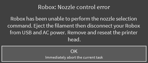

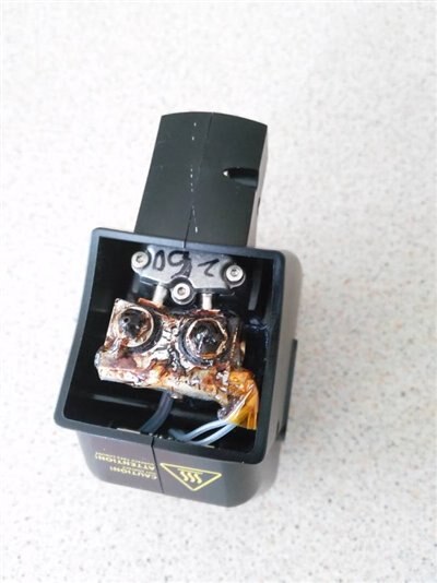

However, before printing, I got a warning message on the printer and the printer refused to print. When I took the head off I realised why as there was a load of blue PET behind the print head.
Despite various attempts to remove the plastic from using the purge cycle to heat the head and tweezers to using a soldering iron to carve through the plastic, I could not remove it. I fact I think I've made the problem worse and narrowly avoided setting the smoke alarm off.
I don't think there will be any more prints this week and I'll likely need to save up for a new head.

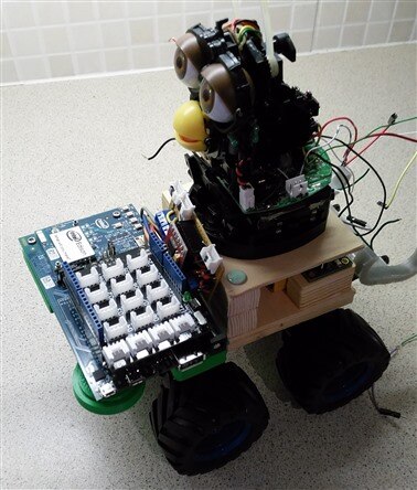

Updated - Wood and glue save the day
Dolls house offcuts
When I assembled a dolls house kit the other year, I kept all of the 3mm ply that formed the frame where the parts were pushed out. None of the parts were particularly large but I thought they might come in handy for models and the like.
So I cut some squares and some blocks and glued up some piles to support the Edison, it's not elegant and is taller than I wanted but will do the job till I can print a replacement for the platform I was going to make.

    dougw over 9 years ago +3
    I once had some kind of blown seal in my Robox head and filament was coming out in places it shouldn't. It was not obvious what was happening because by the time I realized something was wrong, there was…
