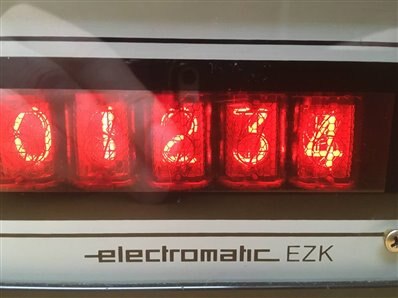

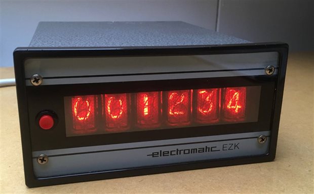

Look what I recently found on my attic. A nice box with a six digit nixie display. Even some documentation was in the box, showing that this is a 'Impulszähler EZK' from 'electromatic'. I can't remember how it found the way to my home. It might be that I bought it long ago on a flee market, or maybe I got it from a friend.

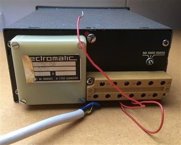

First I connected the device to the mains power and lucky me, it worked out of the box. The documentation showed me how to add some wires on the back in order to count  the pulses.

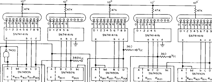

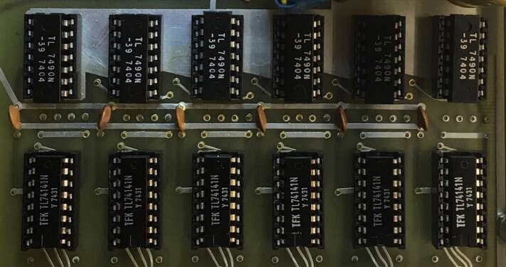

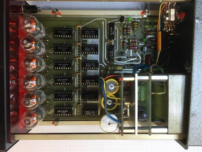

Next I opened it and again I concluded that I'm lucky since it looks like very easy to modify. The circuit is very straightforward, the very well known SN74141 nixie tube driver is used, driven by SN7490 BCD counters, as can be seen on the photo and circuit diagram below.
Another good thing is that these IC's are not soldered to the PCB, but placed in sockets instead. So I easily can remove the 7490 IC's and replace them with a connection to the  IntelRegistered Edison.
In total 6 digits, times 4 BCD inputs so 24 digital GPIO outputs are needed, 4 more than provided with the IntelRegistered Edison Kit for Arduino with its 20 IO pins. Furthermore connecting all those wires between the kit and the 7490 sockets is quite a challenge.
A better option is using  IO expanders, such as the PCF8574 (PCF8574N - TEXAS INSTRUMENTS - I/O Expander, 8bit, 100 kHz, I2C, 2.5 V, 6 V, DIP | Farnell element14 ) from which we need three since these are 8 bit, or a 24 bit alternative (TCA6424ARGJR - TEXAS INSTRUMENTS - I/O Expander, 24bit, 400 kHz, I2C, SMBus, 1.65 V, 5.5 V, UQFN | Farnell element14 ), in which we need just one.
The plan is to make a small PCB which connects to the 7490 sockets. On the PCB I will put an IO expander which connects via I2C to the IntelRegistered Edison Kit for Arduino.

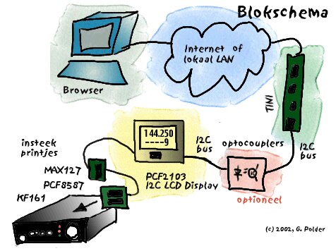

I did a similar project long ago when I replaced a rom for a frequency synthesiser from a Mobile Radio in order to modify it for Ham Radio. Control by then was from the internet using a Tiny Internet Interface (TINI) (Agri Vision - WEB enabled KF161 ).
