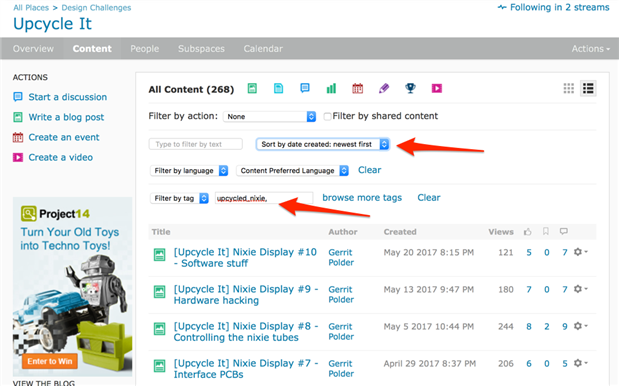

Next we need a web link to retrieve the information from. This web page is of course the content page  from the Upcycle_It challenge:
https://www.element14.com/community/community/design-challenges/upcycleit/content
All the 'Upcycle Nixie Display' blogs are tagged with upcycled_nixie so by selecting this tag we only will get the once we need here.
And finally we put the most recent blog on top, by selecting 'Sort by date created: Newest first'.
Now the url is copied from the address bar and put in the code:

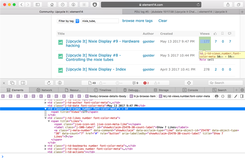

If all is well, we pass our data off to Cheerio. Then, we’ll be able to handle the data like we would any other web page, using standard jQuery syntax. To find the data we want, we’ll have to build a selector that grabs the element(s) we’re interested in from the page. If you navigate to the URL I’ve used for this example in your browser and start exploring the page with developer tools, you’ll  see the folowing:
Notice that the number of views are selected with td.j-td-views, while the  likes are selected with td.j-td-likes. We will get a whole list of those, one for each blog post. Therefore we select only the first one (children().first()), which is the most recent blog in this case. The likes selector returns a string and a number, in this case: "Show 7 likes7" from which the first number is selected by splitting the string and taking the second element (.split(' ')[1]).

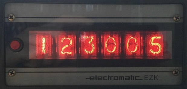

As proof of the pudding here is an image of the display showing the view count (123) and 5 likes for [Upcycle It] Nixie Display #10 - Software stuff at the time of this writing (Fri May 26 15:12:27 CEST 2017).
Works like a charm image. For displaying other information such as the internet speed, the position of the ISS space station from space.com, or whatever you want, the software can be adapted accordingly.
