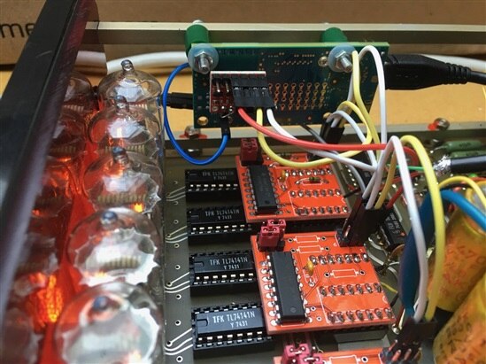

Controlling the IO expanders
In blog post [Upcycle It] Nixie Display #8 - Controlling the nixie tubes I explained how the PCF8574APCF8574A  IO expanders are controlled using Johnny-Five. In the final setup there are three such controllers, each with there own I2C address, set by the jumpers on the board. They are defined as follows:
var virtual1 = new five.Board.Virtual(
        new five.Expander({
            controller: "PCF8574A",
            address: 0x3A
    var virtual2 = new five.Board.Virtual(
        new five.Expander({
            address: 0x39
    var virtual3 = new five.Board.Virtual(
        new five.Expander({
            address: 0x38
Each controller consists of 8 outputs (inputs doesn't make sense in this application). The easiest single output pin in Johnny-Five is a led:
var extender1 = new five.Leds(
        Array.from({ length: 8 }, function (_, i) {
            return new five.Led({ pin: i, board: virtual1 });
    var extender2 = new five.Leds(
            return new five.Led({ pin: i, board: virtual2 });
    var extender3 = new five.Leds(
            return new five.Led({ pin: i, board: virtual3 });
Each IO extender is connected to two nixie tubes. The function nixie_disp(number, extender) will display the two digit number: number on the extender: extender. The function first converts the number to BCD and subsequently toggles the individual bits on or off.

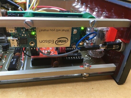

Reading the button
In my previous post I explained how I prepared the button input, but it wasn't wired by then. In order to be complete here are the pictures of the wired button:
To read the button status  again Johnny-Five is used and as can be seen in the API documentation there are three button functions, that is 'hold', 'press' and 'release' (JavaScript Robotics: Button API (Johnny-Five)). This is a real nice feature, as we can diferentiate between different actions by holding or pressing  the button. I decided to use it this way:
  • Each function has its own number, which can be displayed or changed with the button:
    • 0 - show time
    • 1 - show date
    • 2 - show temperature
    • etc.
  • When the button briefly is pressed, the function number will be displayed for one second.
  • When the button is held for more than one second, the current function will be increased by one or set to 0 when the highest function is reached. This way we rotate over the different functions.
  • After the button is released, the function number will be displayed for one second, and subsequently the new function data will be displayed.
Here is how the button is defined using the Johnny-Five button class:
  var button = new five.Button({
        pin: 0, // is GPIO182 on Intel Edison mini breakout board
        invert: true,
        holdtime: 1000
The holdtime is the time in milliseconds that the button must be held until emitting a "hold" event, one second in this case.

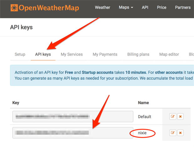

Now time and date works, the next thing in the plan was to display weather information. This informations retrieved from the OpenWeatherMap service on the internet. There is a nice and simple to use API for Node.js available:  https://www.npmjs.com/package/openweather-apis. It can be installed with npm:
root@edison_nixie:~# npm install openweather-apis
openweather-apis@3.3.2 node_modules/openweather-apis
Before using OpenWeatherMap you need to make an account in order to get a key which is needed to obtain weather data. (https://home.openweathermap.org/users/sign_up)
