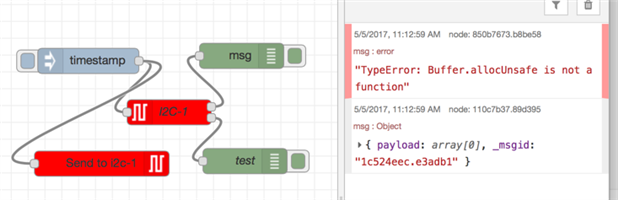

I2C on Node-RED
First library I found and tried was https://flows.nodered.org/node/node-red-contrib-i2c. Although only the Raspery Pi is mentioned in the documentation I expected it to work on the Edison as wel. Unfortunately it didn't, not because of the hardware difference, but because this library needs a newer Node.js version than the one which is installed on the Edison. I couldn't upgrade Node.js using the package manager. I also learned from the other challengers that they all have the same version as I do (Which Node.js version are you running on the Edison?). I decided not to try to update it from source, because according to what I found on the internet that will take at least five hours.
Here is an image of the flow. As you can see the scan bus (I2C-1) doesn't give any result and the send to i2c gives an "TypeError: Buffer.allocUnsafe is not a function" which according to what I found on the internet is related to an outdated Node.js version.

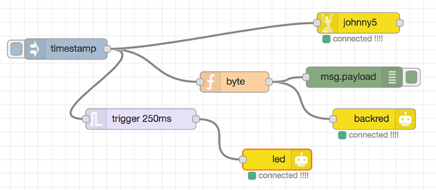

Next one I tried was https://flows.nodered.org/node/node-red-contrib-gpio.  A set of input and output nodes for controlling General Purpose Input and Outputs (GPIOs) though the use of johnny-five I/O Plugins as well as running johnny-five scripts! Here is where Johnny-Five comes in. jasonwier92 already mentioned it (Getting To Know the Sensors with Node-Red [Upcycle It #3] ) briefly. Here is a picture of what I tested:
As you can see all GPIO nodes (the yellow ones) are properly connected  to Johnny Five as indicated by 'connected!!!!'. The 'led' node for which a grove led block connected to D2 was used, nicely gave a 250ms flash, so works well. But the other nodes didn't. The 'backred' node should set the background color of the lcd display to red using I2C, but unfortunately nothing happend. The 'johnny5' node contains the following code:
var lcd = new five.LCD({
    controller: "JHD1313M1", board: board
lcd.useChar("heart");
lcd.cursor(0, 0).print("I :heart: Johnny-Five");
Also, nothing happend on the display.

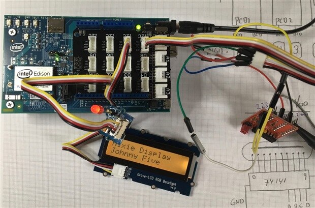

As I'm somewhat careful with the Nixie counter, wouldn't like to fry it before the end of the challenge. (also not afterwards image), I first tried the interface board loose on my desk. Here is a picture of the setup:
I glued a small test program together:

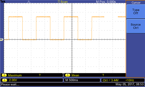

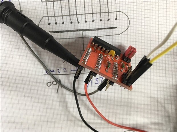

The program puts all 8 expander outputs in an array called leds, which altogether blink in an interval of 500 ms.
A scope connected to one of the PCF8574ANPCF8574AN outputs shows the signal:
Conclusion; worked like a charm! image

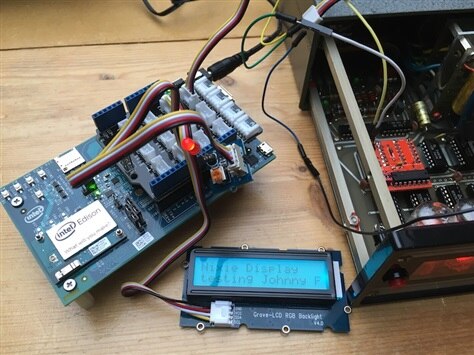

Controlling the nixie tubes
As all looks well, it is time for the next step. So the interface board is inserted in the counter, the I2C signals (SDA, SCL) as wel as the ground are connected to the Grove interface board. This way the EdisonEdison and interface are powered from the Edison Arduino boardEdison Arduino board, the PCF8574ANPCF8574AN IO expander is powered from the nixie counter.
The software is modified such that the individual outputs of the expander can be set.
Here is the function which is responsible for that:

As you can see this works like a charm:
This concludes the blog of this week. I'm very happy that despite the struggling earlier this week I finally was able to easily control the nixie tubes. Regarding the hardware my plan is to switch to the other Edison with mini breakout boardmini breakout board. This board will be mounted inside the display case. Also two more interface boards still needs to be build.
