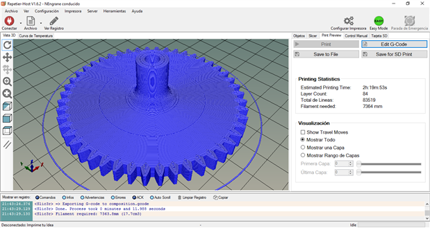

After several days of working on the gears and mounting the stepper motor, they are finally coompleted and ready to be controlled by the Edison board
Gear in Repetier before slicer
Gear in Repetier after slicer
3D Printing Gear 1
3D Printing Gear 2
Printed gears and stepper motor mounted in the telescope mount

    Nice gears. It might be worth making the smaller gear a little fatter to allow for slight misalignment and to give it a bit more strength. My printer is not the most commonly used tool in the shop but…

    I agree, the thin gears may work now, but once you add the weight of the tube and camera, you might find that the stress is too much.
