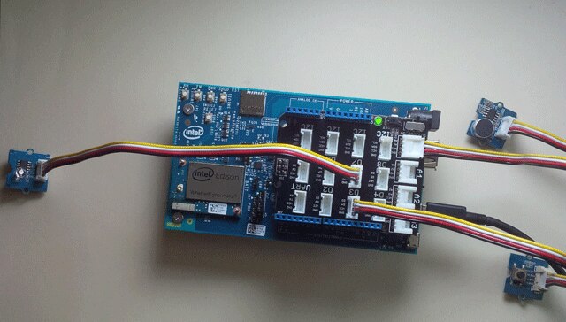

Edison meets Grove Starter Kit for Arduino
Grove Starter Kit for Arduino includes audio sensor. It took just a couple of minutes to connect parts. Then I've tested it with Spectrum Analyzer. I've followed the instruction and it worked very well right away. I as well added a LED as indicator and a switch button. I'm planning to use it latter for automatic calibration to reduce number of false positives as different smoke detectors may have different audio signature. The distance between smoke detector and microphone plays role as well.
Detector Interface Coding
I've used Libmraa to interface node.js program with the analog audio sensor. The same library has been used in the Spectrum Analyzer. This C/C++ library has as well bindings to Java and Python. The initial programming of the detector interface module was pretty straightforward as I used a tutorial from Seeed. But it took some time to manually adjust thresholds and other parameters. So I hoping to automate this process.

Summary
Now I have to programs - one central monitor, which can work with multiple detectors and detector interface. They communicate over MQTT

  • vlasov01
    vlasov01 over 8 years ago in reply to mcb1
    Thank you a lot for your input and feedback!
    As you can see on the picture I haven't used any filters other then in my code. I had the same idea that smoke alarm is very loud and can be easily picked up. But when I start testing I've realized that for the audio sensor my steps were as loud as the alarm coming from the detector. So I've used some aggregation over time to distinguish them.
