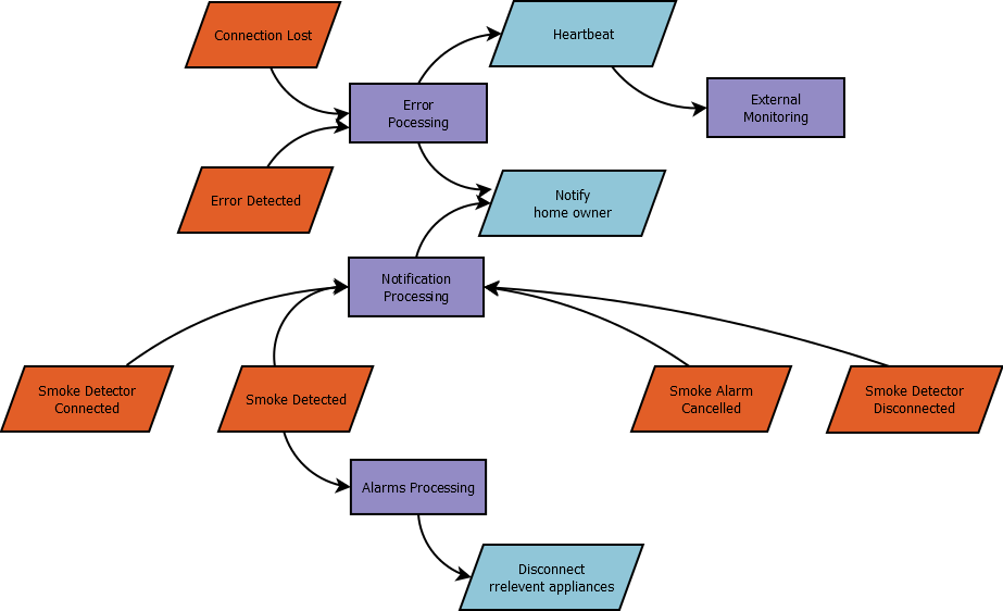

I decided to revisit the original design to address the first and the second question. At least I'll know when I'm at risk.
I've added two new error processing components. One is internal Error Processing deployed on Intel Edison. It's main responsibility is to communicate errors from other processing components and monitor detectors disconnects. In addition, it will establish a heartbeat communication with External Monitoring. In case internal Error Processing fails, the External Monitoring will detect loss of communication and will send alert ("deadman switch").

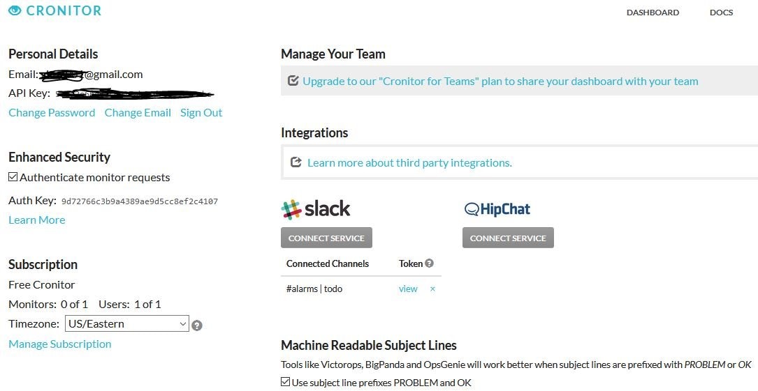

External Monitoring
On the role of External Monitoring I'm considering a Cronitor service. It has capability to detect disconnection, has integration with Slack. This integration with Slack channel requires only configuration changes.
Cronitor service has several options. I've chosen Free Cronitor option. This service is free for a single monitor, but can be extended if required.

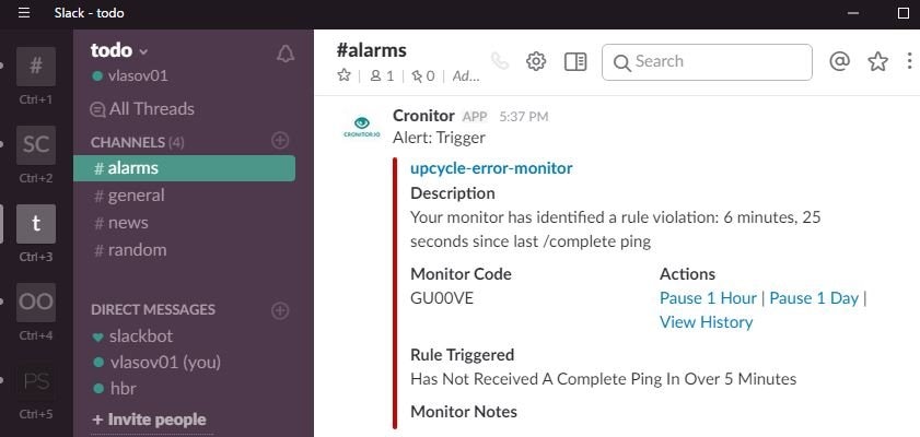

When the monitor goes done, then Cronitor communicates alert to Slack and sends another message when heartbeat recovers:
