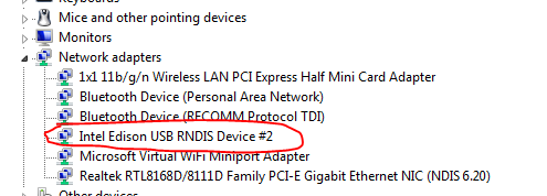

2. Intel Edison USB Driver: Basically to access Intel Edison via SSH, the required driver is Remote Network Driver Interface Spec (RNDIS) for Ethernet over USB but install all drivers as per Intel official link for download and installation guide of Intel Edison Drivers.

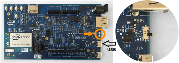

Once Driver are Installed on Host system and Intel Edison connected to Host system using middle micro USB port on Intel Edison shown in figure below, Host System detects Intel Edison  as RNDIS device and provide Ethernet over USB connection between Intel Edison and Host System with Intel Edison default IP as 192.168.2.15

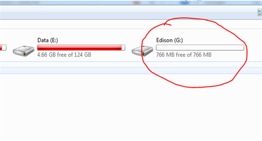

Also a Intel Edison is available to host system as "Edison" named mass storage drive.
(Note : If you are using USB for power Intel Edison than make sure SW1 is on micro USB connector side)
Fig: USB connection and SW1 position for accessing Intel Edison via SSH
Fig: Screen shot of Device manager window shows Intel Edison as  RNDIS
Fig Screen shot of Edison as mass storage drive

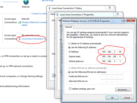

So next step is to configure your Host system IP with sub net 192.16.2.XX, In this setup I have configured my host system IP as 192.168.2.20
Fig: configure Host System IP address as 192.168.2.20

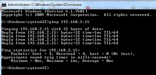

at this stage you can successfully ping to Intel Edison using cmd prompt as given below..
Fig Intel Edison responding to ping from Host System

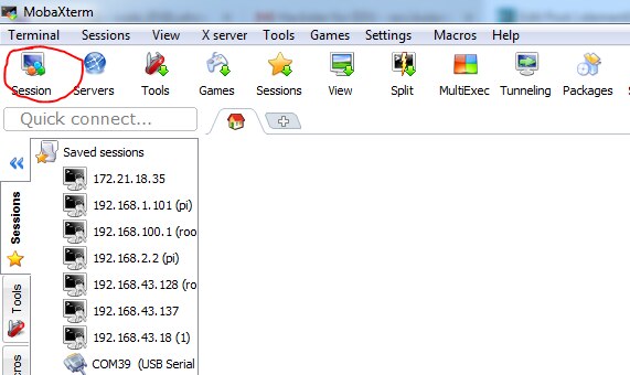

1. Run MobaXterm_Personal_8.6.exe and create new session

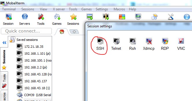

2. Select SSH session

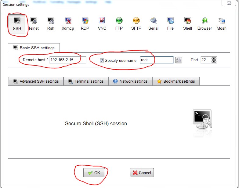

3. Add remote host IP as 192.168.2.15 (Intel Edison RNDIS IP) and select username as root and click OK.

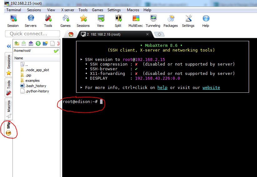

4. Great ... You are connected to Intel Edison using SSH..(Intel Edison do not have any default password as root )
also you have access to Intel Edison file system using sftp at this point so you can easily drag and drop files to/from your host system
Great... Now We are all set to explore more about Intel Edison using SSH..
