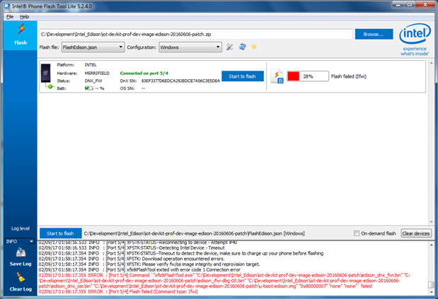

My last steps left me with a flashed image onto the Edison ... or so I thought.
When I plugged it into the home computer, it reported unable to detect the image.
Worse was the constant change as it detected, then dropped, detected, dropped (you get the idea) one port.
I was able to connect via PuTTy to the device and it was stuck in a constant reboot mode.
I was able to stop it Autobooting by pressing a key at the correct time.
Once I had the Autoboot stopped, the dropping also stopped.
This resulted in a limited environment which seemed to be an "Input Shell".
Typing 'help' gave me a bunch of instructions that I could use including 'reset' of the CPU.
About now I'm wondering if I hadn't shut it down, or that it hadn't completed something.
But I did recall it was happily sitting there, and all the power lights went out before I unplugged it, so I must have held the PWR button down for 10 secs.
I'm starting to question what I did wrong and if something in the installation was at fault.
The driver file is available, but the configuration tool seems to ignore these and do it's own thing.
I had added another driver at some point, and while the utility and driver install should have replaced it, I thought it was a good idea to start again.
I used the Uninstall software and removed the drivers that had been added recently.
The other program was also removed (it didn't seem to do anything) and then I fired up the configuration Utility (and confirmed the agreement AGAIN).
I made sure it was running in Administrator Mode, and let it install the drivers.
Reflash
My Laptop from earlier in the morning said the Edison had a new image, so in theory it should be fine.
BUT the utility reported it was unable to detect the image.
Once again it got stuck at the point of not detecting the board, unless I repowered or pressed the pwr button, and then the constant rebooting started.

Flash Lite had some success, it got to talk with the Edison but eventually it came up with a new message that it failed and you needed to flash it manually.

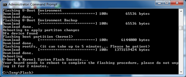

Manual Reflash
I talked about the manual reflash method earlier First Steps - Intel Edison step 3
Now that I knew I could force the reboot using PuTTy, I was more confident.
Unzip the file, add the two files and then use the command prompt to run Flashall.bat
I had a connection via PuTTy and between the power button and the Ctrl-C, I did manage to get it to talk.
So after a while it uploaded and rebooted and it PuTTy sesion came back with "edison login:" and sat patiently.
The full text is below in case someone wants to compare

Version
By now I've tried almost everything and I'm wondering if there is something I've missed.
You should be able to see the version number when you login with PuTTy and type "configure_edison --version"
But like earlier, it reports it's unable to.
The /media/storage folder is still a read-only, but it is 767MB in size.
Time to try it.
