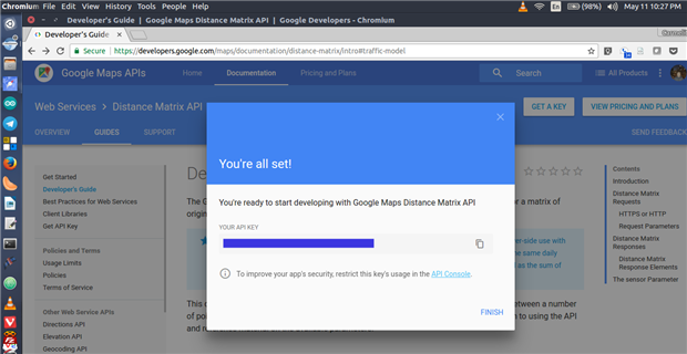

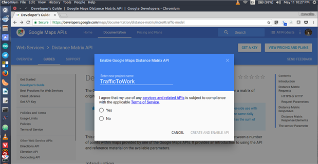

To get started go the documentation link below, and use Get A Key button to create
https://developers.google.com/maps/documentation/distance-matrix/start
  • an app
  • followed by generating the API key.

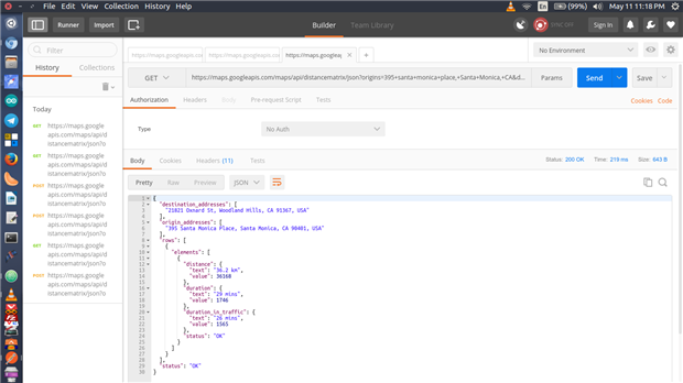

Now create the URL, and modify the origin and destination address to suite your needs. And you will also have to add in the API key. In addition, a suggestion here is to use a tool like Postman to check that your URL is well formed, and to check if you get a response from the Maps API which is basically a JSON.
https://maps.googleapis.com/maps/api/distancematrix/json?origins=395+santa+monica+place,+Santa+Monica,+CA&destinations=21821+Oxnard+St,+Woodland+Hills,+CA|&traffic_model=best_guess&key=YourAPIKey&departure_time=now

Create the App
Make a note of the API Key
Using Postman to test the URL, which returns a JSON

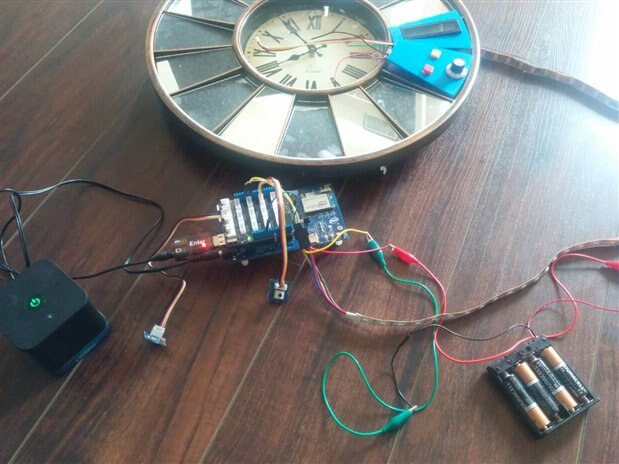

For the circuit as show in the picture below , I used
Grove button connected to D2 , which is used to trigger the Google Maps API
To power the LED strip , I am using 4x AA batteries
  • Data – pin #11
  • Clock – pin #13
For a running a basic test with the LED strip check out blog at - Upcycled Clock – Testing the RGB LED strip
And a portable speaker connected to USB sound card, which reads out the time to work.
Before you run the python program below you will also have to setup eSpeak ,  check out blog at - Upcycled Clock - Reading out the weather using eSpeak
Now Update the python program with you URL that you created and test above and upload and run the python program on your Intel Edison
