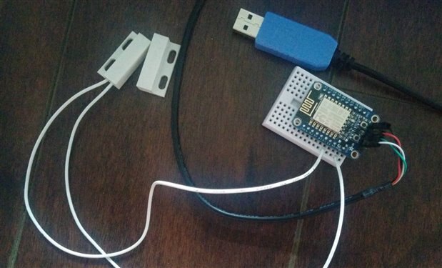

As part of the this blog post, the idea is to implement something that would allow the clock to detect the opening of my front door in the evening, when I get back home from work, which then reads out the temperature, weather condition and tweets. After looking into my components box, I found two thing that would help me achieve this, that is an ESP8266 board and Magnetic contact switch aka a door sensor. Basically as part of the setup, I am using MQTT to publish a message from the ESP8266 when the door is opened, which is then received by the Intel Edison attached at the back of the clock , which then reads out the weather condition and tweets via a speaker connected to a USB soundcard. Here is a quick video demo of the setup -

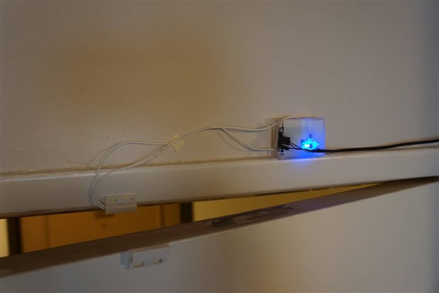

As part of the circuit, I have a Magnetic contact switch connected to pin#13, and I am also using the inbuilt LED on  pin#2 of the Adafuit's Huzzah ESP8266 breakout board, to light up when the door opens, this acts as an indicator for testing the setup.

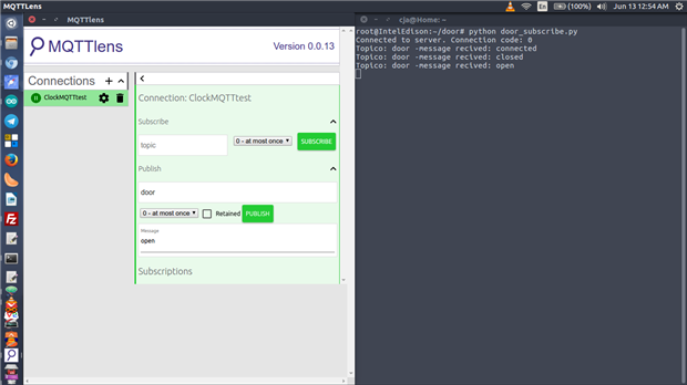

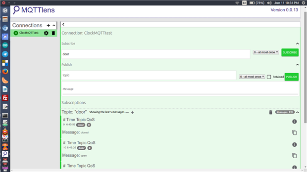

If you plan to run a test before the setting up the Intel Edison you can use chrome app called MQTT Lens which you can download using the chrome web-store. Basically, as you see in the screenshot below, I have subscribed to a topic called – door , which receives message every 30 seconds from the program above uploaded on the ESP8266.
But as part of the final setup, a message will be received by the Edison only when the door is opened.

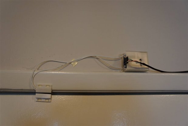

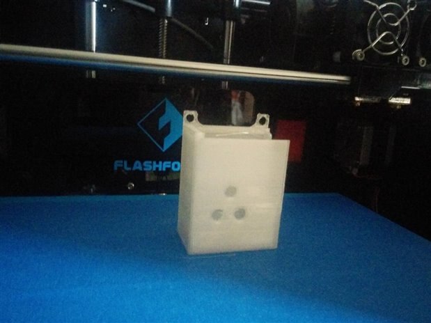

Now since the circuit needs to be mounted on door I 3D printed a case, which I can then nail just above the door as you see in the picture below.
{gallery} ESP8266
3D print an enclosure
ESP8266 - Door Closed
ESP8266 - Door Open

Once done, copy paste the python code below and run a quick test using MQTT lens to publish messages to the door topic
