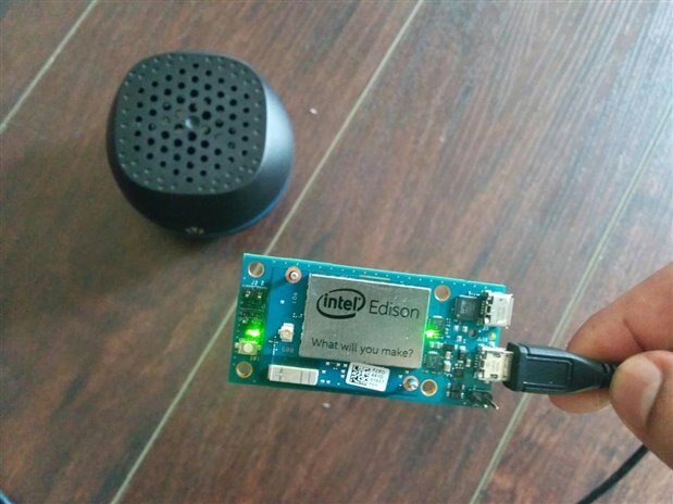

In my previous blog post, titled Reading out the weather using eSpeak , we installed eSpeak on the Intel Edison to read out the weather via a speaker connected to the USB sound card. Continuing on the same theme, and since I bought a new bluetooth speaker this weeks from my local electronic store for a 50% discount, we are going to enable bluetooth on Intel Edison and pair the new speaker. In addition, we are going to use tweepy, which is a python wrapper library for the twitter API to read tweets , and then use eSpeak to create a wav file, which is then read out by gstreamer.

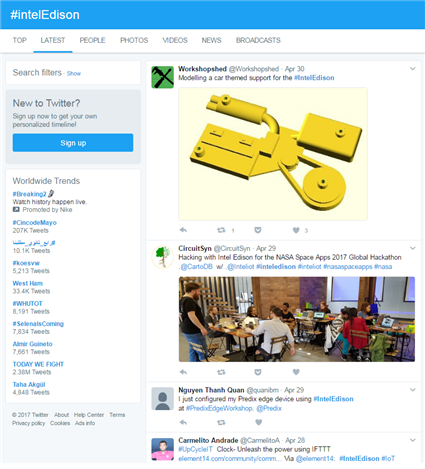

While putting the python code together and testing it out, I found out that Workshopshed (Andy Clark) is working on an interesting 3D part for his project - Interactive Racing Car Driver , hmm I wonder  if that is going to be a part of his next blog post.. Sorry Workshopshed , but the cat is out of the bag ! image ...Here are the list of tweets read out as part of the video above-
Here are commands to follow, to enable bluetooth on the Intel Edison and then pair and connect to the bluetooth speaker , the speaker I bought is the Vivitar portable bluetooth speaker.

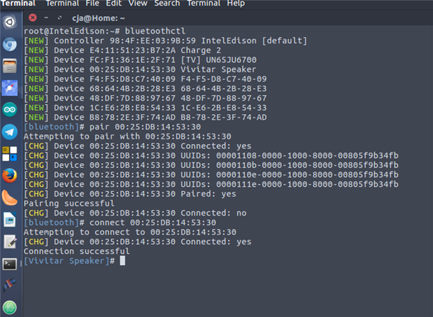

SSH into the Intel Edsion and run the following command as shown in the pictures below
rfkill unblock bluetooth
bluetoothctl
This puts the bluetooth on the Intel Edison in discoverable mode and then you can scan for bluetooth device using the command
scan on
Make a note of the mac address of your speaker( in my case it is [NEW] Device 00:25:DB:14:53:30 Vivitar Speaker) and pair it with the Edison, using
pair 00:25:DB:14:53:30
And to connect to the speaker, use the command
connect 00:25:DB:14:53:30
Then quit the bluetoothctl prompt using
quit

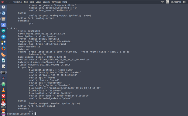

Now run the following command to verify that the speaker is recognized in pulse audio
pactl list sinks
Configure the default sink to use pulse audio server with the following command, replacing with the details of your device.
pactl set-default-sink bluez_sink.00_25_DB_14_53_30

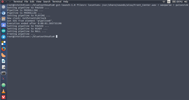

It is now finally! image time to play some sound on the bluetooth speaker using gStreamer
gst-launch-1.0 filesrc location= /usr/share/sounds/alsa/Front_Center.wav ! wavparse ! pulsesink
Note: we are able use the Front_Center.wav, because we installed ALSA-utils in previous blog post, but we don’t really need to install ALSA as we are using gStreamer to play the audio wav file.

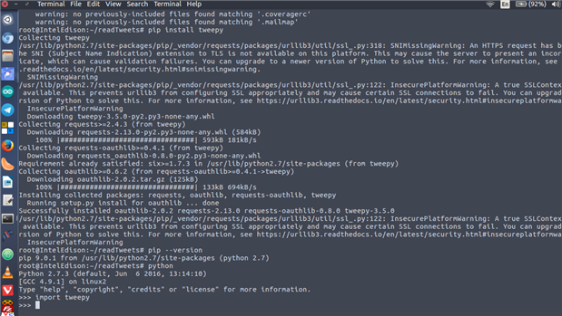

To read tweets, we will install tweepy which is python wrapper library for the twitter API, use the following command to install tweepy
pip install tweepy
Note: If you run into errors while installing tweepy this could be because  you have an older version  PIP installed, you need pip version 9/higher.To upgrade pip run the following command -
pip install --upgrade pip
