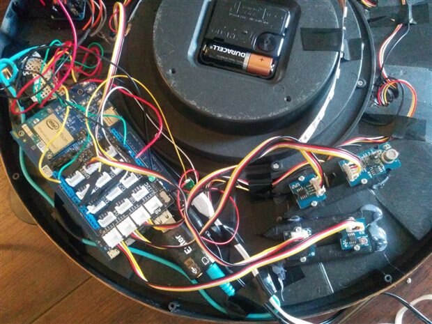

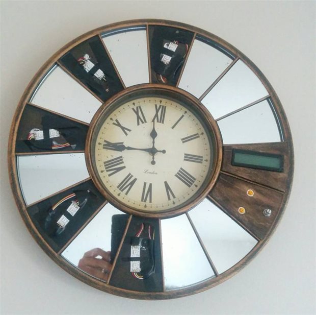

This weekend was all about mounting most of the electronic components to the back of the clock, and soldering the pieces of the LED strip together which will be used for diffusion for the panels as shown in the picture below, which were 3D printed in a previous blog post at - 3D Printing LED diffusers for the panels

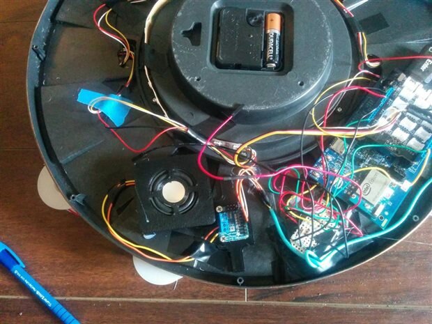

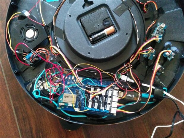

In addition, I have also 3D printed holders for the electronic components using black PLA , instead of hot gluing the electronics directly to  back, which mean I can reuse/replace the components in the future if I need to..
Here is a picture of all the electronic components mounted to the back of the clock,I know it is kind of messy! image, but here is the list of connection to the Intel Edison via the Grove connector shield
  • A0 – Potentiometer which is used to control features on the clock and display things like weather condition, Temperature extra.
  • D2 – Top button
  • D3 -  Bottom button
  • D5 – Grove buzzer sensor for sound notification
  • D11 - LED strip (APA102) Data
  • D13 – LED strip Clock
  • A1 – Grove Air quality sensor v1.3
  • A2 – Grove temperature sensor
  • A3 – Grove Light sensor
  • I2C connector on grove shield (A4, A5) - connected to the Grove RGB LCD display

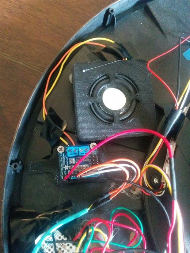

  • In addition, I am also using Adafruit’s Stereo 3.7W Class D Audio Amplifier - MAX98306 with a 4 ohms 3 watt speaker connected to the USB sound card, which you see on the left of the picture above. But I should have ideally gone with Adafruit Mono 2.5W Class D Audio Amplifier - PAM8302, since I am using only one speaker,which means I will have to order one later.
  • To power the Intel Edison I am using the power adapter that came in as part of the kit that is Triad Magnetic  WSX120-2000WSX120-2000 AC/DC Power Supply 1 Output 24 W 12 V,2 A
  • And power the LED strip I am currently using another power adapter 5V and 2.5 A.

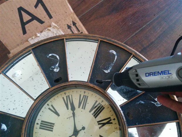

It was finally time! to pull out the Dremel and try and cut through panels. This was the part of the build that had me all worked up, basically I knew that I had to cut through a materials that was old, and it was not plastic, but is very close and extremely brittle. I started with the circular cutting bit on the Dremel and soon realized it was a bad idea. And then had to muster some courage to use the drill bit.

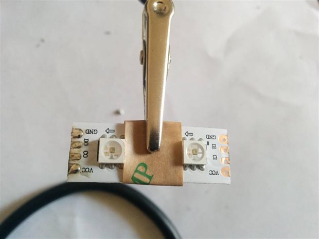

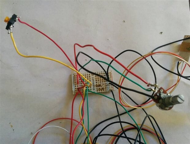

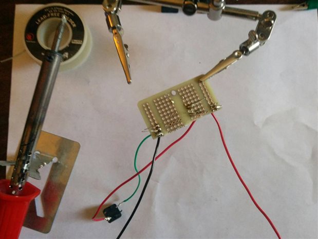

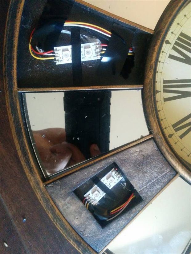

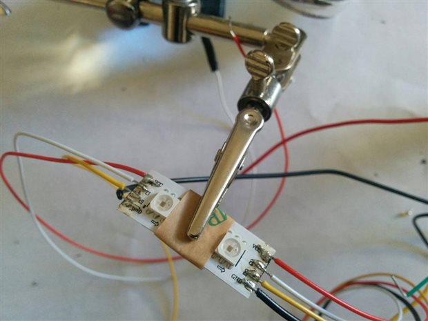

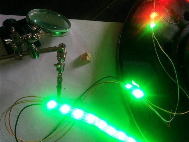

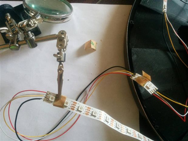

Once I had the drilling holes out of the way, the next part of the build was a test of my patience image , where I had to cut 5 pieces of the LED strip and then tin the ends and chain them together as shown in the picture below. In addition, since I am using 2 buttons and  a pot, I had to solder connections onto a Adafruit’s perma-proto PCB, and I also need a common ground for the LED strip.
{gallery} Soldering LED strip
Tinning the ends..
Soldering wire to the 2 LED piece
2 LED piece soldered to the remaning LED strip
taping and gluing the LED strips to the pannels
Running a test, and hoping all the soldering joints on the LED strip still hold image
soldering the buttons and pot to the prema-proto PCB, also using 2x10Kohms resistors for the buttons
Soldering the common ground from the LED strip to the prema-proto PCB

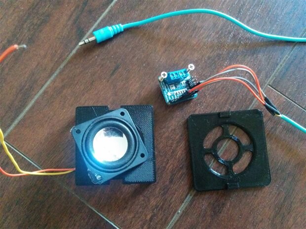

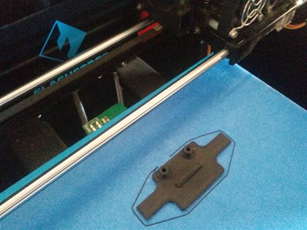

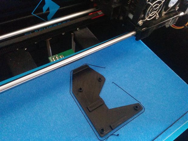

For sound, I used a Adafruit’s Stereo 3.7W Class D Audio Amplifier which was connected to the USB sound card. And for the speaker I am using a 4 ohms 3 watt speaker. I designed and 3D printed holders for both the amplifier and speaker as shown in the pictures below.In addition, I designed a base holder for the Intel Edison Arduino board, so that it would be easy to add to the clock.
{gallery} Adding Speaker
3D printed holder for the amplifier
3D printed speaker holder
Glue the 3D printed parts of the speaker and amp to the back
3D printed base for the Intel Edison Arduino board
screwing the 3D Printed part to the Intel Edison Arduino breakout board and gluing it to the back of the clock

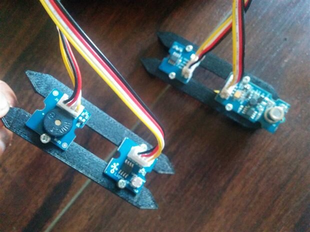

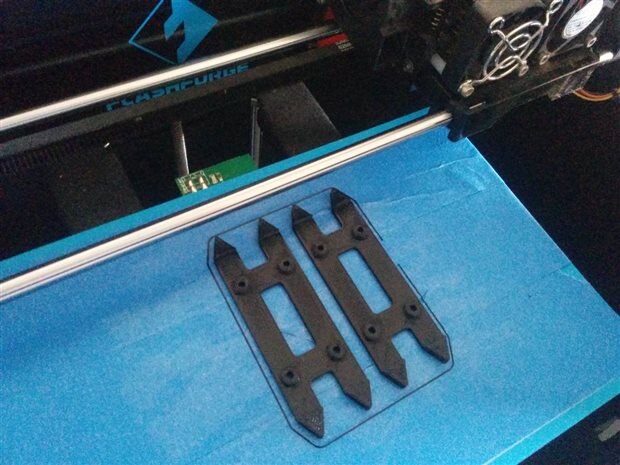

For the grove sensors (Temperature, Light , Air Quality  and buzzer), I designed and 3D printed holder.
{gallery} Adding the Grove sensor
3D printed parts to hold the sensor
Add the sensors to the 3D printed parts using screws
Hot Glue the 3D printed parts to the back

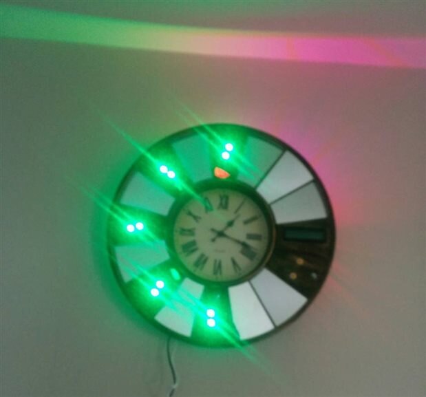

Finally, I mounted the clock on the wall and ran a test for the LED strip, here I wanted to check how the 20 LEDs strip on the back rim of the clock would glow onto the roof, which will act as a quick visual indicator in the morning before I head out to work..

    balearicdynamics over 9 years ago
    Great, really.
    I think you can find very cheap stereo amp kits; not a high power is needed and you can embed also the sound quality in the project.
    BTW, instead of the traditional large speakers I suggest you to use the mobile device form factor speakers (there are several at low price on Farnell site). They can provide good sound quality and are very small, ideal for this kind of projects.
    Enrico
  • Workshopshed
    Workshopshed over 9 years ago
    Great work. Unless the amp is causing a problem or was very expensive, I'd leave the stereo one in.
