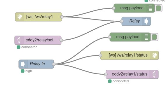

Okay, as I am testing, I am noticing that you cannot read the status of an output node. take the following examples:  this controls the relay just fine, sometimes it is a little touchy, but for the most part it works.  But then I monitor the same input triggered on rising and falling edges and I get no output.  I think it is because it is already setup as an output. With Node or Python, you can see what state the output pin is in and that is what I would like to do. I could do it with an output from the WS or MQTT message or the function and even store the state and on a new connection dump out all the values. Problem is when Node-red restarts the states are un-known. The one idea I had was to store this the state in a persistent data storage, like a database.  Only issue I see with that is it could get stale. Maybe I changed it via a command line.  I think it is best to ask the pin what state it is in.
To the ones running Node-Red for their project, what do you all think?

    Not sure if this helps. https://flows.nodered.org/node/node-red-contrib-influxdb Seems writing to a database might be the only way to keep it after a restart. Ran across this which outlines lots of uses…

    Perhaps an inject at startup node could trigger a function that reads the outputs via an external process?
