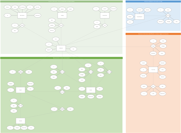

Database Requirements
The database should keep track of:
  • Measurements, sensors and boards that originated them.
  • Actuators commands history.
  • Multi-crop records comprising history, productivity, species and location (allotment).
  • Events generated automatically by the system or inserted by system operators (triggers).
Database Diagram
Figure 1 presents the database entity–relationship model. It defines allotments as areas in the vertical farm and deals with the different sensors configurations and measurements. Includes trigger relations for reporting and alarm purposes too.
Using this model we also pretend to build our knowledge base to connect to our artificial intelligence virtual observer to fine tune the actuator goal variables.
Figure 1. Database entity–relationship model. Right click on the image and select open in new tab/window to see in larger size.
Database Deployment and Connection
We designed the database with the help of MySQL Workbench and deployed it in a MySQL server.
To test the database, we coded software with Python, Node.js, Socket.IO and Google Chart API to try the insertion of sensor measures into the database and their graphic visualization in real time. The result can be seen on the video below.
We defined a Python node (left bottom on video) to generate random sensor measurements at 2 Hz and insert them into the MySQL database.
We used Node.js for the server-side application and Socket.IO to maintain a bidirectional connection between the client and the server. On the server side, a connection to the database is maintained and, at a rate of 2 Hz (not related to sensor output), we check for any updates on the measured values on a given sensor. We store the last records timestamp and query the database to efficiently retrieve the last updates (upper left on video). Finally we use HTML and JavaScript (+ Google Chart API) for the frontend webpage and, for each event on the Socket.IO instance on the client side, we change the data table of the chart, providing a real time visualization (right side on video).

    balearicdynamics over 11 years ago +1
    Very good !!! Finally someone else that uses proficiently the MySQL Workbench. It's a great tool, don't you think ? Enrico

    balearicdynamics over 11 years ago in reply to jmbranco76
    There is a part that I have not experimented yet with the Workbench; as when I have "discovered" this spectacular tool (working both on local and remote MySQL servers as well), I was already using many database for my sites and development. So I have never done the experience starting from the scheme up to the database elements and tables definition etc. But AFAIK it seems that you are using this to create a DB from scratch. That is just what I should do in these days for a new project.
    Enrico
