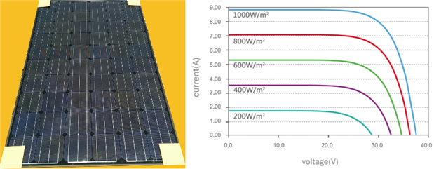

Our initial setup includes a 250 W solar panel from Schutten manufacturer with 60 cells and a maximum power point at around 30 V with a maximum open-circuit voltage of 38 V.
A lithium-ion battery of 10 Ah composed by 4 Thundersky cells in series to build about 13 V is used as well for energy storage.
Due to the solar panel characteristics, a power conversion device named MPPT (Maximum Power Point Tracking) is required to polarize the panel voltage in order to maximize its energy production. The solar panel and its current-voltage curves are shown on the next picture:
Figure 1. Solar panel and respective current-voltage curves.
If we would connect the solar power directly to the battery voltage we would get less than half of the available power. For instance, at the green curve (600 W/m2) we would get approximately 13Vx5.2A=67.6W while we could get a maximum power of approximately 27Vx5A=135W.

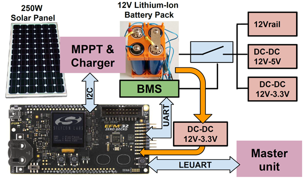

An overview of the implemented setup is shown on the next picture:
Figure 2. Power management schematic representation.

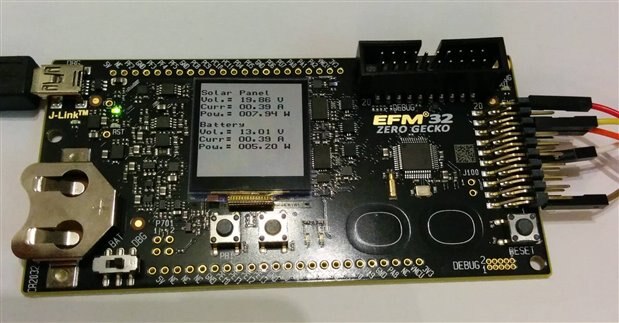

We use the Silicon Labs EFM32 Zero Gecko board to acquire voltage, current and power from the solar panel and the battery and to run the MPPT algorithm (Figure 3). It communicates via I2C with the INA226 on the solar power side and the INA 209 on the battery side. Booth ICs are from Texas Instruments. They are high precision bi-directional current/power monitor with I2CTm interface with high-side measurement (INA209) or high-or low-side measurement (INA226), using shunt resistors for sensing.
Figure 3. Silicon Labs EFM32 Zero Gecko board reading solar system and batteries variables.

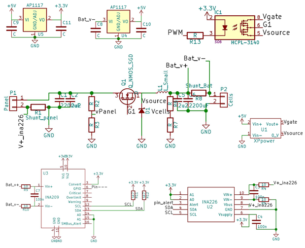

The complete circuit schematics is shown on the next picture:
Figure 4. MPPT circuit schematic.
A Battery Management System (BMS) is used to monitor individual cell voltages, estimate the battery State-of-Charge (SOC) and keep the battery pack cells balanced to avoid overcharge or overdischarge situations while maximizing the useful battery capacity and cycle time.
With this setup we are able to track the instantaneous power generated by the solar panel, the stored energy on the batteries and the total power consumption from the system (an important parameter to evaluate the performance of the system).

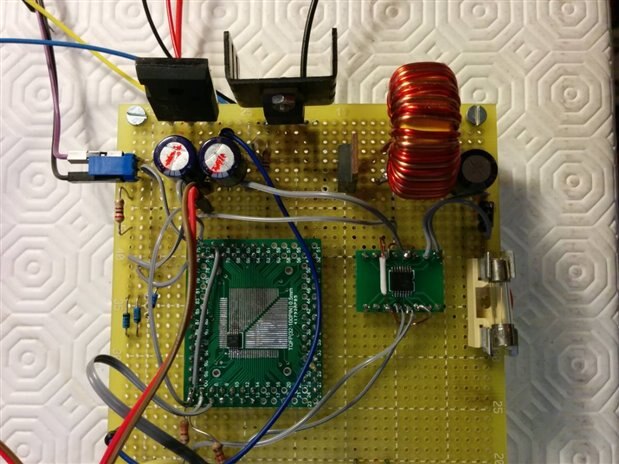

The MPPT prototype was built on a perfboard and is shown on the next image:
Figure 5. MPPT prototype.

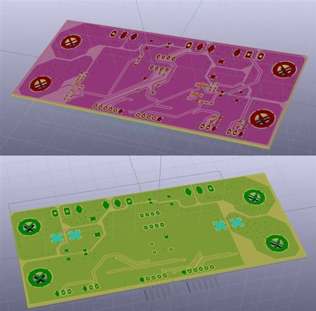

The final version of MPPT PCB was designed on KiCad and is being implemented. The next figure shows the PCB project.
Figure 7. MPPT final version project.

    Ooops sorry I saw in the schematics that you are actually getting 3.3V from 5V!

  • jmbranco76
    jmbranco76 over 11 years ago in reply to amgalbu
    Hi Ambrogio,
    indeed we use booth approaches. Inside the MPPT we generate the 5V for the XP Power DC converter (5V to 15V)  and we generate the 3.3V (for the monitor ICs) from the 5V. To improve the efficiency we will replace the 12V->5V linear regulator  to a switched regulator based on the TPS62112 IC from TI.
    For practical reasons we have also a separated 12->5V regulator for the RaspberryPi and we consider one or two 12->3.3V regulators to supply the Silicon Labs Boards.

  • amgalbu
    amgalbu over 11 years ago
    Ooops sorry
  • amgalbu
    Hi Josè
    Nice post and great job!
    Just a question: why you didn't get the 3.3 V from the 5V? wouldn't it have been more efficient?
