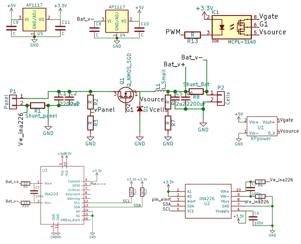

The complete circuit schematics is shown on the next picture:
Figure 4. MPPT circuit schematic.

    Ooops sorry I saw in the schematics that you are actually getting 3.3V from 5V!
