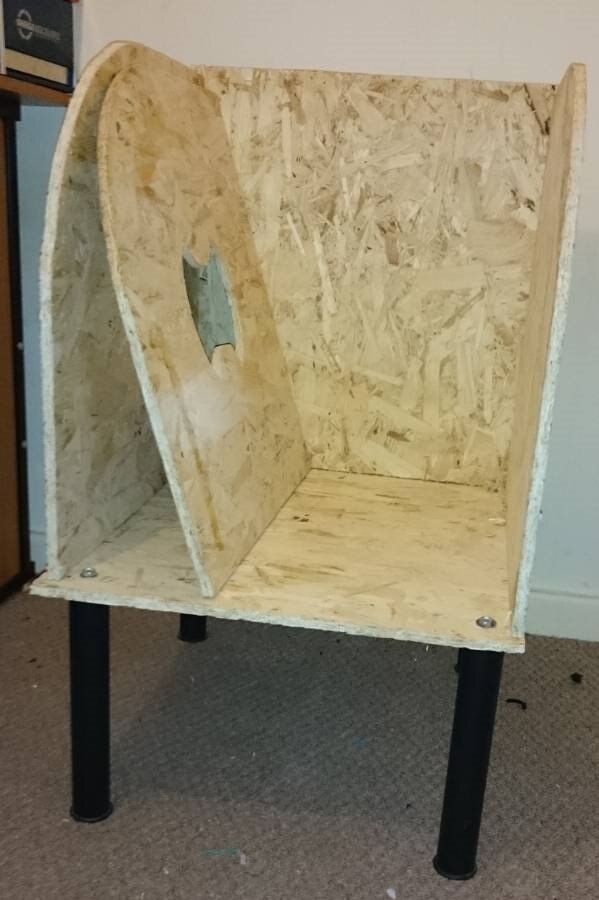

I have now started a dry run building the design so far i have
installed the PSU
installed the fans
1st coat of varnish on the wood

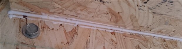

nailed and glued the sides and back
installed the legs
test fit the mounts for the dev boards

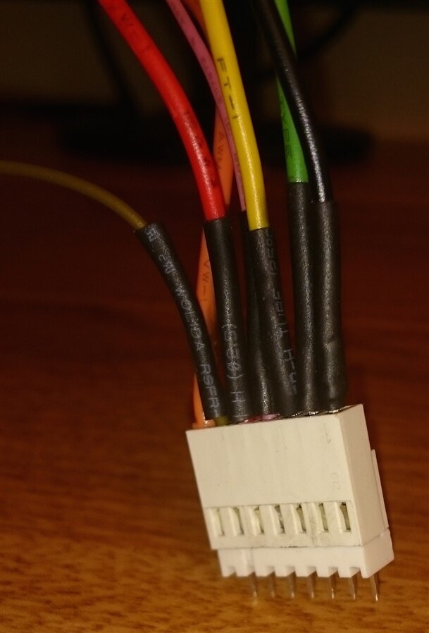

soldering and crimping wires and connectors
sizing up where the parts that have not arrived will go

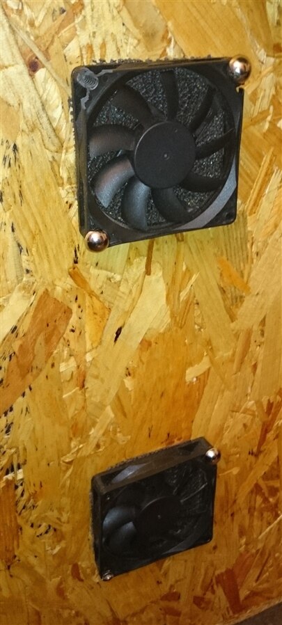

Fans
I went with 2 5v fans that were repurposed from an old laptop cooling stand
in front of the fans are 3 layers of mesh this is to stop insects from entering the unit and also to restrict air flow to a lower amount

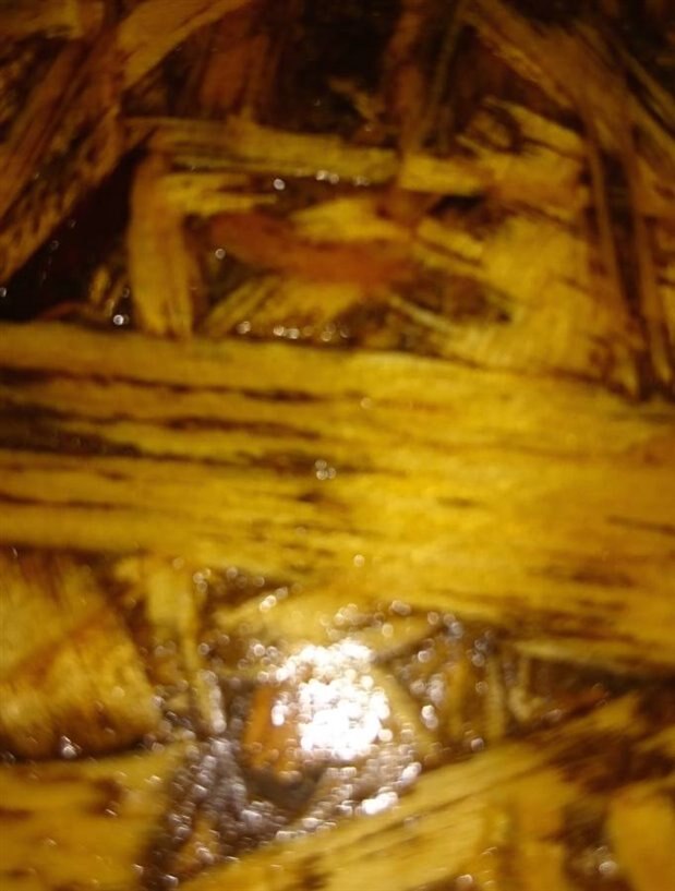

After a long discussion with myself i decided to go with a varnish on the unit instead of a paint to keep the look of the OSB
the top of the unit also has a stain on as well this was a test to see what looked the best and decided just to keep the top stained

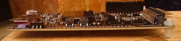

Board mount
i have used 3 pcb spacers to mount the board on a scrap piece of wood to test the idea and it worked out really well and this is how i will be mounting the board inside the unit

I have started to solder the connectors onto the cables ready for the boards to arrive that way i can solder them straight onto the boards and save some time as well

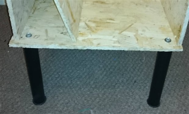

    The legs of the unit are from a bed frame they are bolted through the wood and are very sturdy basically they are now one with the unit They will withstand alot of weight approx 10 stone per leg so I'm…
    They will withstand alot of weight approx 10 stone per leg so I'm not worrying about the strength
    Reason for the size was firstly that's all I had and I wanted the unit off the ground and also I wasn't sure if my water tank would be inside or below so I accounted for both options and also it is now a similar size to a kitchen appliance so could even be used under the counter
